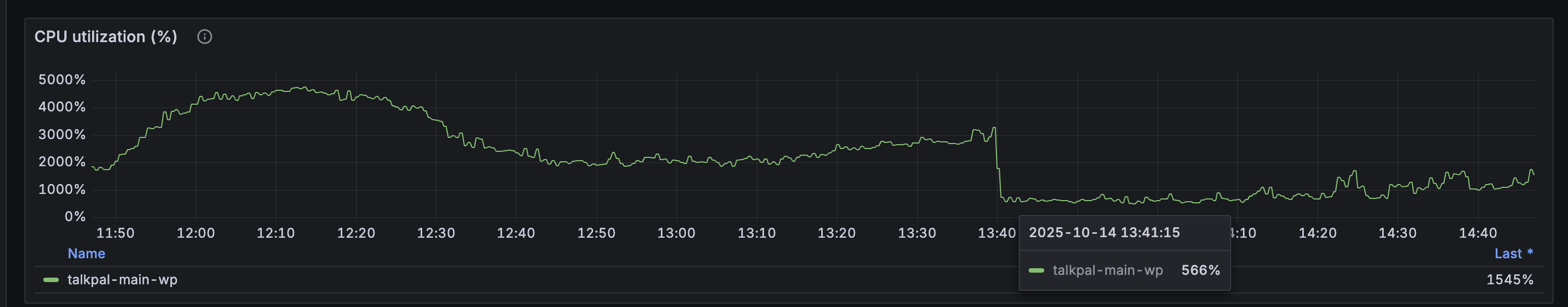

October 14, 2025 at 12:48 pm #17483936
akakiT
We just downgraded WPML 4.6 and it took our avg. CPU usage from 2500% to 500-600%. So the WPML seems to be the issue. Not sure what to do here.
October 14, 2025 at 12:55 pm #17484013
Dražen
I will share your reply with our team and ask to recheck again and see if anything we have missed or that might be related to with those crons and different WPML versions.
I will update when I have some news.
Drazen
