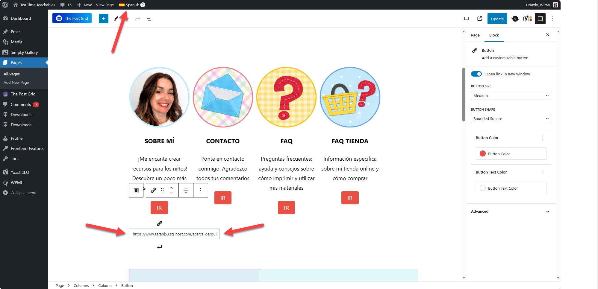

With your WPML Blog subscription, it seems there is no other option but to manually insert the new links on the editing screen in Spanish. Please see the attached screenshot.

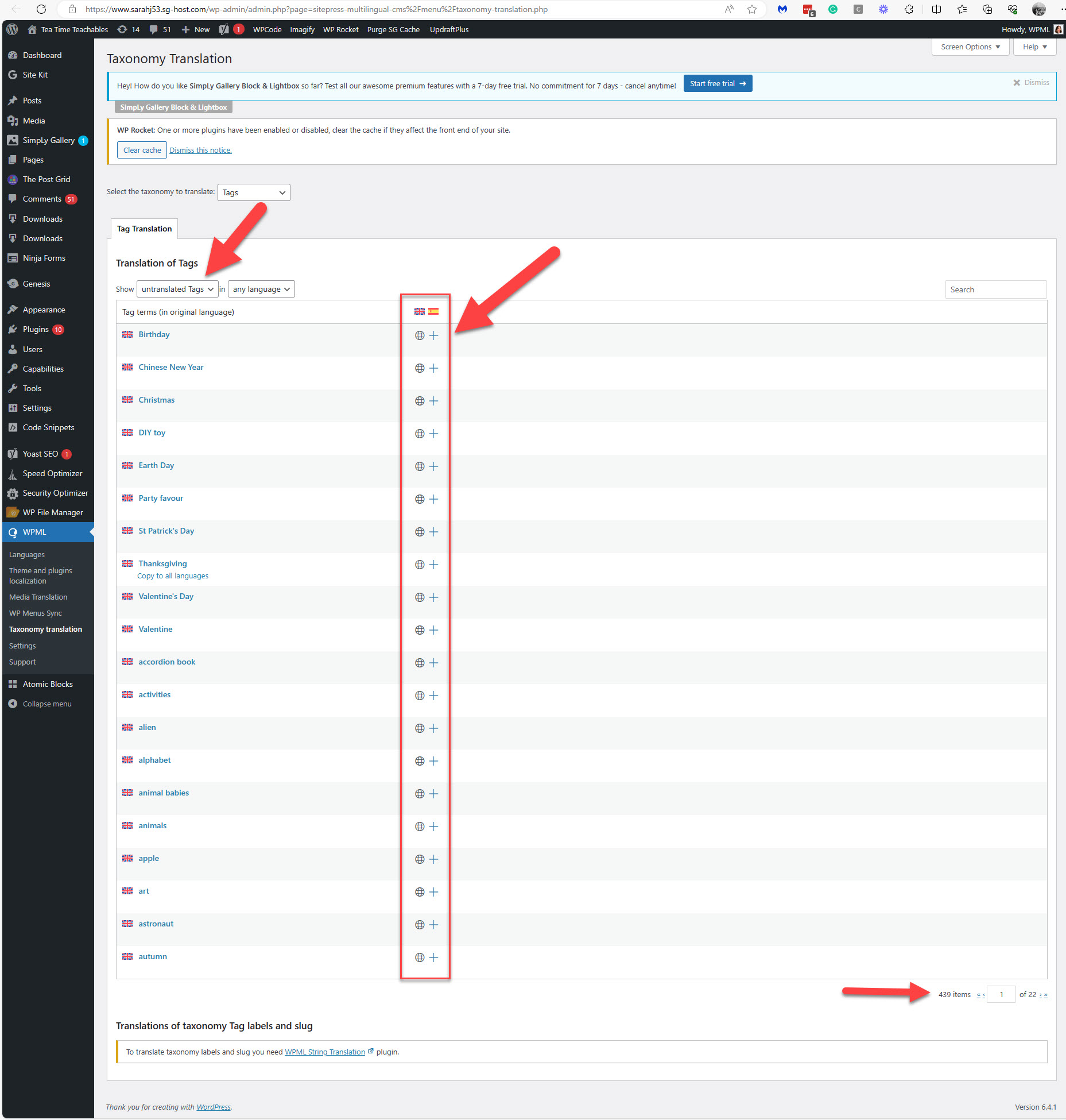

Are you sure this problem started after changing the Language URL format from "Language name added as a parameter" to "Different languages in directories"?
As far as I can see, most of your post tags are not translated. And I don't think that the change of the Language URL format caused them to be untranslated. I checked it in WPML -> Taxonomy Translation and selected "Tags". Please see the attached screenshot no-tag-translation.jpg.

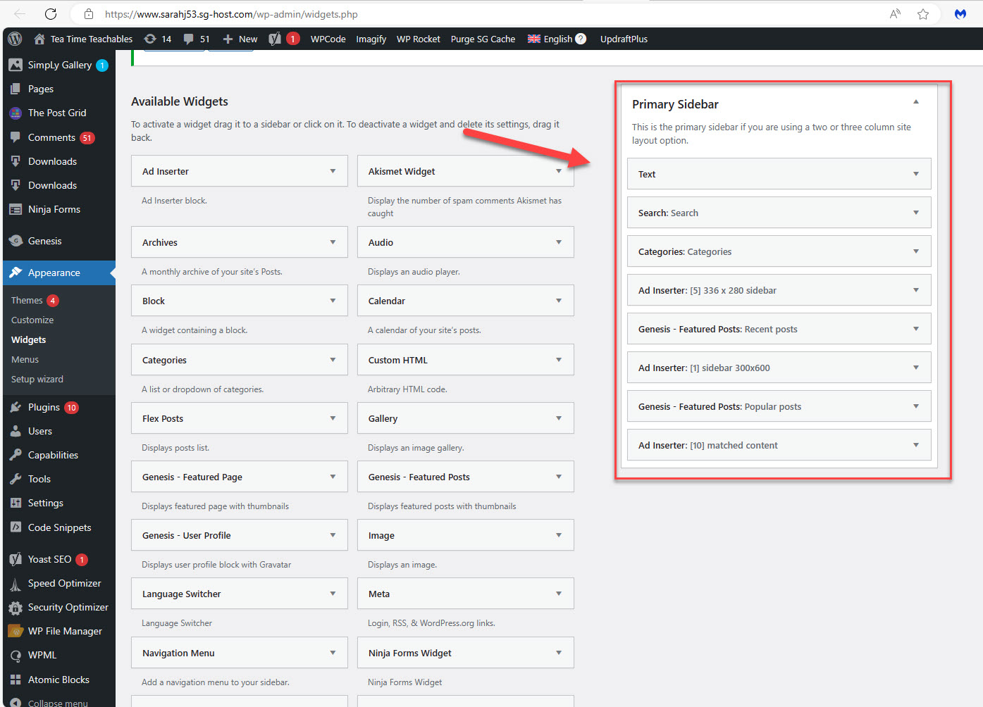

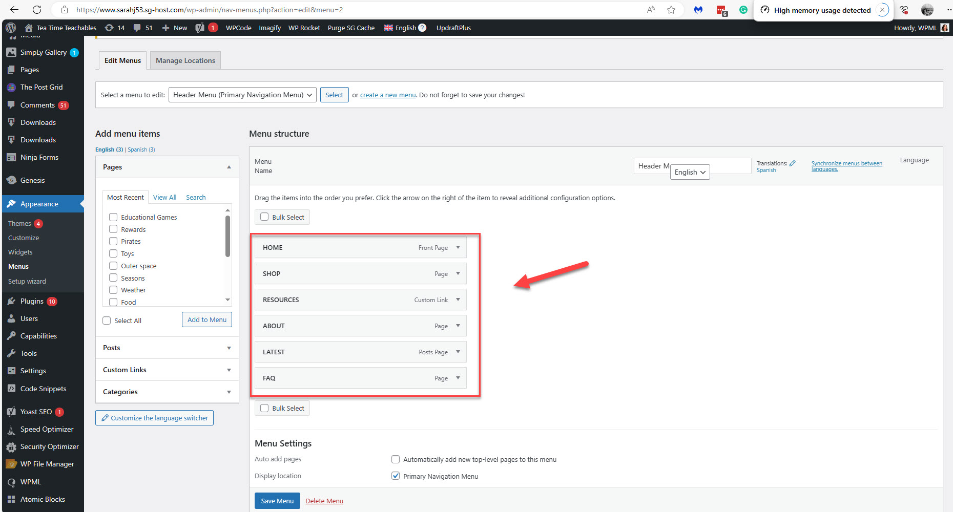

Maybe I'm missing something, but I want also to mention the following. As far as I can see, you don't display the post tags on the front end of your site. I don't see the tags on the post's page. I don't see the tags archive pages in the menu of your site. Please see the attached screenshot main-menu.jpg. And I don't see the tag widget in your site's sidebar. Please see the attached screenshot sidebar.jpg.

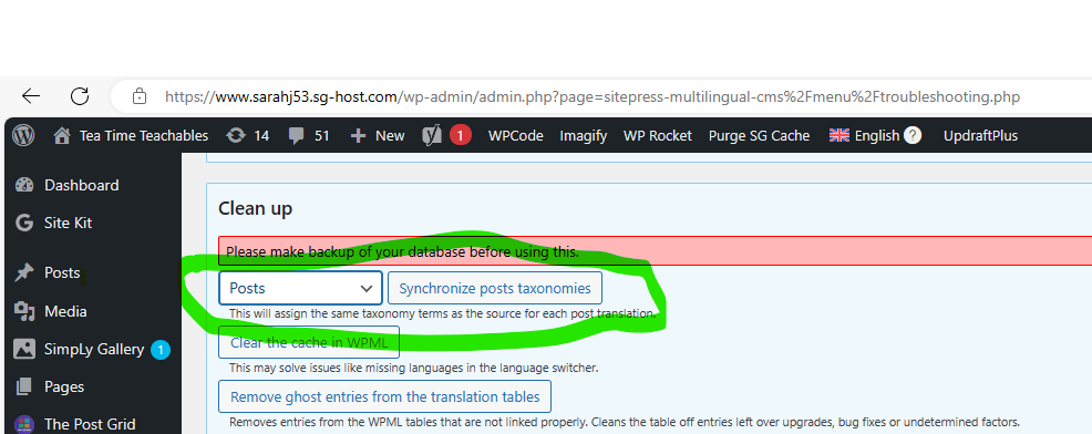

Do you need the tags translated or copied to the Spanish posts?
If you only need them copied over, try the option in WPML -> Support -> Troubleshooting -> Synchronize post taxonomies (for posts). Please see the attached screenshot. The option will assign the same taxonomy terms as the source for each post-translation.

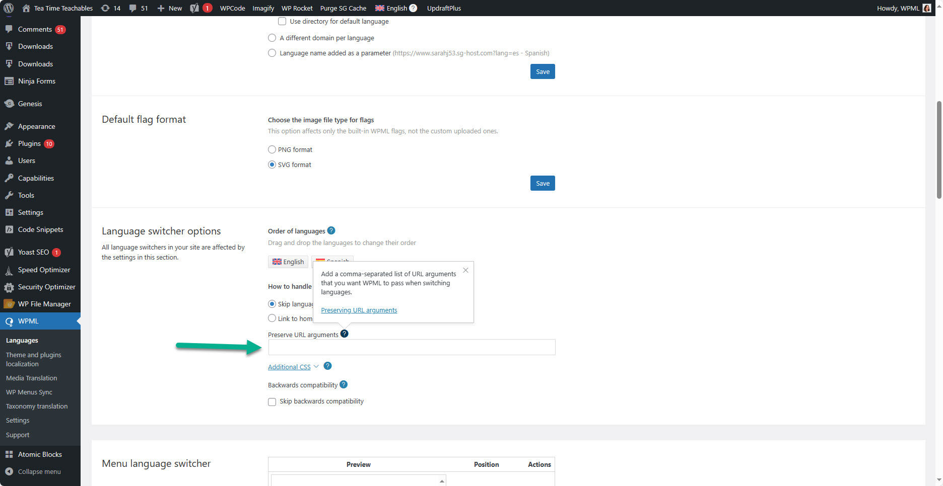

Going back to the start of this thread, I want to remind you that I suggested another option to try to fix the problem with the Simple Download link to download the file. This option is called "Preserve URL arguments". It is in WPML -> Languages -> Language switcher options. Please see the attached screenshot. You can read about it here.
https://wpml.org/documentation/getting-started-guide/language-setup/language-switcher-options/preserve-url-arguments-when-switching-languages/
Have you tried this option before switching the Language URL format to language in directories?
