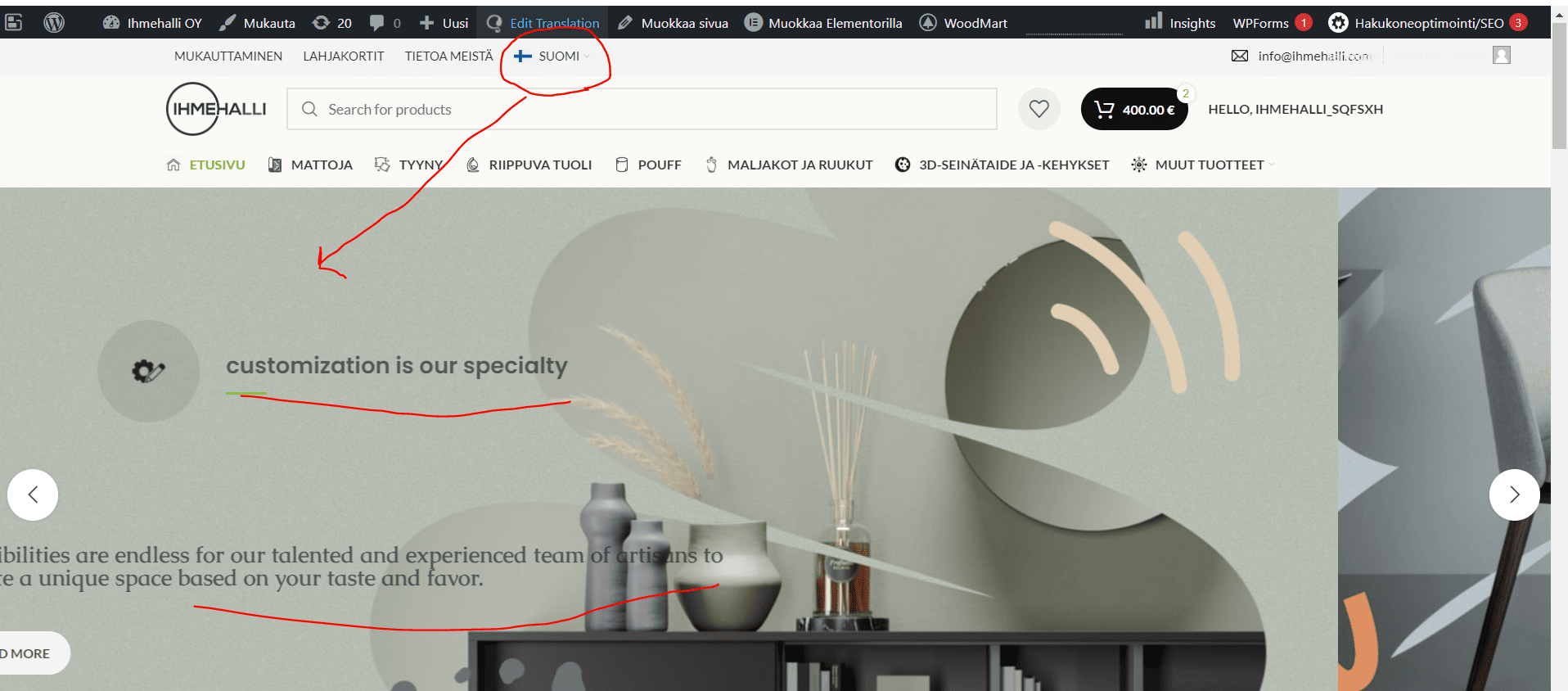

The client's website's main language is English, and they have a secondary language, Finnish. The texts in the Slideshow banner, which were added using the Woodmart theme, do not automatically translate to Finnish when switching languages.

Hello, the main language of my website is English and the secondary language is Finn. In my Slideshow banner, I have entered my texts in English, but when I switch to Finn language, it doesn't automatically translate my slide show banner into Finn; it is always English. Can you please guide me on how to fix this problem? or if you need my website credentials, let me give them to you. Regards

Upon reviewing your site, I noticed that the Slider was added by the Woodmart theme. To enable automatic translation of the Slider contents, it's necessary to set the Woodmart Slider Post type to be translatable and then activate the Automatic Translation feature for this specific post type. To understand the overall process of translating Woodmart sliders, please check the instructions mentioned in the guide below.
- https://wpml.org/documentation/theme-compatibility/create-multilingual-websites-using-woodmart-theme-and-wpml/#translating-sliders
If you want to Automatically translate the Woodmart Sliders, please enable the Automatic Translation option for the Slider post type, by following the guide below.
- https://wpml.org/documentation/getting-started-guide/translating-custom-posts/
I hope the information above will help in solving the issue. But, if you need further assistance, please feel free to let me know. I will be happy to help.
