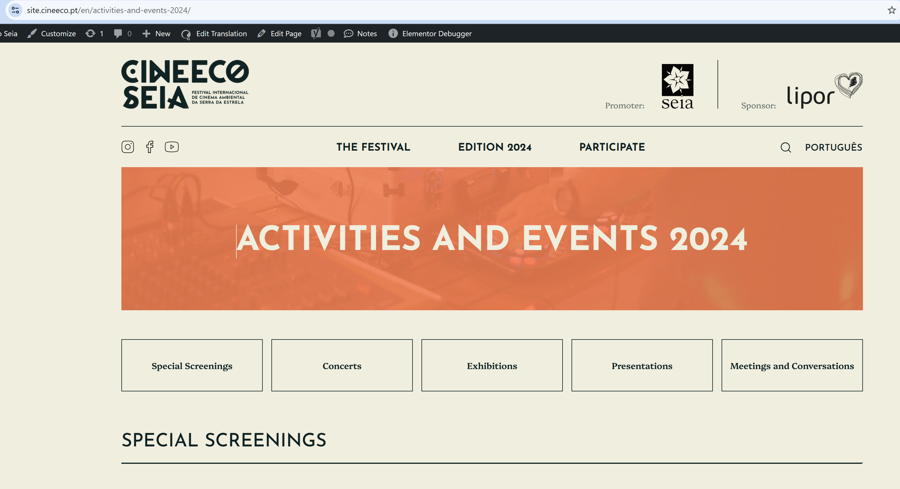

The page that displays a grid of these custom posts (hidden link) shows the list of translated posts. However, the dynamic fields linked to the custom fields no longer appear after the translation. In other words, the content that should appear in those dynamic fields—coming from each post’s custom fields—is missing.
When I click on one of the translated posts in the grid, I get a critical error. The same happens if I try to view or preview the translated page from the back end—it also shows a critical error.
I can’t figure out where the issue might be…

I ran a test. When I visit a partially translated custom post, like hidden link, everything works—except for the custom fields. This is what used to happen before I activated translation for custom fields: the fields simply didn’t show.
However, when I visit a fully automatically translated custom post, like hidden link, a critical error occurs (see the uploaded image). This started happening after enabling translations for custom fields.

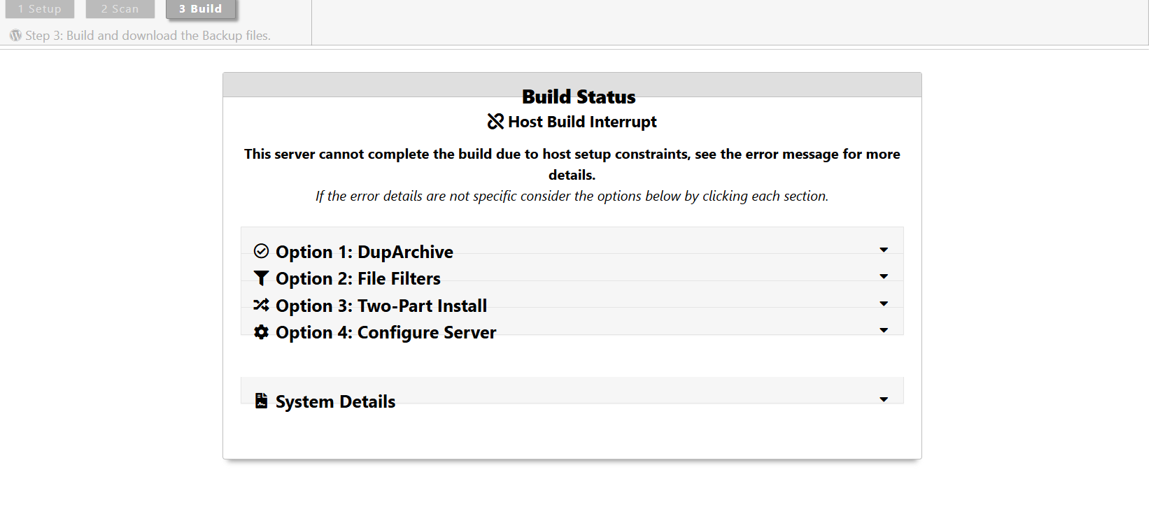

Thank you for the updates. We were unable to complete the creation of the Duplicator packages due to repeated host build interruptions, and the process has failed multiple times. The result was the same with the Duplicator free and pro versions.
Now, we are also unable to access the staging site, as it shows the error: "This site can’t be reached."
Access to the staging site is mandatory for our troubleshooting, especially since this appears to be an exceptional case that may require escalation.
