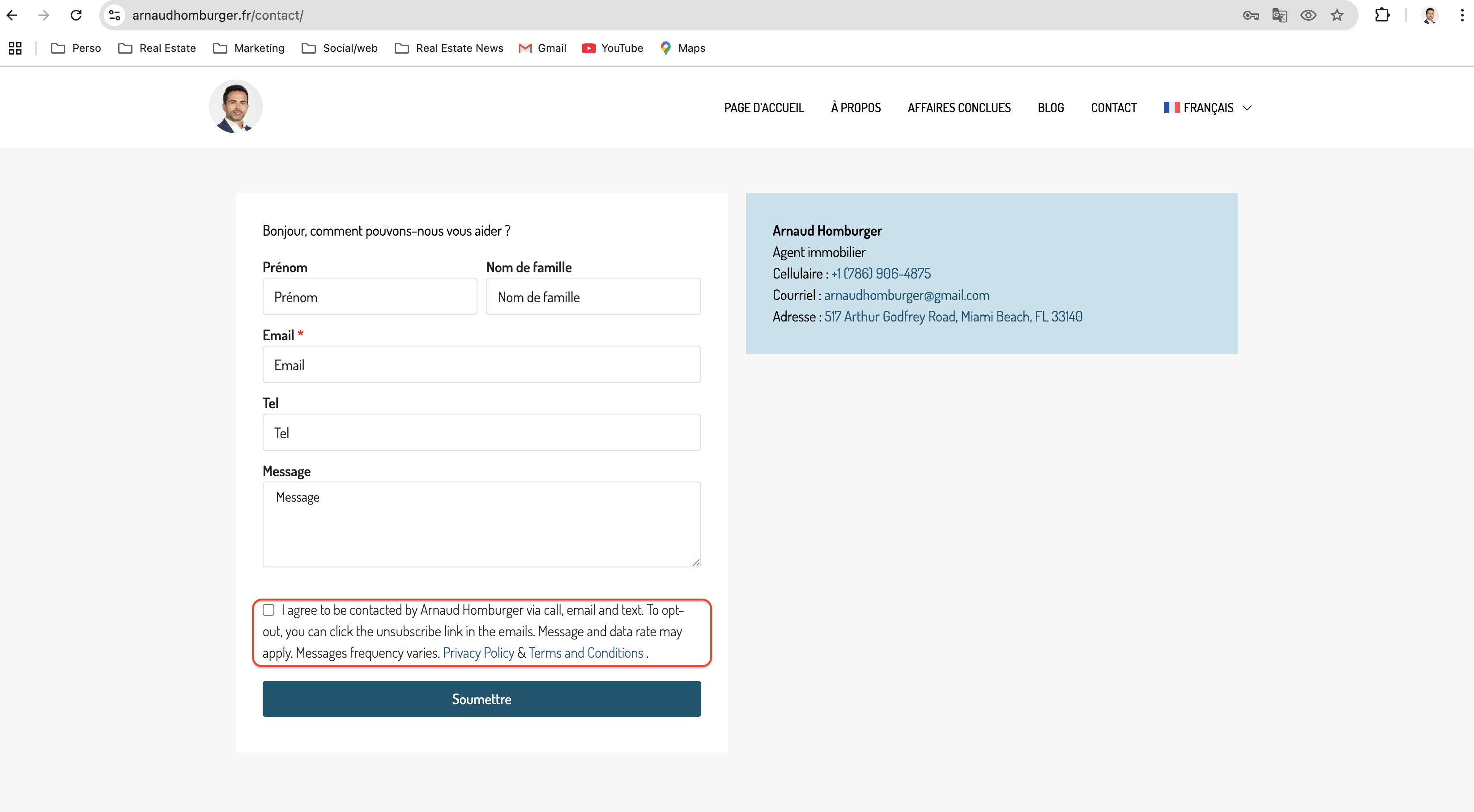

I just noticed that a part of my contact page in french was not translated into french. I feel like at some point it was translated into french, but not sure 100% (I hope it's not reverting again...).
I don't know how to translate this. Could you please help me on that?
Here is the link to the page: hidden link
Attached you can see the text I am talking about.

I have translated the form text : hidden link
This was not translated before, it was part of the Houzez form widget that we registered before for a different form (but we missed these field as it wasn't used on the other form)
I did the necessary changes to register it and added it to the list of correction Houzez have to apply,
