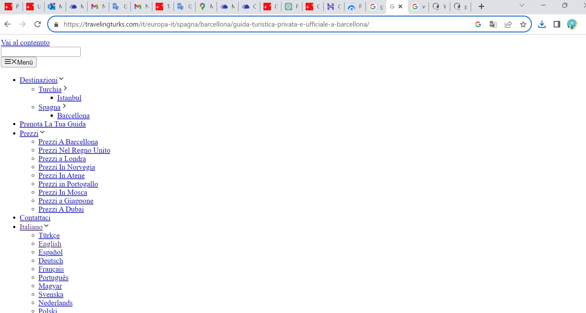

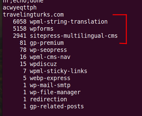

Dear Nicolas hello, some of the pages are very slow but open in normal speed when I disable "string translation" plugin (but the page looks strange as well as in the attached). My hostimg company told me that the reason is slow php requests, what we can do? Thanks a lot.

I did a few tests with the Query Monitor plugin ( https://wordpress.org/plugins/query-monitor/ ) and I see your site is generally slow even when WPML plugins are deactivated. (About 5 seconds of loading time).
But when WPML plugins are activated it is even slower ( About 11 seconds of loading time ).
This suggests that the issue might be due to WPML but it could also be due to interference from another plugin, especially because the site is still slow when WPML plugins are deactivated.
