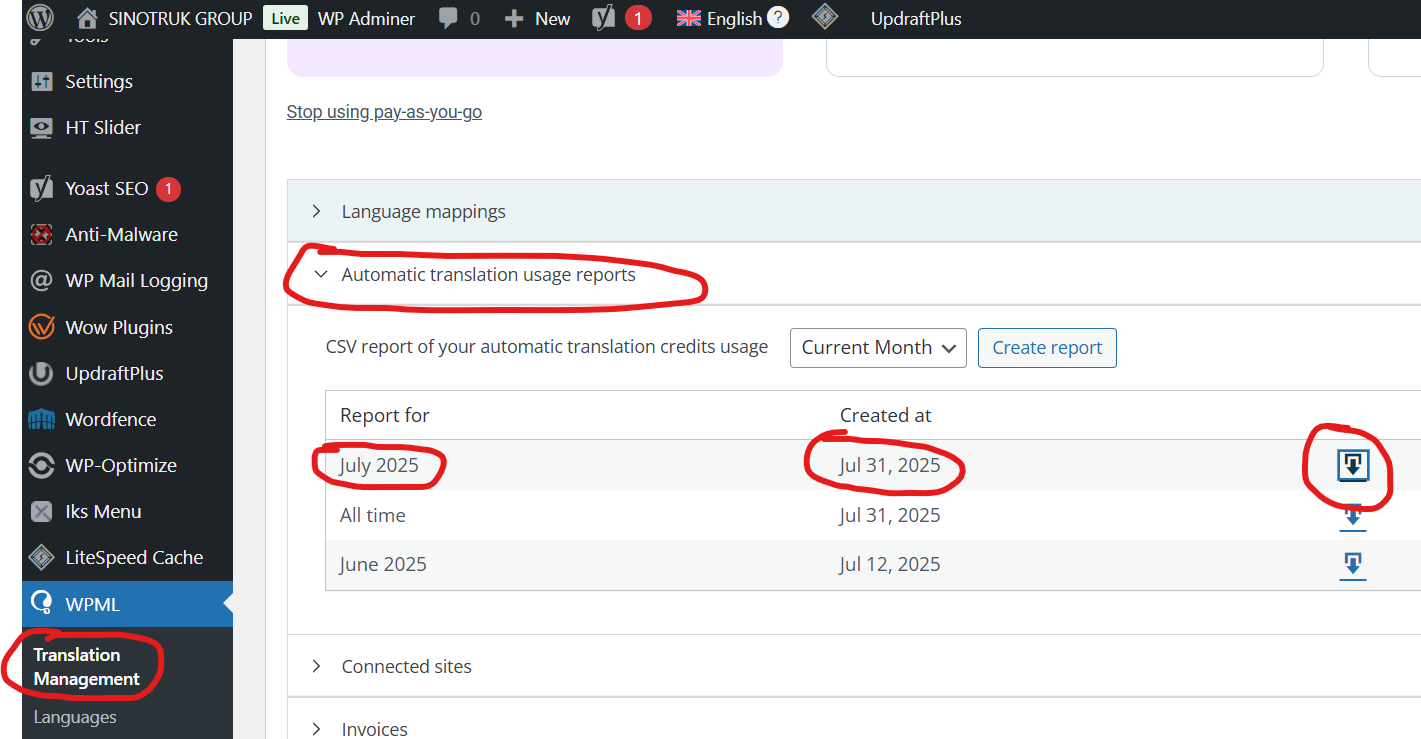

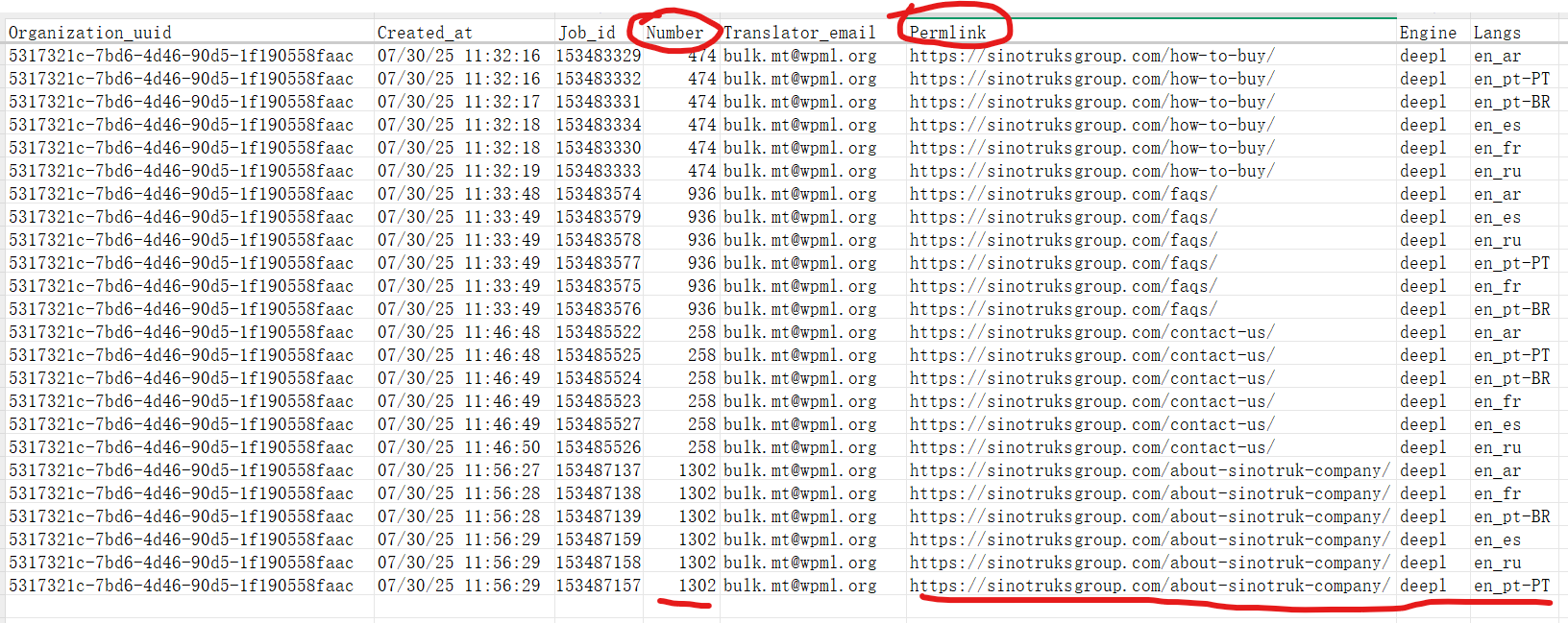

You can download this file (in the screenshot below), which contains all the pages I have recently translated. All of them have used up new points, which should not be the case. thanks

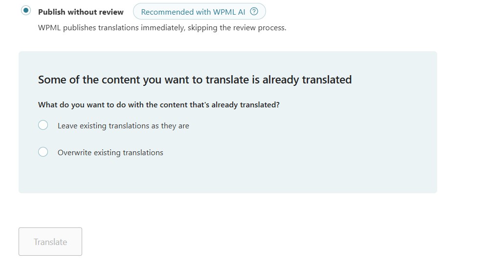

Please see the attached image and let me know which option did you select when retranslating the pages recently?
July 31, 2025 at 1:47 pm #17285250
jackZ-5
Dear, thank you for your reply.
I know I should choose the first option (keep the existing translation). There is no need to translate it again.
However, when translating the About, FAQs, News, and Parts Catalog pages, these two options did not appear, so I was unable to select them.
Please translate one page for testing purposes. Thank you.
