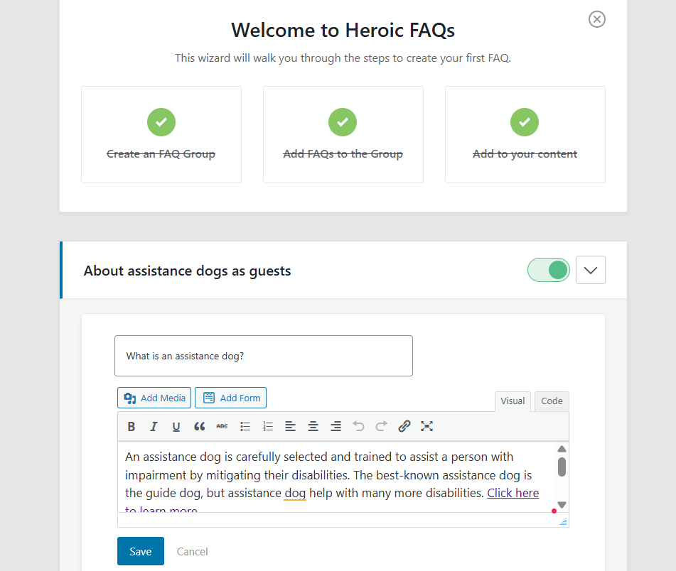

So we need it in the FAQs and there is no translation mentioned. I made a screenshot. Do you have an idea where we can access the translation or should I get a login for you?
Best regards, have a nice weekend.

April 22, 2026 at 6:00 am #17985901
Dražen
Thanks for the update I’m glad the first link helped.
Regarding the issue on the German page (“This FAQ group 72 contains no items…”), along with the mixed German/English content and the fact that everything appears correctly translated in the WPML editor this unfortunately points to a compatibility limitation with the plugin itself.
From what I can see, the plugin is not fully built to support multilingual setups. In some cases like this, it may not correctly load translated content, and can even trigger critical errors.
I would recommend reaching out to the plugin author and reporting this behavior. You can also suggest they join the WPML Go Global Program we’d be happy to collaborate with them to make the plugin fully compatible with WPML.
As a workaround in the meantime, you can try the following:
- Set the FAQ group to Not translatable
- Create a separate FAQ group for German
- Manually edit the German page and assign that new FAQ group
I tested here and it works fine: hidden link
Let me know if you have any further questions or doubts.
