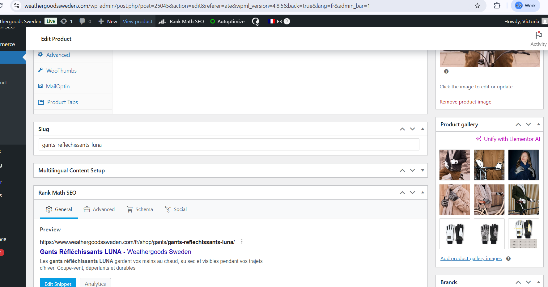

Ok but this seems to be affecting that my product galleries are not syncing. you see here
these galleries are completely different even though the back end shows the same

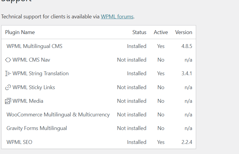

I have WPML Media Translation installed, but several features that should be available are missing:
WooCommerce product gallery synchronization
Media duplication options
Media Translation Dashboard
“Start Sync” / “Regenerate media translations”
I only see a single “Automatically detect best options for translating image texts” setting.
Is this related to the missing Multilingual & Multicurrency module on my account, or is there another configuration issue on your side?

November 27, 2025 at 8:30 pm #17616613
victoriaK-4
the proper gallery shows in the backend but not on the front end

November 27, 2025 at 8:32 pm #17616702
victoriaK-4
here are screenshots and you can see the difference on this product
hidden link - shows complete product gallery
hidden link - shows only 5 of the images
November 27, 2025 at 8:32 pm #17616704
victoriaK-4
but the back end of the product in FR or any other language shows the same gallery as in the screenshot above

November 27, 2025 at 8:33 pm #17616706
victoriaK-4
here you see back end in FR

November 27, 2025 at 8:42 pm #17616727
victoriaK-4
We tested and now it seems the issue is with woothumbs which we have as the gallery, the gallery works when we disable. WPml says that woothumbs is compatible, but it has not been tested since jan 2024
