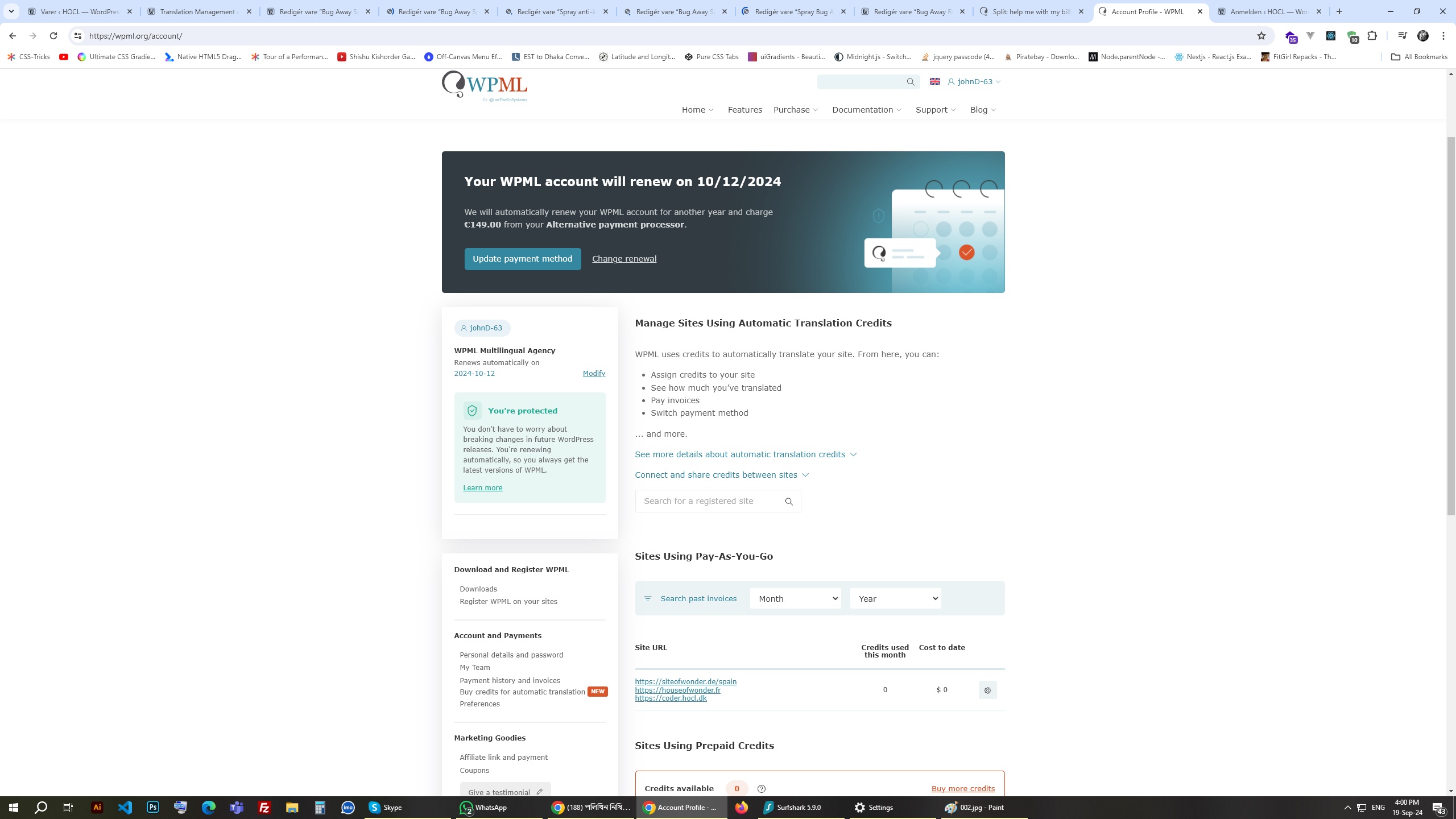

001 = pay as you go is connected with my account.

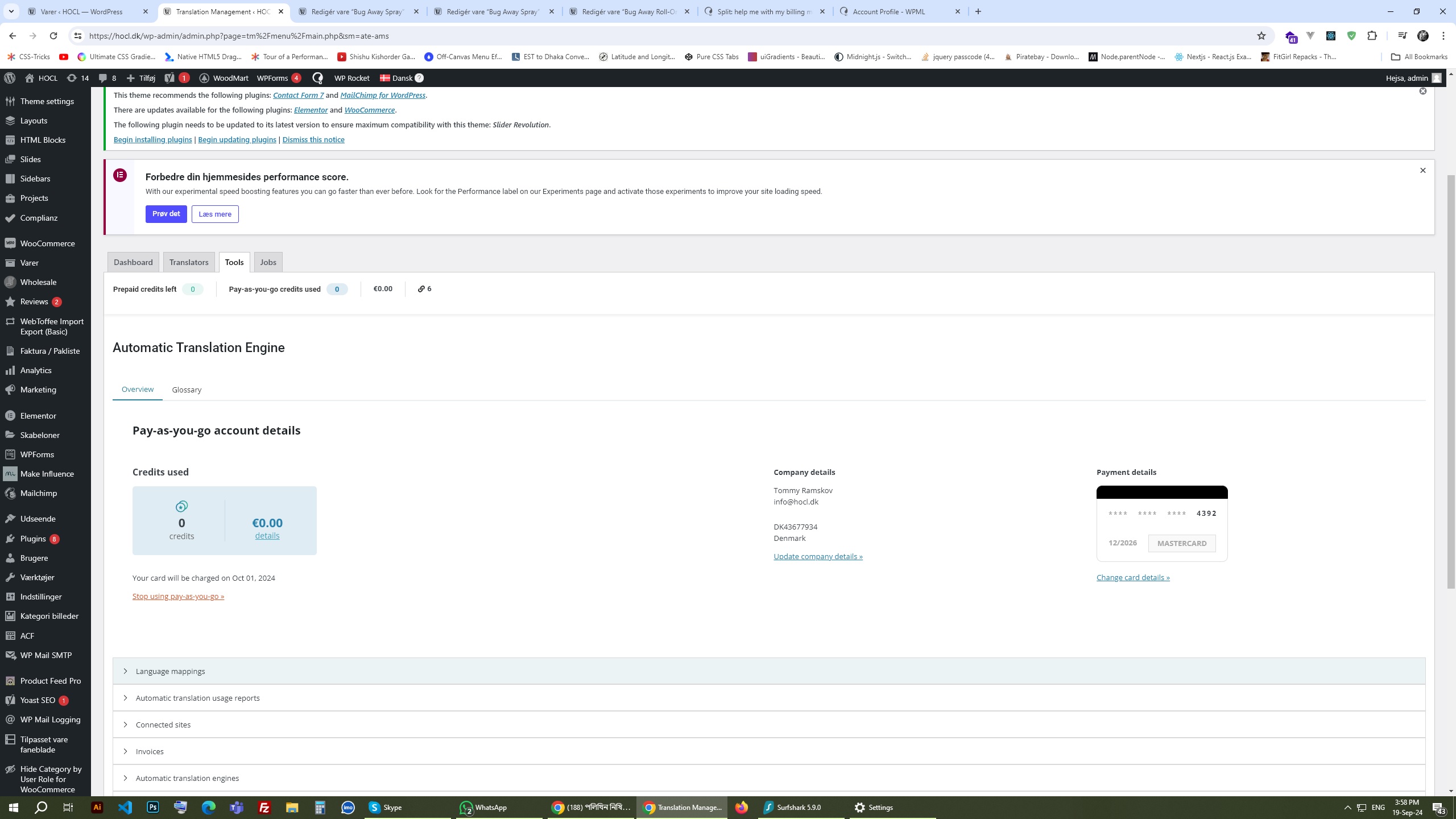

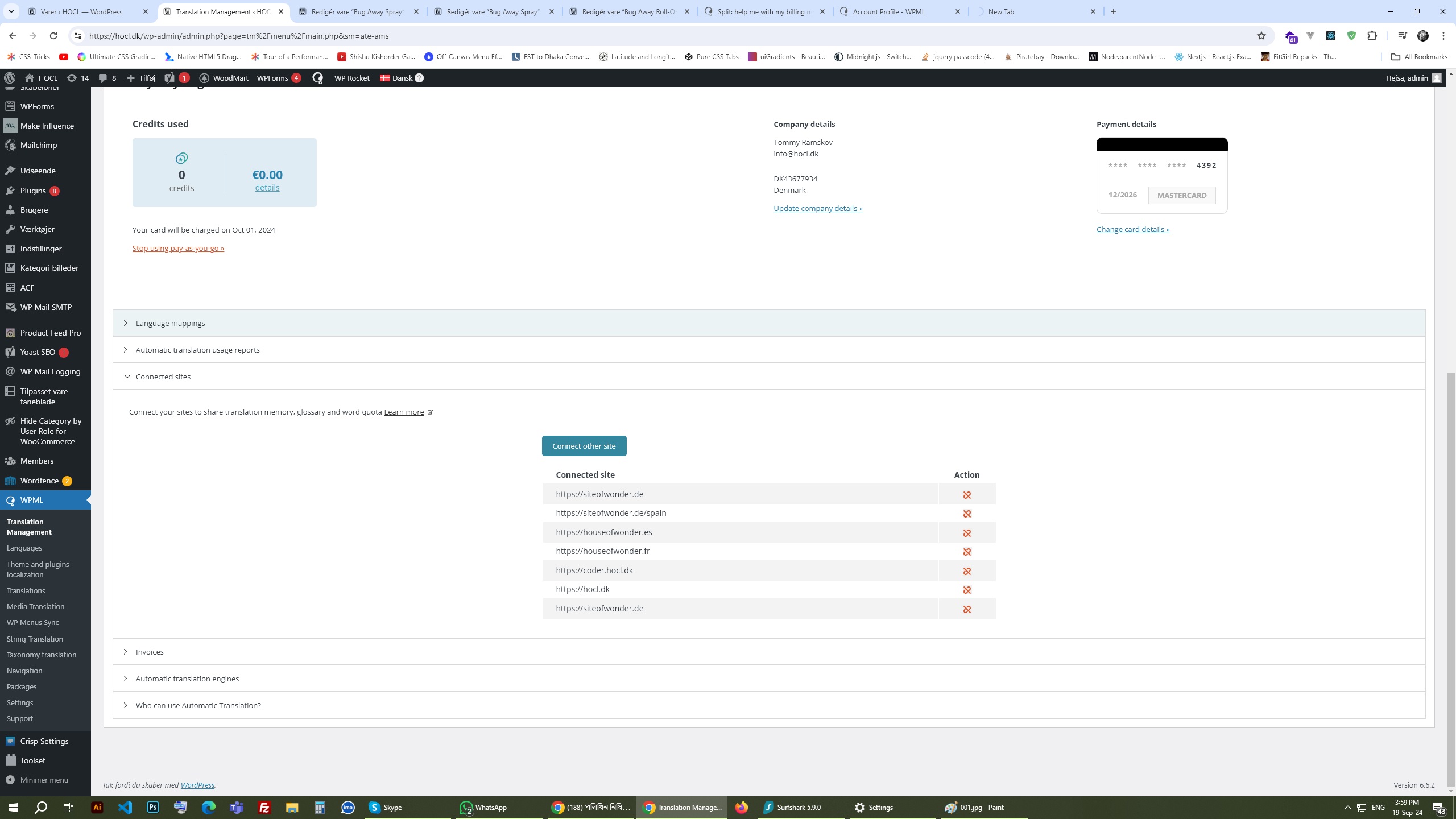

002 = These are all the sites connected with this card.

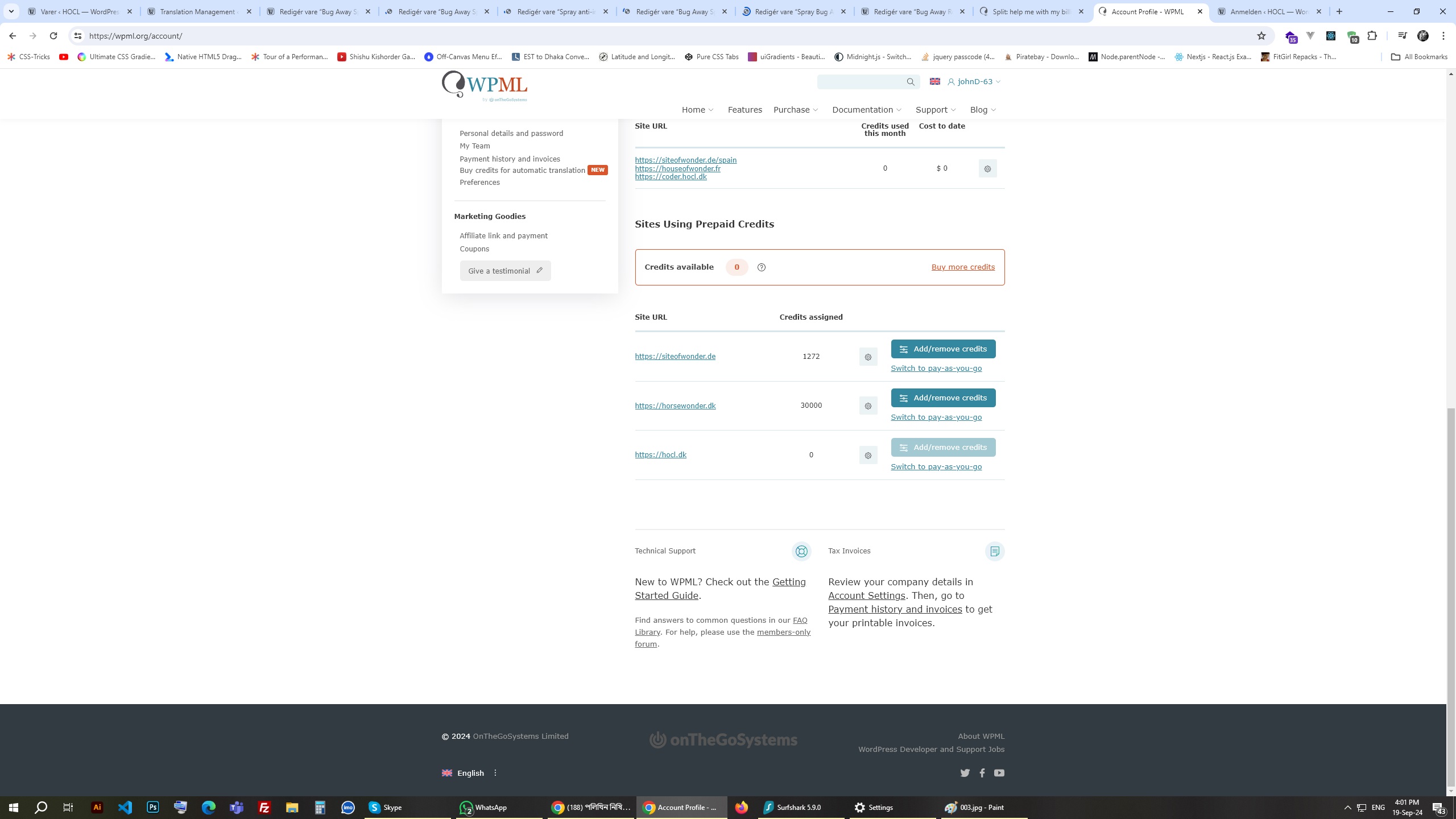

004 = why it's showing Prepaid Credits 0? Why do I see credit assigned on those websites?

As far as I can see, everything is correct. Let me explain.
When you purchase WPML, you get access to a WPML account. Three types of WPML accounts exist: Multilingual Blog, Multilingual CMS, and Multilingual Agency. You are currently using a Multilingual Agency account.
Your WPML account will renew automatically every year, giving you access to new versions of WPML and our support. Account renewals cost 75% of the original price. The price of 149.00 is a yearly renewal with a discount. There will be no more discounts for new accounts, but you still have a special price.
Pay-As-You-Go subscription is for Automatic Translation. There is no monthly subscription fee, and you can cancel at any time.
Here’s how Pay-As-You-Go works in short:
– Each translated word costs a certain amount of translation credits, depending on the translation engine you use (Google, Microsoft, or DeepL).
– The first 2,000 translation credits you use each month are free. If you spend more than that, we will charge you based on how many credits you used beyond that, according to the current pricing table. You cannot carry over unused free credits to the next month.
– Prices are calculated progressively, so the more you translate in a month, the cheaper it is per credit.
– If you didn’t spend any credits in a given month, we simply won’t charge you anything.
– For each automatic translation invoice, you will be charged for any credits you used during the previous calendar month. The billing period starts at midnight UTC on the first day of the month and ends at midnight UTC on the first day of the next month. Invoices are issued, and your credit card is charged on the 3rd of each month.
– WPML does not store your credit card information. Payments are processed via Stripe.
Credits: You do not have prepared credits, as you are on a Pay-As-You-Go subscription. However, you can add credits to any site that doesn’t use pay-as-you-go. These credits do not expire. If you have already assigned credits, you can view them, as you may have assigned them before. If the credits are already assigned to a site that uses a Pay-As-You-Go subscription, the assigned credits will be used first.
