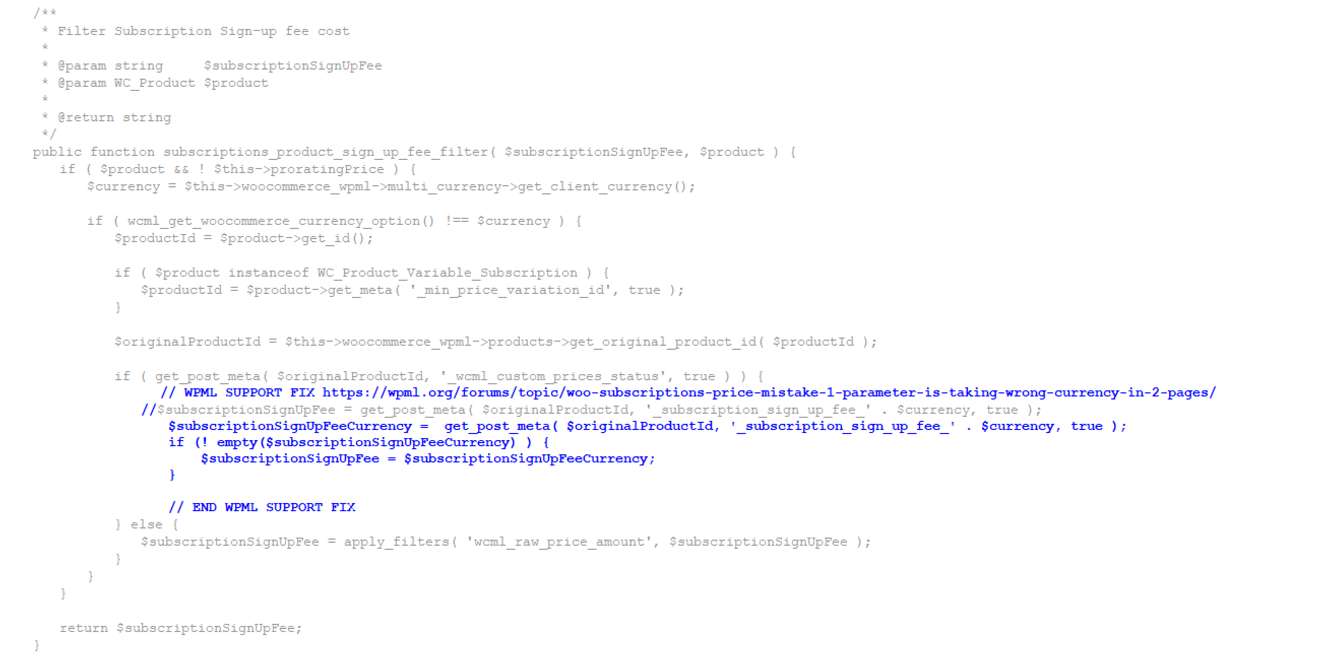

February 14, 2024 at 10:21 am #15301180
guy@media-vision.co.il
P.S.
You will find another small fix in the new version that was also provided by your support.
This is a really small change that ensures the "Price From" (shown in grouped products) will be correct. The same for this bug - it was only for the USD currency.
If you can also include this very small but important fix, it would be a great help.
See the image "price_from_fix" to view the line changed.
