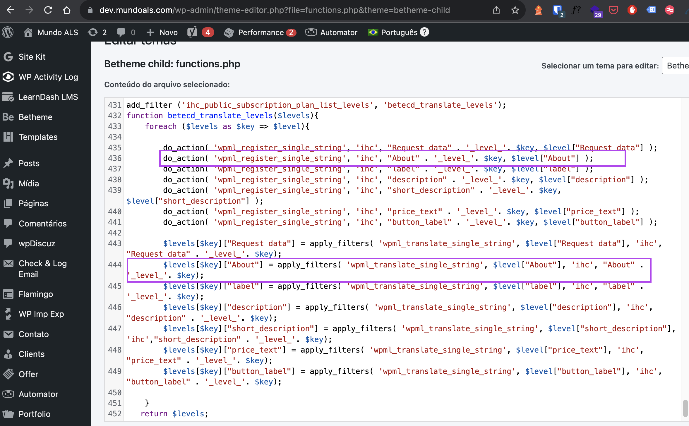

Thanks for your response. But this solution from the other topic didn't work for me.

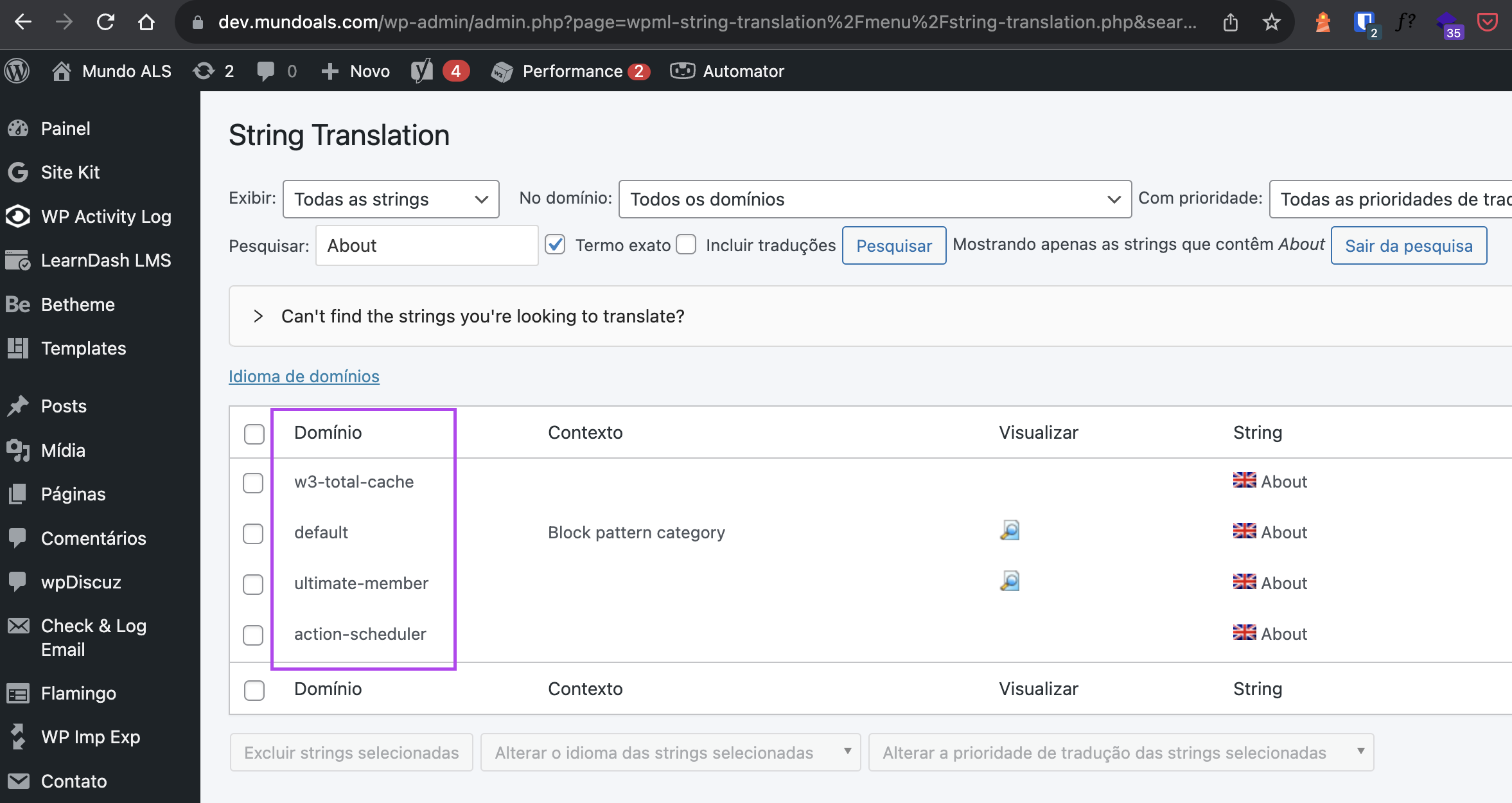

I added the code to functions.php but the strings did not appear in "String translation". See the attached images.
Just out of curiosity, I searched for the "ihc_public_subscription_plan_list_levels" filter in the Ultimate Member and WPML source code and didn't find it. Maybe that's why the solution code didn't work.
