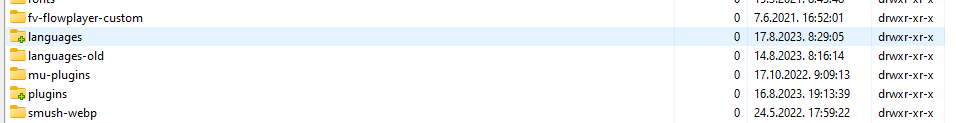

Hi, meanwhile the site crashed again, so we needed to disable wpml string translation again.
After we have disabled languages directory into "languages-old" and enabled wpml string translation it worked fine. However seems that plugin has created new "languages" directory (please see attached) and now it is again crashing website. (draining all the resources and we get timeout)

WPML Supporter since 02/2018
The languages directory will be recreated, for sure.
