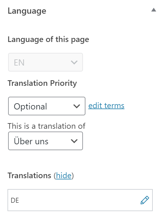

tanjaK-10
Hi Kor,
As you can see in the image i do not have the same view that is pictured in the article in the EN View. Strangely only in the German Version i get this "WPML Translation Editor" & "Word Press Editor" View. But the German Version is the Translation not the Original.

March 25, 2024 at 9:01 am #15445155
WPML Supporter since 08/2022
Thanks for your reply.
This happens because the German Language is now the primary language of this page. We need to change it back to English as the primary language.
To do that, please follow the instructions below.
1. Disconnect the page from the translated page https://wpml.org/faq/how-to-disconnect-translations-from-the-default-language-page-or-post/
2. Then, link the pages https://wpml.org/faq/how-to-link-already-translated-pages/ and set the English Language as the primary language.

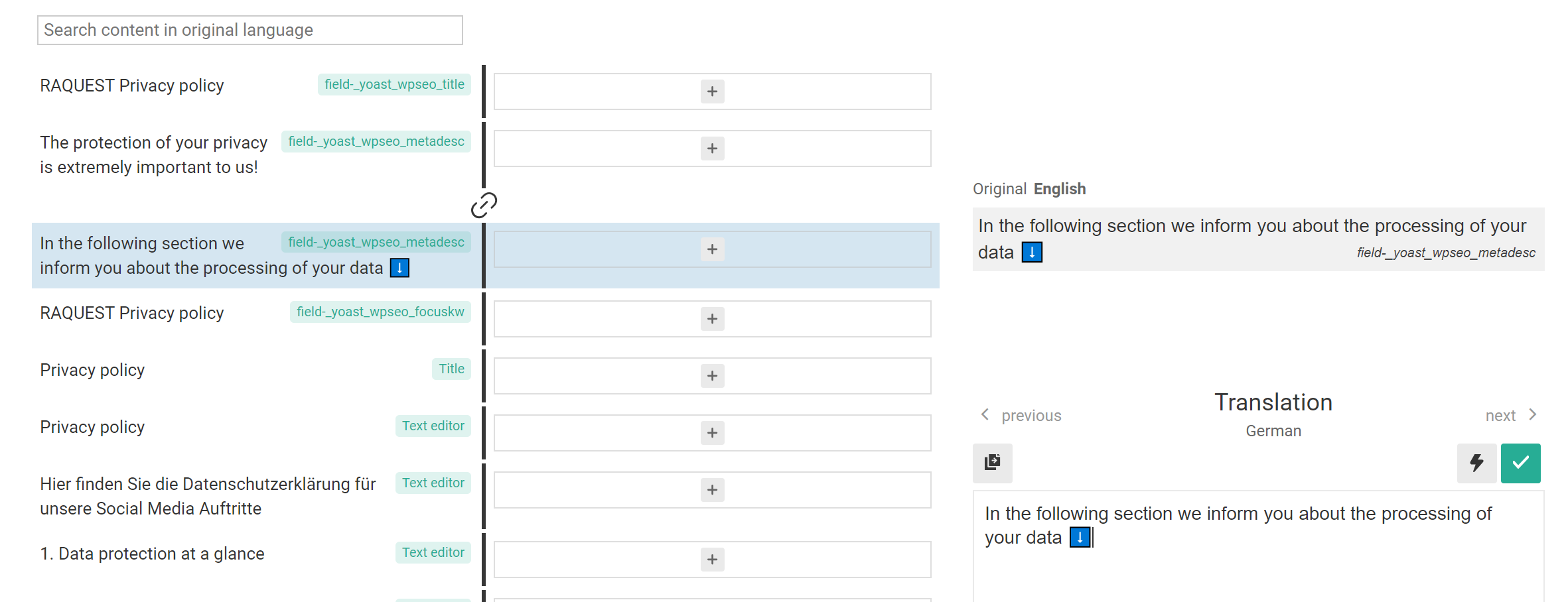

tanjaK-10
We have translated the Privacy Policy site using the Advanced Translation Editor and used our own texts.
The Translations disappeared because of this unlinking Process you sent me.
Translation Memory doesnt work for us. (As you can see in the screenshot)

April 10, 2024 at 12:28 pm #15504757
Thank you for getting back to me.
I grasp the situation now. Earlier, the main language page was in German, and the content was translated from German to English, with the translations being saved in the translation memory.
However, upon switching to English as the primary language, translations are now from English to German, but unfortunately, these translations are not saved because there not translated this way.
So, your options at this point would be to either revert the change or re-translate the page from English language to German language.

April 10, 2024 at 2:57 pm #15505547
Thank you for your response.
Here's how the Advanced Translation Editor functions: it saves translations only from the primary language to the secondary language. If you reverse the language pair, you'll have to retranslate the content to save it in the translation memory.
For instance:
- Translating from German to English: The translation is saved in the translation memory after completion.
- Translating from English to German: Since the default language has been switched, the translation memory doesn't recognize it, and the content needs to be retranslated.
For more information, you can refer to this documentation: https://wpml.org/documentation/translating-your-contents/how-wpml-keeps-track-of-your-translations/
