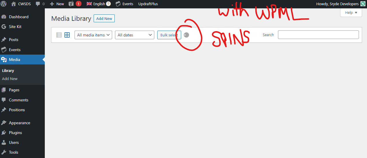

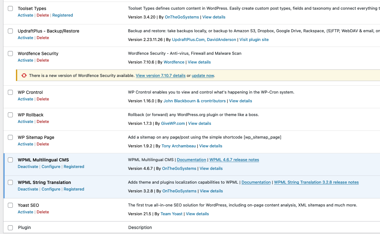

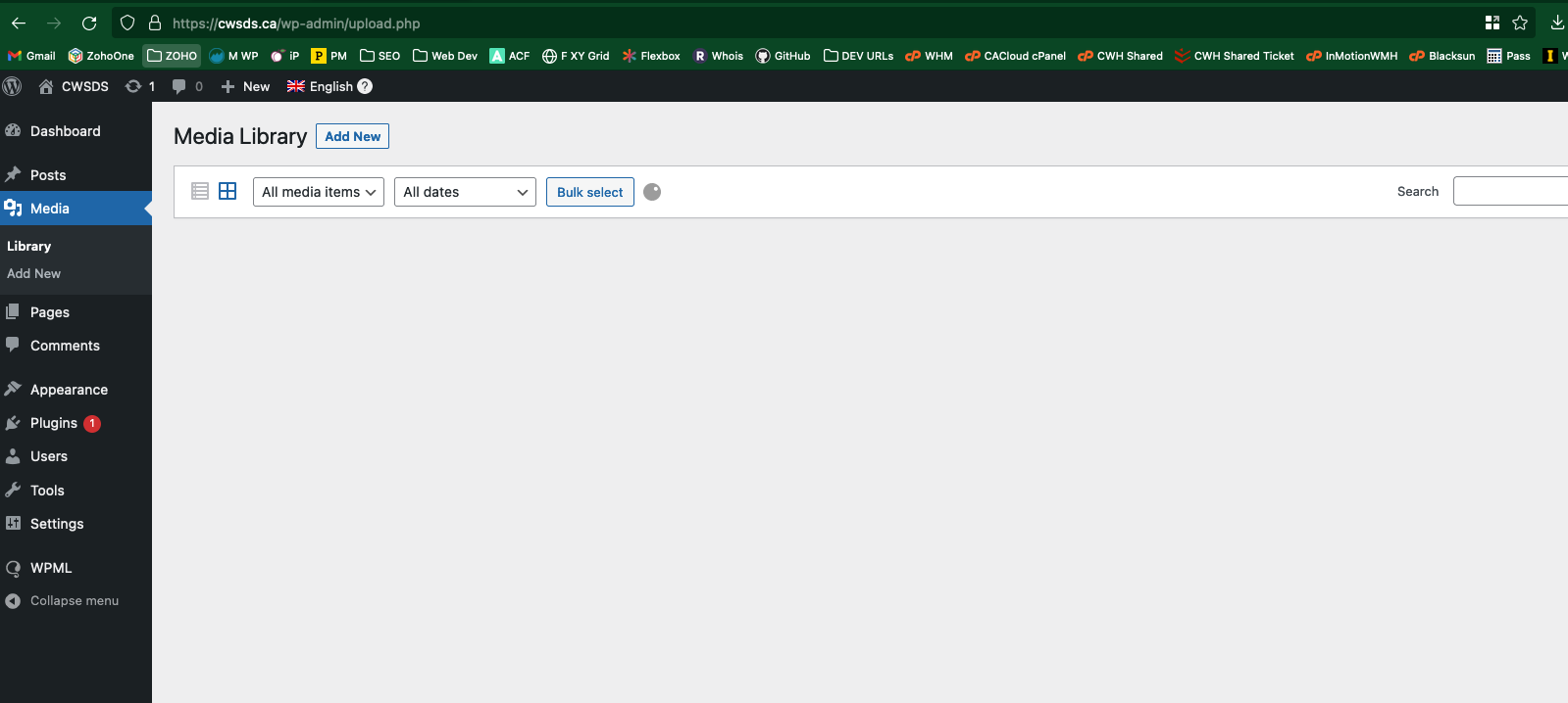

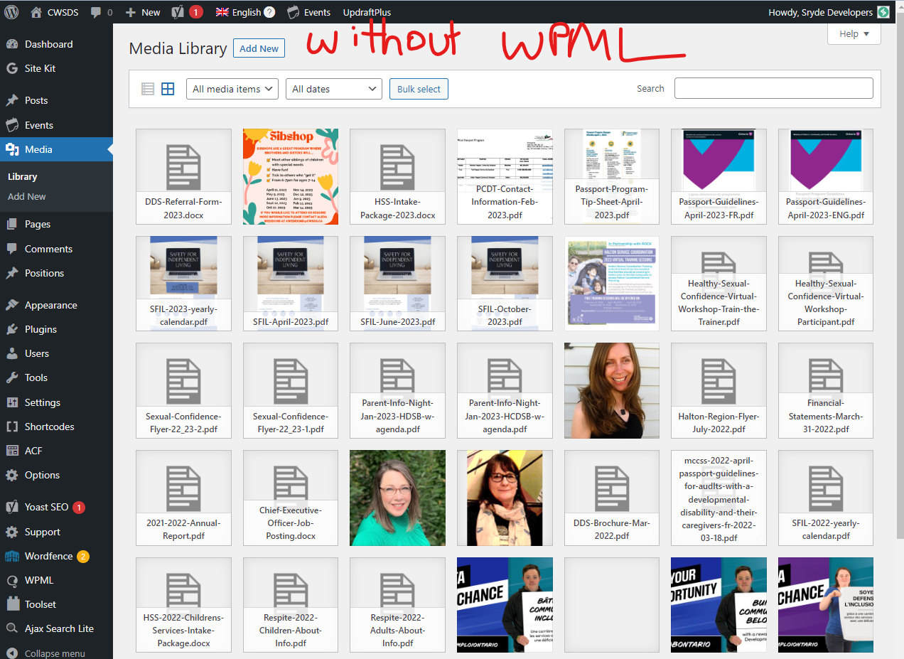

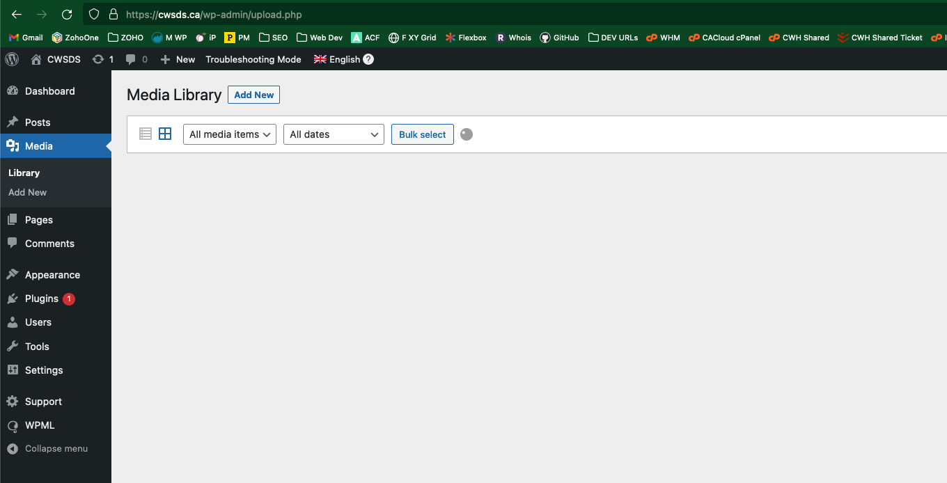

November 6, 2023 at 6:51 pm #14741345
dianeC-4
Hi Christopher,
We just tried what you asked using WordPress' "Health Check & Troubleshooting" plugin, thereby activating the TwentyTwentyThree Theme and only having WPML and WPML String Translation activated. However, we still have the same issue with the Media Library just spinning.
What else can we do to try and resolve this?

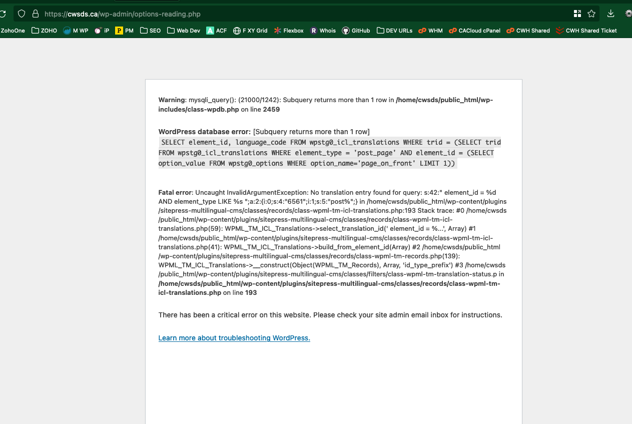

November 7, 2023 at 3:48 pm #14749429
dianeC-4
Hi Laura,
I tried what you asked, manually switched to TwentyTwentyThree and only had WPML and WPML String Translations activate and the Media Library still just spins. There is also errors when visiting many different parts of the admin. Here are the contents of the debug.log file:

November 7, 2023 at 5:28 pm #14750615
Laura
WPML Supporter since 05/2018
There are a couple of errors here, so that's likely the reason you can't load the Media Library.
This one
Uncaught InvalidArgumentException: No translation entry found for query: s:42:" element_id = %d AND element_type LIKE %s ";a:2:{i:0;s:4:"6402";i:1;s:5:"post%";} in /home/cwsds/public_html/wp-content/plugins/sitepress-multilingual-cms/classes/records/class-wpml-tm-icl-translations.php:193
is usually related to database table missing auto_increment.
Please check that all tables have it. For WPML tables, you can use the query from this post (always do a backup before touching the database). Remember you may need to change the tables' prefix https://wpml.org/forums/topic/critical-error-when-not-even-doing-anything-on-the-site/#post-8117663
Solving this might solve also
WordPress database error Subquery returns more than 1 row for query SELECT element_id, language_code
so please check the auto_increment first.
