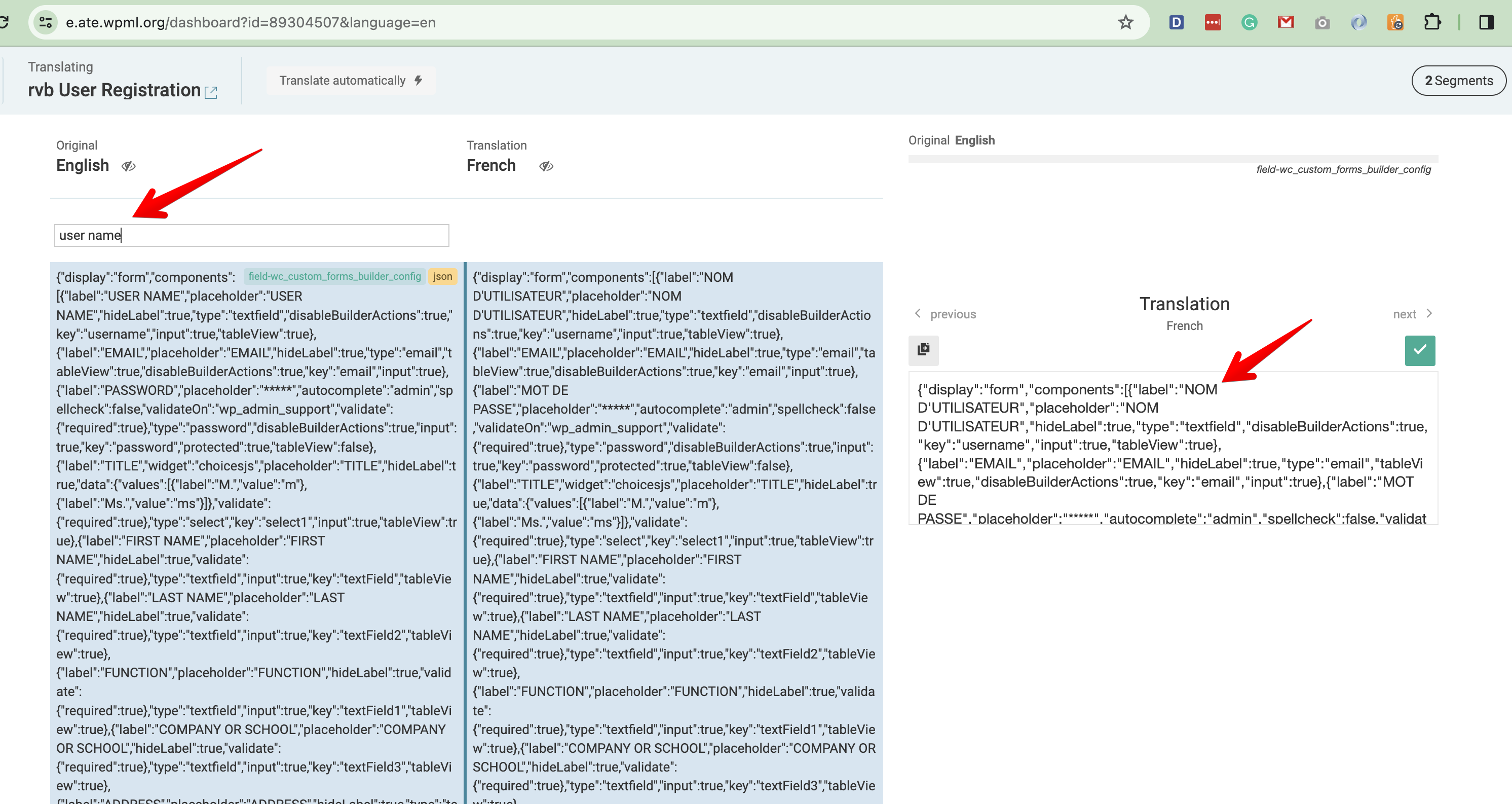

4. In the Advanced Translation Editor > Search for the form label and translate the config field. Note: only translate the label and placeholder, other settings keep the same. Please check the screenshot attached.

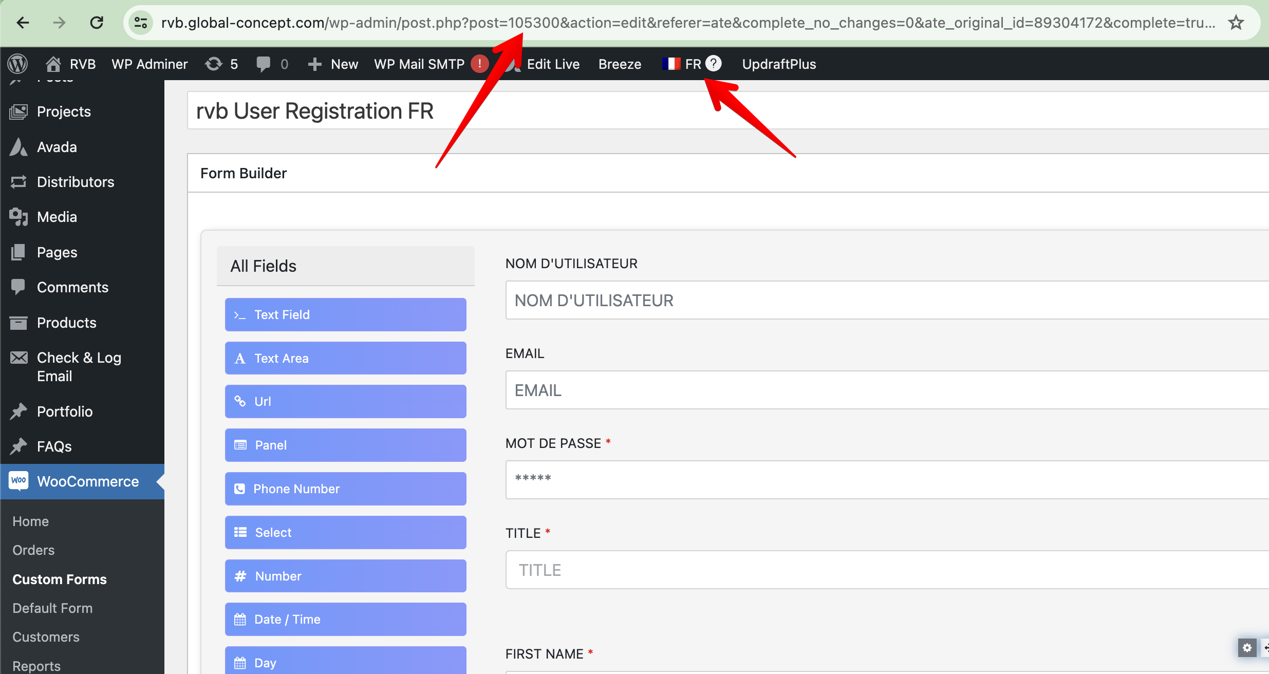

5. Switch to the French language and copy the translation form ID in French (105300).

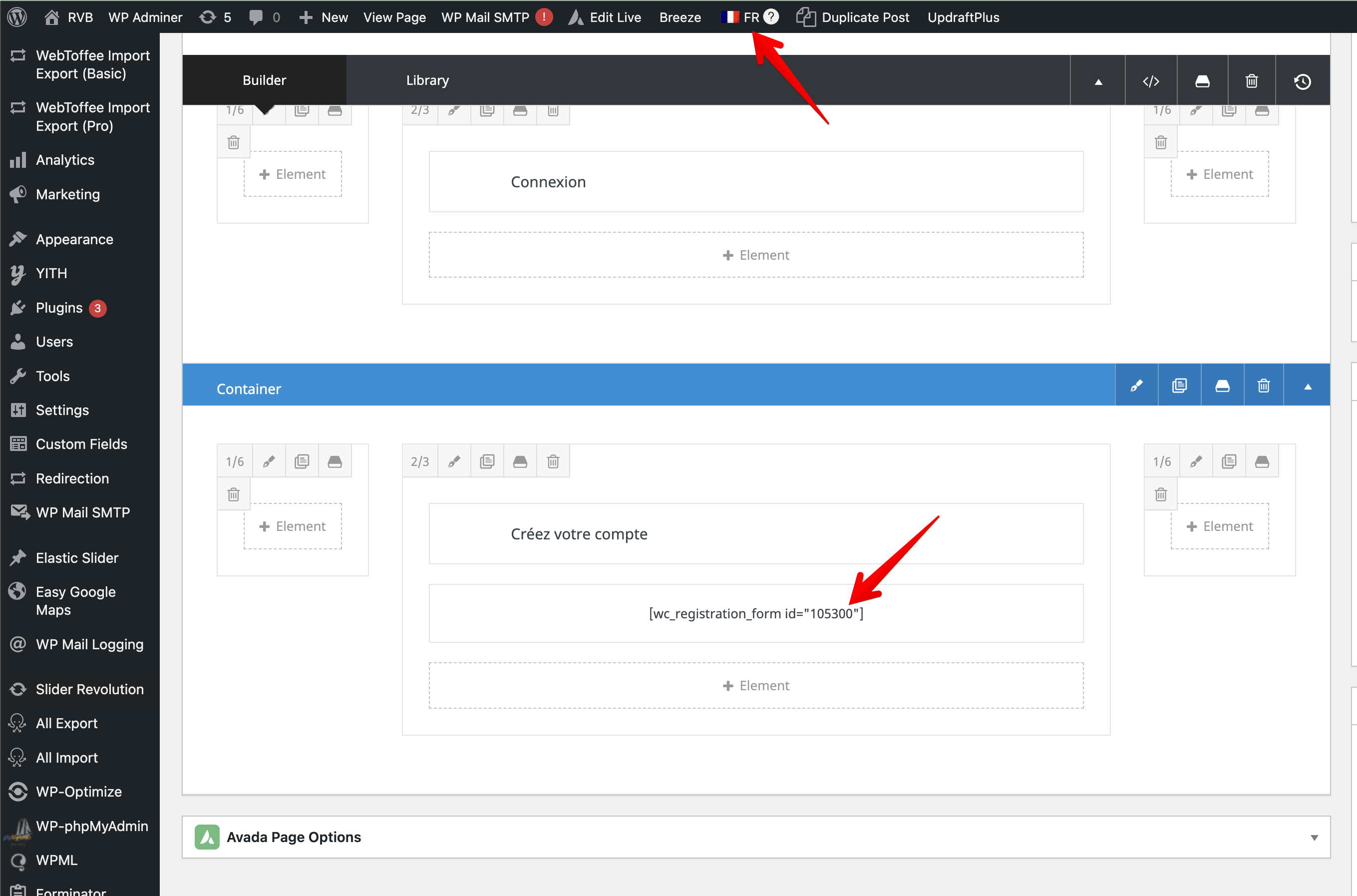

6. You are using the WordPress editor to translate the login and registration page, so you can edit the translation page in French > Replace the form ID in English with the ID in French: 96413 > 105300.
Now you can see the form is translated in the frontend as well.

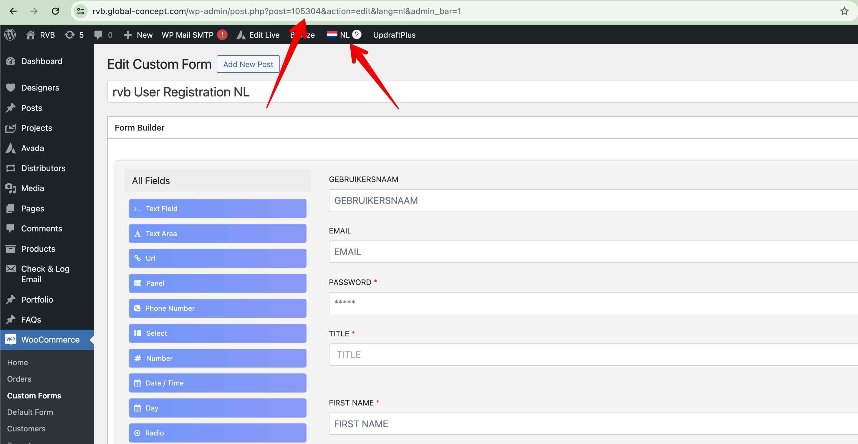

February 1, 2024 at 8:21 am #15253131
Long Nguyen
WPML Supporter since 02/2022

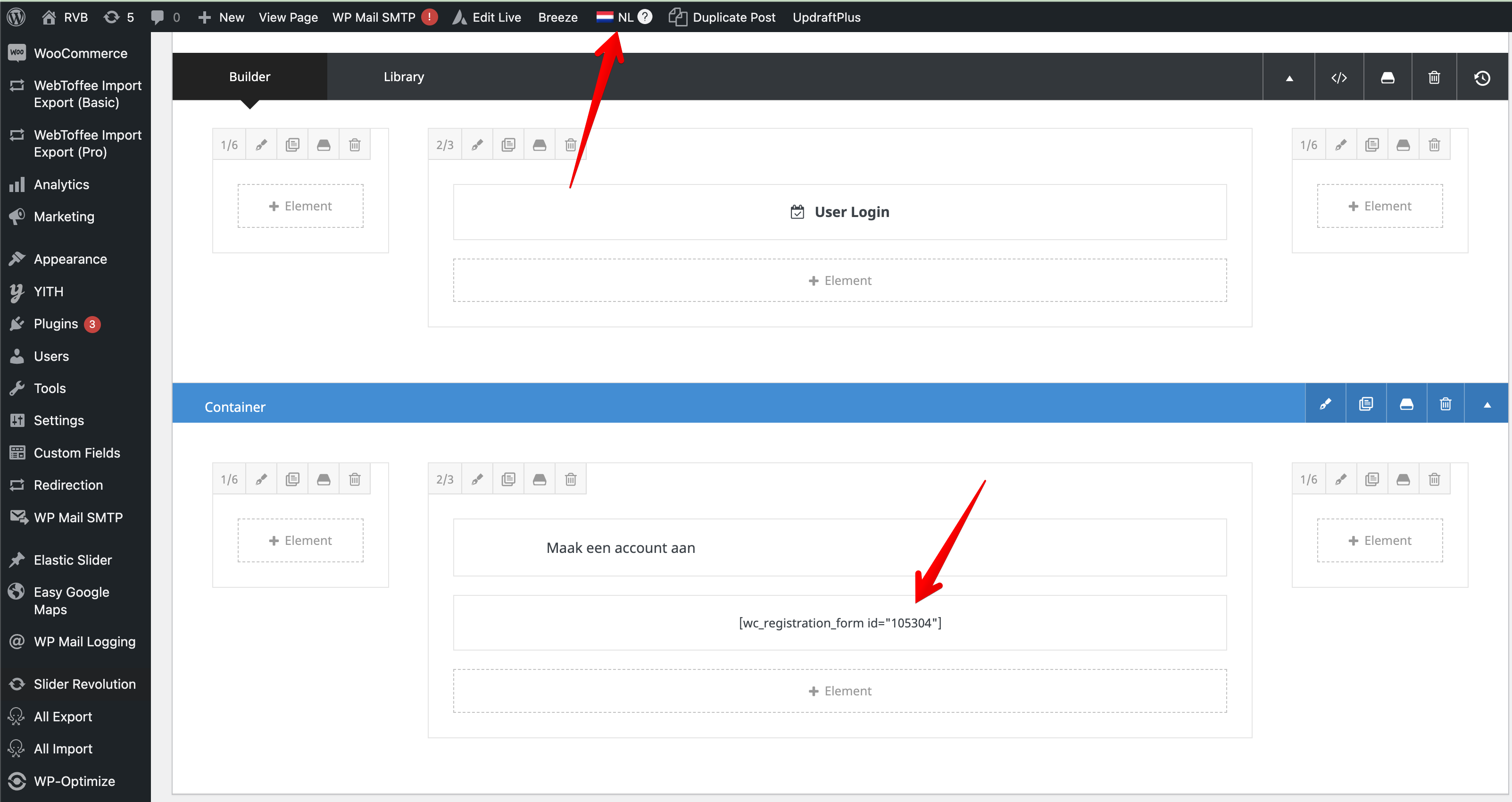

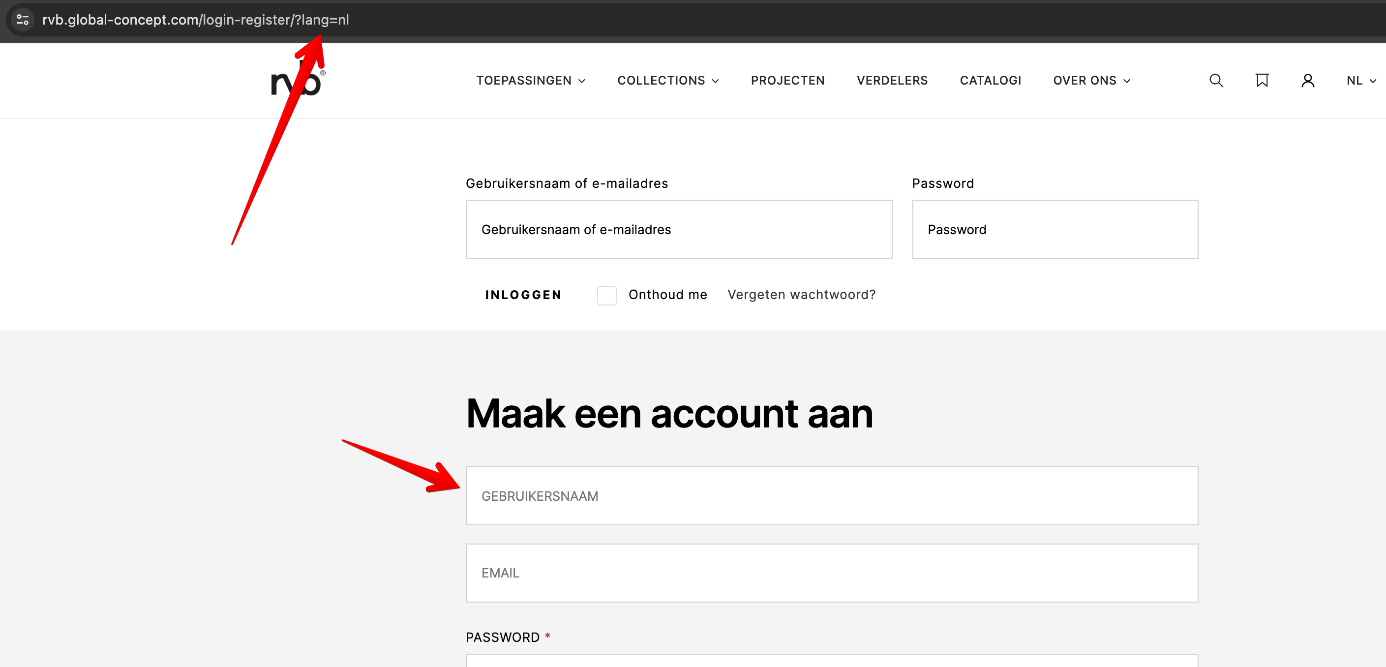

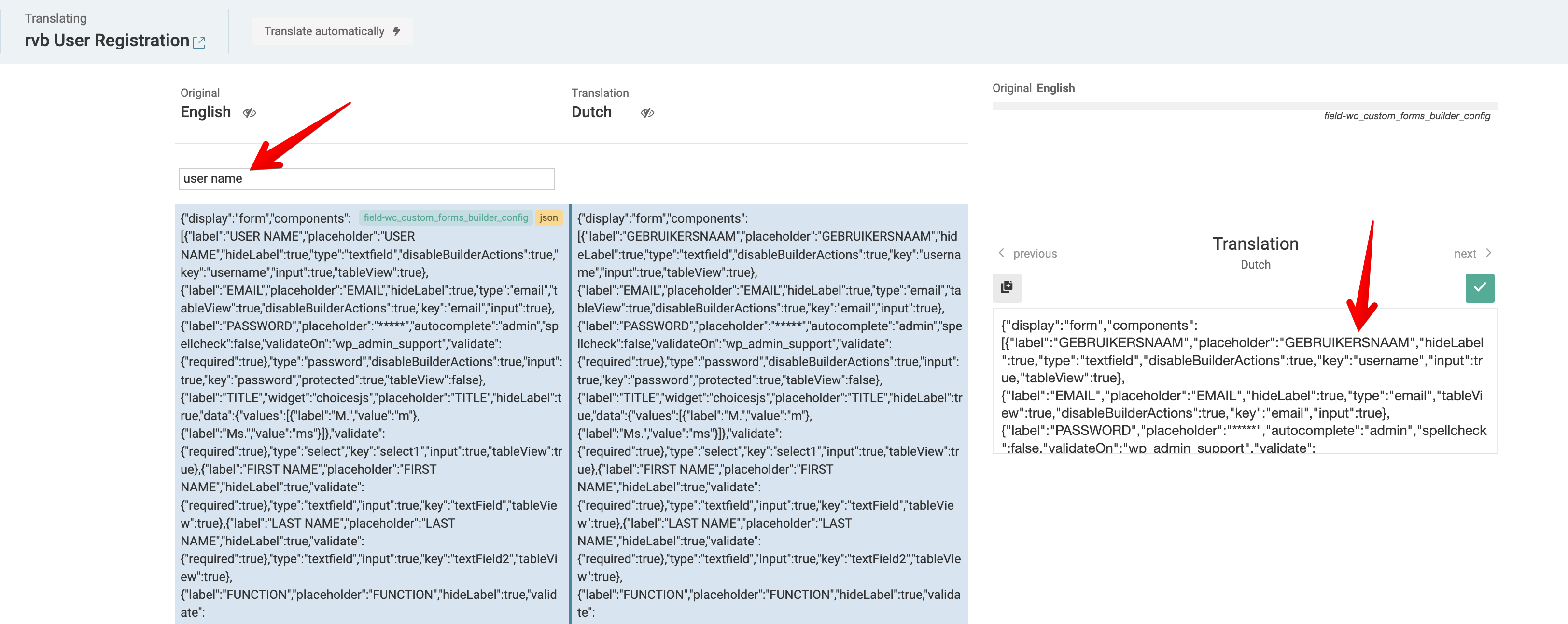

You can repeat steps 3, 4, 5, 6 to translate the form into the Dutch language and show it in the frontend. Please check the screenshot attached.
Look forward to your reply.
