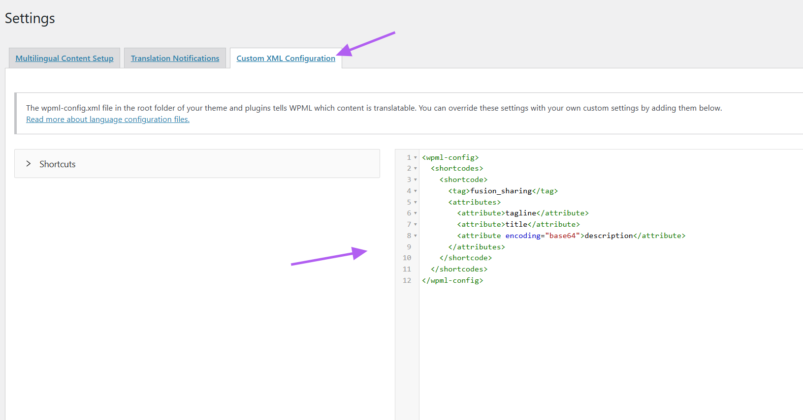

November 18, 2024 at 8:07 pm #16416480
vladimirM-19
Hi Bodul,
I tried your code, and I still get the same error, I did put it under settings - Custom XML Configuration.
The content which is there is
Want to visit Zagreb during advent and you are looking for the best place to stay? That is great news, to help you we give you this list of the Best Hotels near Zagreb Advent & Christmas Market.
