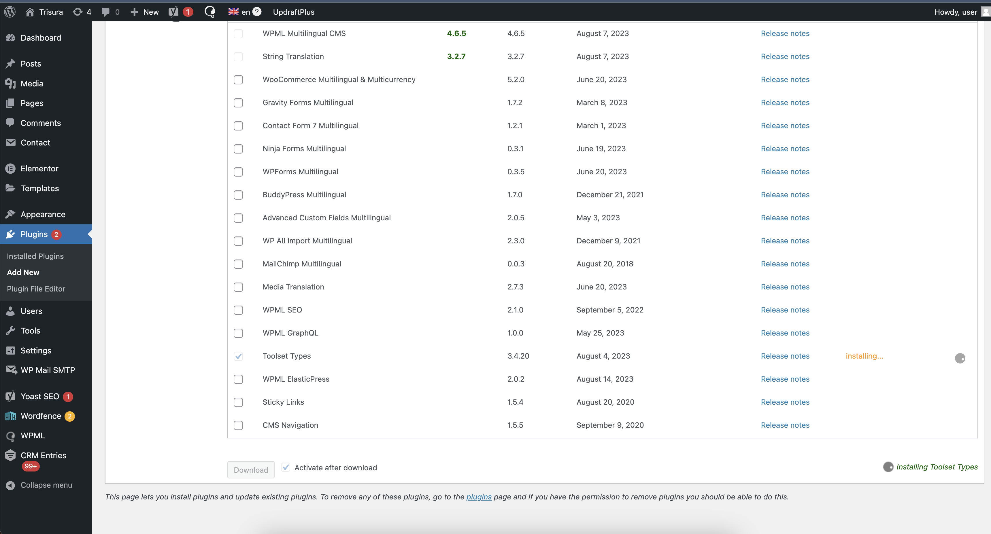

We recently updated a number of our WordPress plugins, but something went wrong in the process. As a result, we no longer have Toolset Types plugin installed. And when we attempt to install it in the 'Add plugin' page, it just keeps spinning and never completes.
No
I will upload a screenshot

susyA
Thanks for the reply. Unfortunately, I'm still not able to get the plugin installed. Manually installing the plugin will spin for a while, then just show a blank page.

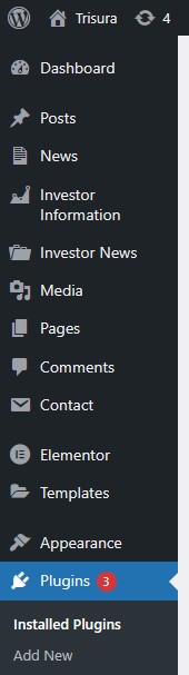

Now, in order to be able to access the site I first had to manually deactivate the plugin "Secure Admin IP" on the server. I continued my tests without this plugin.
While revising the server I further was able to confirm that the Toolset Types plugin folder actually is still available in wp-content/plugins/types.
What is kind of odd here, is that the plugin's folder seems to be missing important files and this is why the plugin is no longer showing up in WordPress.
It seems like someone removed files of the plugin from the server by mistake or your site was a victim of a malicious attack.
So, first of all, I removed the folder wp-content/plugins/types from the server.
Then I installed the latest version of Toolset Types from Plugins > Add new.
This did not cause any error on my test and the CPTs were available again.
I also enabled WP DEBUG in order to check for existing PHP issues before I reinstalled Types and I did not get any errors.
Only make sure to first remove the old /types/ folder from /wp-content/plugins/.
