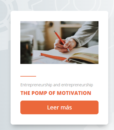

this will work and shows the fields and the content inside the edito but in the front end didn't work
let you also a picture of the buttn text i need to translate and didn't wok the xml method ... what i'm doing wrong?
also this divi engine module it is inside of a loop so i built in with divi library this custom layout.

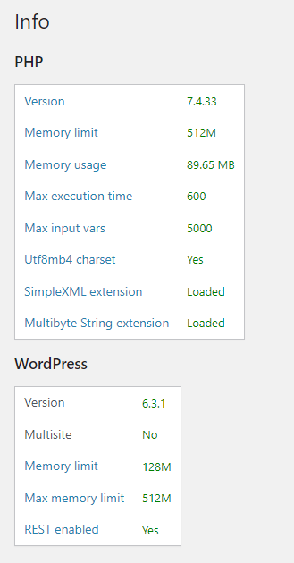

the shortcode itself is correct. If not you would not see it on the editor. Can you please add me your WPML debug info? I want to check if your installation has enough memory assigned.
Please also ensure the translation is not in progress and you see the "pencil" icon as status.

let you some of my wpml configs, and this error 49 times in the wpml logs
