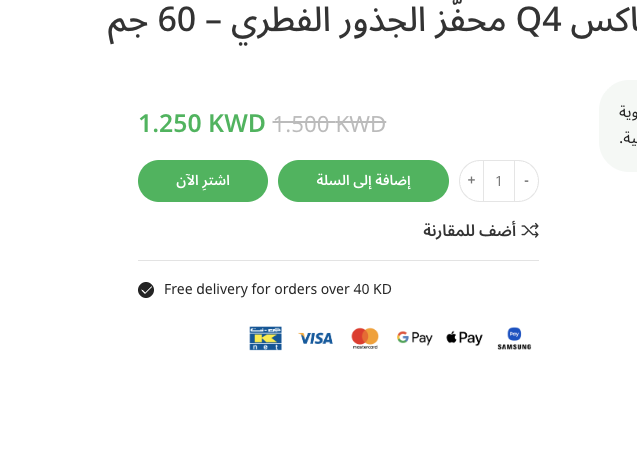

Christopher Amirian WPML Supporter since 07/2020
Languages: English (English ) Timezone: Asia/Yerevan (GMT+04:00) |
Hello and welcome to WPML support. According to the screenshot you shared am I correct to assume that you want to translate: Free delivery for orders over 4KD If yes, please follow the steps below: - Go to WordPress Dashboard > WPML > Strin Translation. Also would you please provide the debug information so I can understand how your website is setup? https://wpml.org/faq/provide-debug-information-faster-support/ Thanks. |

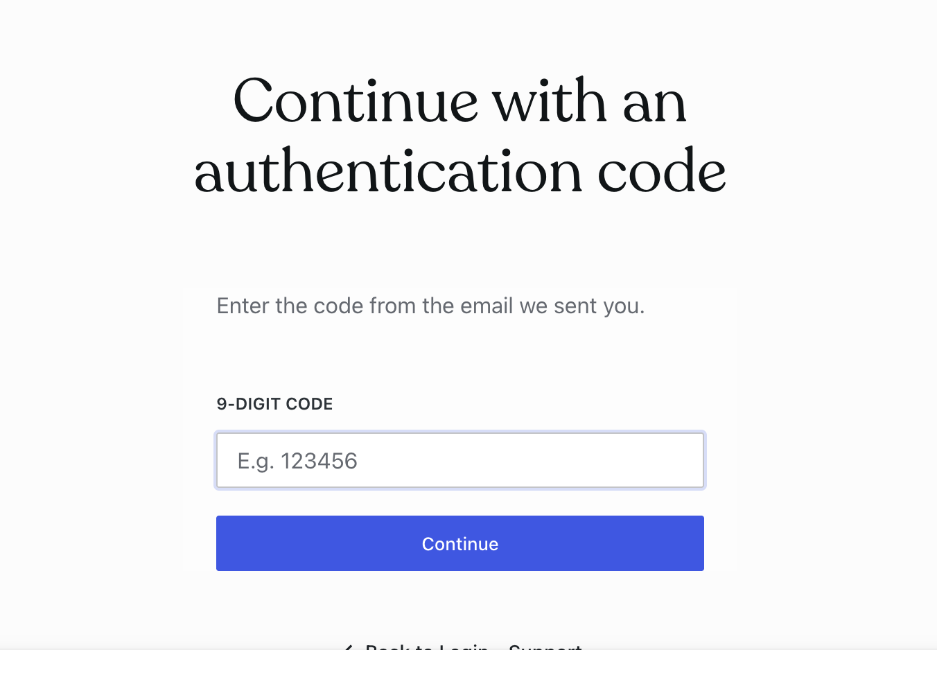

Hello and thank you for the information. Unfortunately, the login information for the WordPress dashboard in wordpress.com is not working and the username pass is wrong. Would you please set the next reply a sprivate and give the correct login information? But the FTP information worked and I managed to find the error log and the issue seems to be related to a timezone: PHP Fatal error: Uncaught DateInvalidTimeZoneException: DateTimeZone::__construct(): Unknown or bad timezone (آسيا/الكويت) in /wordpress/core/6.9.1/wp-includes/script-loader.php:414 It seems that Asia/Kwait is translated in the wrong place. I will need the login information to be able to go to WordPress Dashboard > WPML > String translation and search for that timezone and make sure it is a copy of the timezone in English and not an Arabic translation. I think that should fix the fatal error in Arabic and then I can address the shoping cart string translation. Thanks. |
| February 16, 2026 at 7:42 am #17824428 | |
Thank you. I entered and now it needs me to enter a 9 digit number. Please check the screenshot attached |

| February 16, 2026 at 8:17 am #17824563 | |
I used that number but unfortunately, it did not work (screenshot). I requested again. May I have the number? You can send it to christopher.a@onthegosystems.com |
