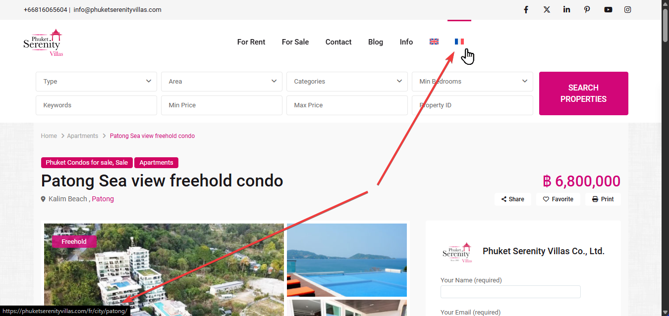

I believe there might be a misunderstanding regarding the issue we are currently facing. The problem is that the flags in the navigation menu are no longer synchronizing correctly. When visiting most pages and clicking on the flag for another language, it redirects to a random page in that language instead of the correct translation.
As an example, you can test any of the submenu pages under "For Rent" or "For Sale" and try switching the language. You will notice that it redirects you to a random property instead of the equivalent list.

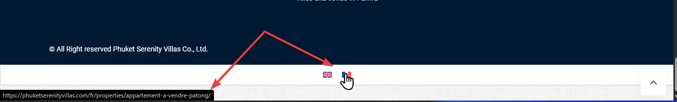

Thank you for your patience. While preparing the report, I noticed that the language switchers function correctly when the footer language switcher is enabled. You can test it here: hidden link (scroll to the bottom to see the language switcher)
Could you please let me know where the navigation menu language switchers were added? I'm unable to inspect or edit them on my end.

Indeed the switcher in footer menu seems to work correctly. I added the switcher again the navigation menu and it doesn't work well while the footer one does !!!
You can check it out on this example here:
Can it be a caching issue?

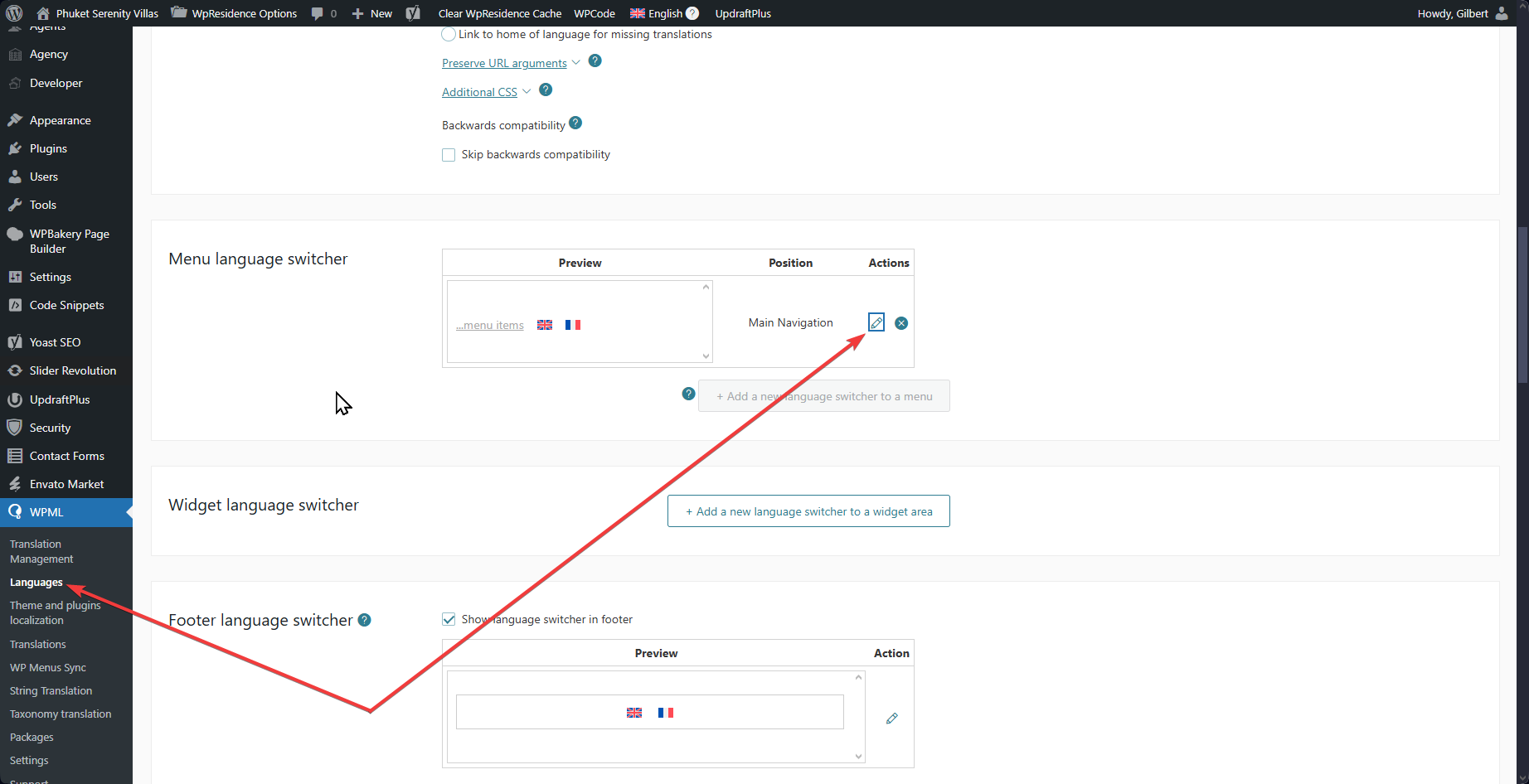

Thanks for your reply. Could you tell me where you added the language switcher?
I tried making adjustments in WPML > Languages > Menu language switcher, and it's not affecting the frontend.

I just go to the WPML / Languages and edit the Menu Language Switcher.
I just deleted and added the menu, and it's working. However, I noticed that the first page you visit will have the correct translation, but from there on, the link will remain the same as the first page. Could this be a caching issue?

I've tried editing the language switcher shown in your attached screenshot, and the changes did not take effect. Not sure how it worked for you.
Which link are you referring to? You mentioned cache, could you try using another browser and see if it works for you?

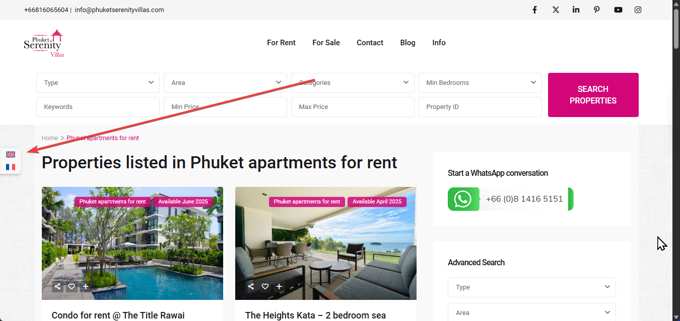

So to fix this issue, I decided to remove the footer and navigation menu switcher and just add a custom floating one to the left side of the website which worked now and it is translating correctly.
We can close this ticket now.
