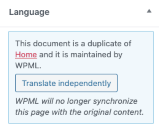

If you have duplicated posts earlier, they may have the duplicate status. You need to ensure they do not have this status before updating the original language post or importing translations.
There are two ways to address this:
1) Edit the duplicated post and select the "Translate independently" button. This will prevent the post from automatically syncing with the default language content. https://wpml.org/documentation/translating-your-contents/displaying-untranslated-content-on-pages-in-secondary-languages/#how-to-convert-a-translation-into-a-duplicate
2) Alternatively, you can delete an entry in the wp_postmeta database with the key _icl_lang_duplicate_of for the duplicated post.
I hope this information is helpful.
