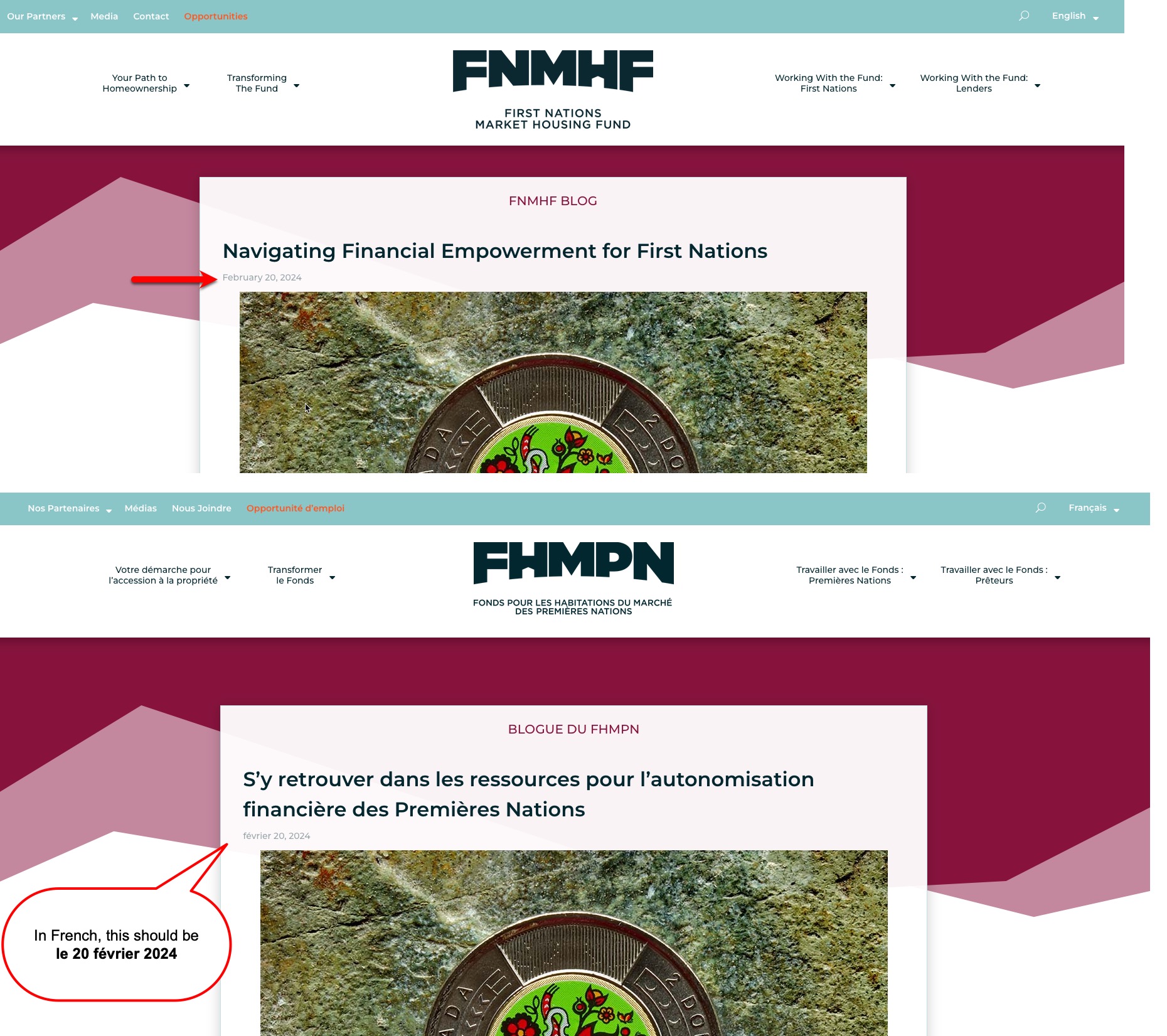

Hi - I'm trying to find where I can update the format of the date for French. In the screenshot below, it explains how the date should be shown in French:
English: February 20, 2024
French: le 20 février 2024
This is the post: hidden link
I tried to update the admin strings but this didn't do anything (screenshot #2). Can you please help?

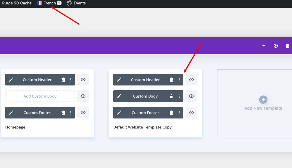

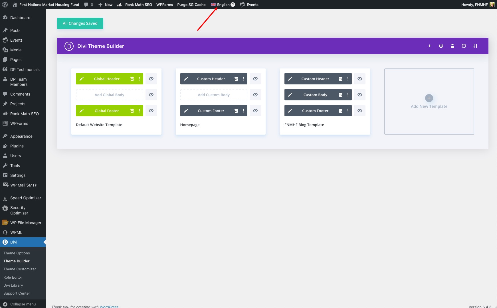

Ah! THAT's where I needed to modify the date format - in the divi widget for "Title". I updated the format - any way to add "le" in front of the date?
As an fyi, I don't have the option to open the translator in Divi builder (see screenshot 1)...I had to by click on "showing content in: French" then build the template (screenshot 2).

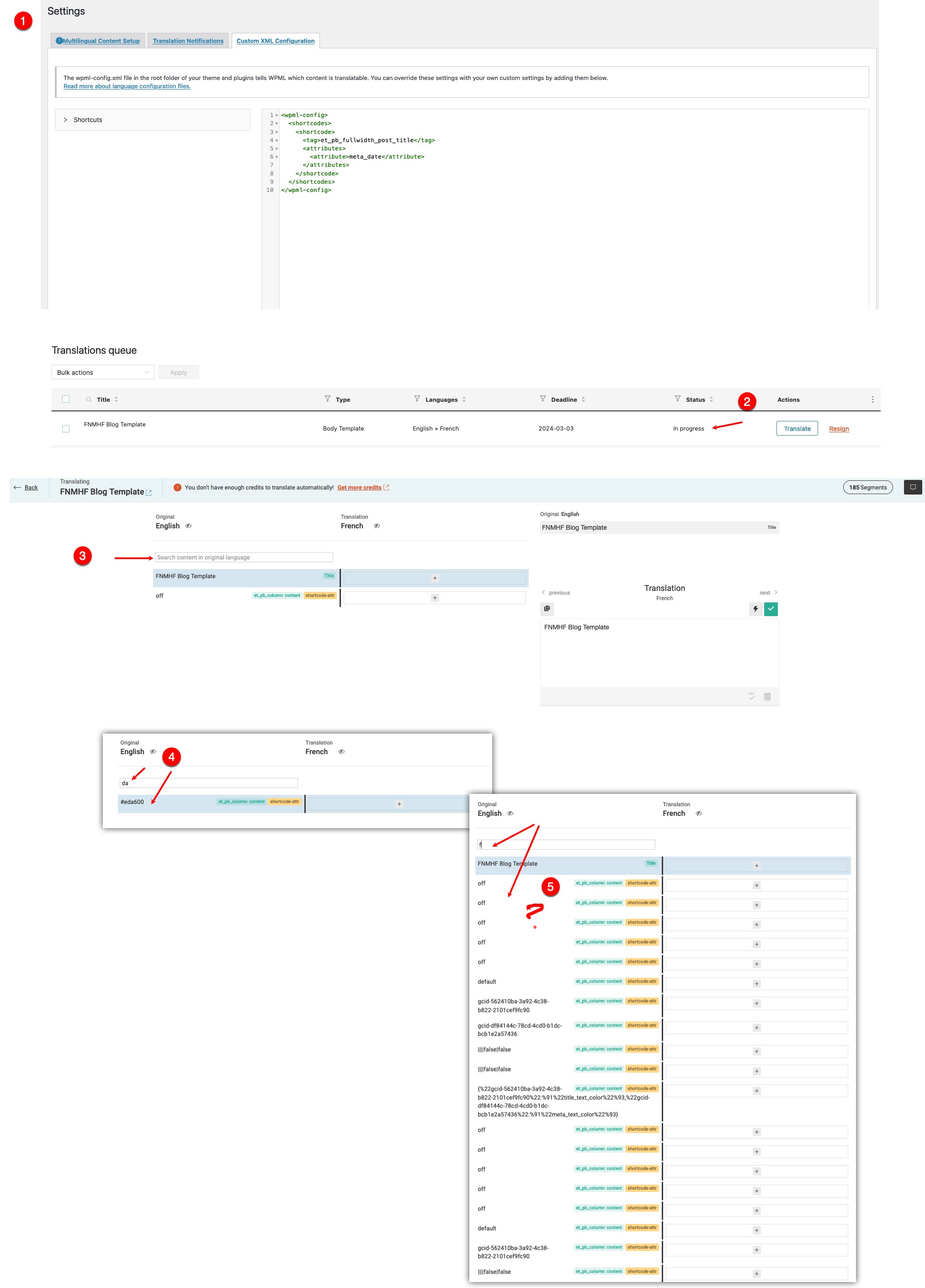

Please add the following XML markup to WPML > Settings > Custom XML Configruation:
<wpml-config>
  <shortcodes>
    <shortcode>
      <tag>et_pb_fullwidth_post_title</tag>
      <attributes>
        <attribute>meta_date</attribute>
      </attributes>
    </shortcode>
  </shortcodes>
</wpml-config>
Now, edit the post title widget on your custom body template by adding a blank space behind the date format. Save the template.
Go to WPML Translation Management and create a job for the template, then translate it at WPML > Translations.
The date format will not show up right away. You will need to use the text search field on the top left and search it, then translate it.
See screenshot.
Please give this a test and let me know if this worked out.
If so, then I will escalate the issue to our compatibility team, so that they will update the config for Divi.

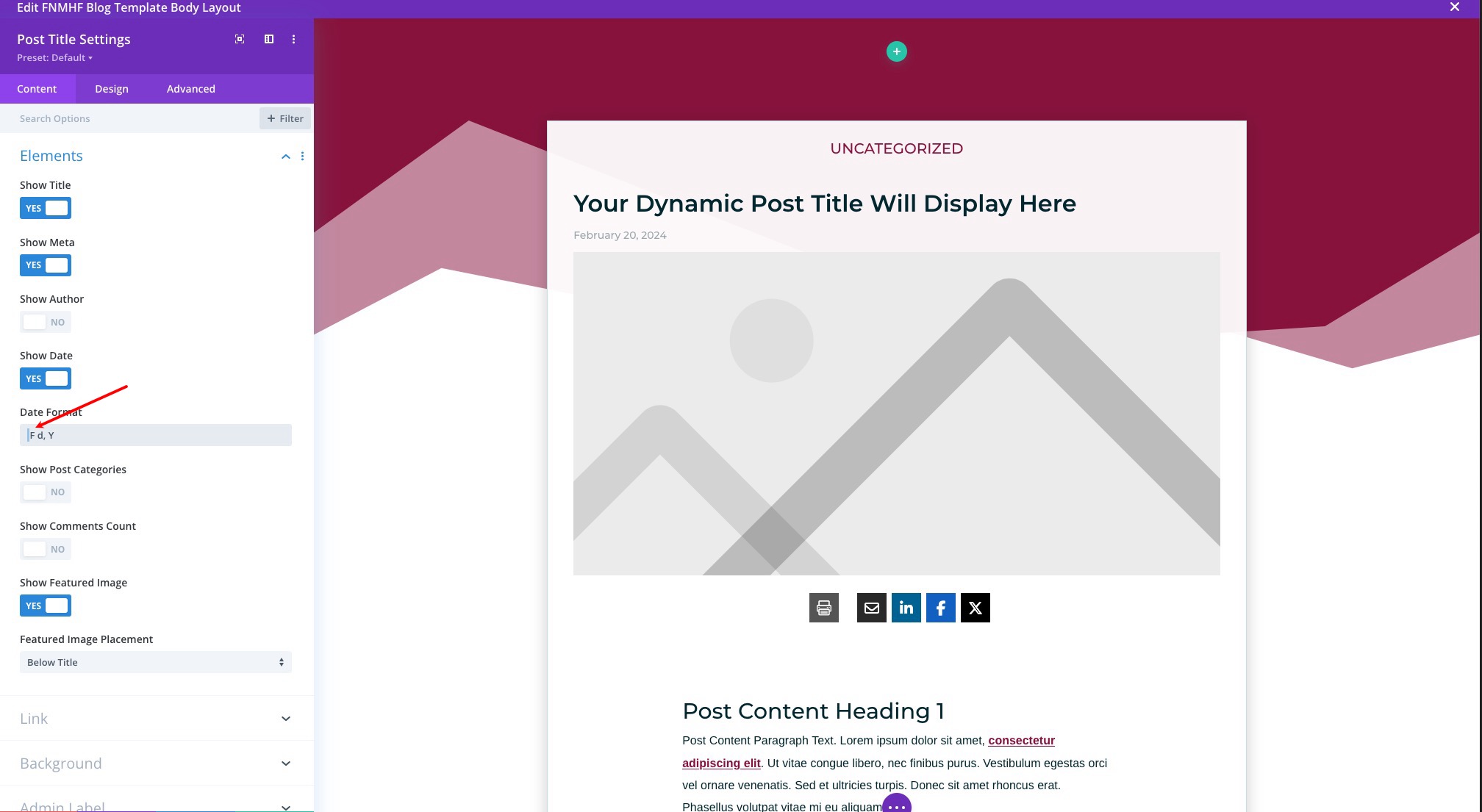

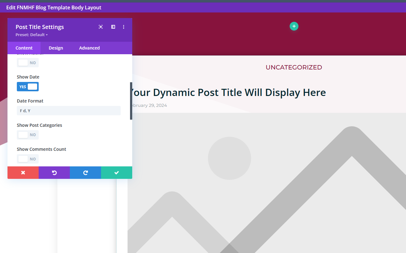

hmmmm...okay, in screenshot #3, I've inserted the space in module in the body template.
In screenshot #4:
- it shows that the custom xml code is added as per instructions (1)
- I've put the body template to translation queue (2)
- then clicked on translate to open the advanced translation (3).
I'm not sure what to put in that field to search for the date? I've tried "d" and "f" (4) and I'm not sure what I should be looking for here but I don't see anything familiar...
Could you please explain that part?
Thank you!

Please edit the original custom body template in Divi and make a small edit to the date format field of your Post Title Blog.
See screenshot.

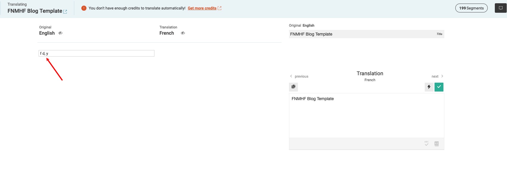

I'm sorry but now I'm confused...in your response dated Feb. 29 @ 5:36pm, you mentioned
"Now, edit the post title widget on your custom body template by adding a blank space behind the date format. Save the template."
Isn't this what I was supposed to do per my screenshot #3?
I have figured out the right format for French but would like to add the article "le" in front of the date:
When I search for "F d,Y" - nothing comes up (screenshot #5)...by the way, the search bar doesn't seem to allow capital letters...
I appreciate your help.

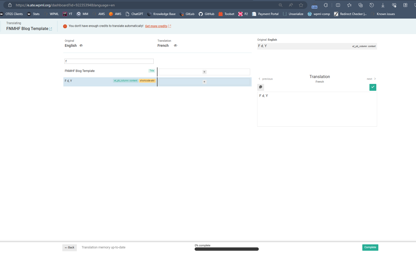

March 1, 2024 at 8:07 pm #15364790
My apologies.
Search for the letter "f" should be sufficient.
See screenshot.
Also, take note that there are two custom body templates registered in Translation Management. I translated now the untranslated one, which had the date format available.
Seems you were translating the wrong template.
Take note, that you can not use "le" inside this date format, as those letters are reserved for the format.
"le" inside the date format will print:
"mardiAmerica/Toronto"
The other template seems to be not the one from your blog page.
