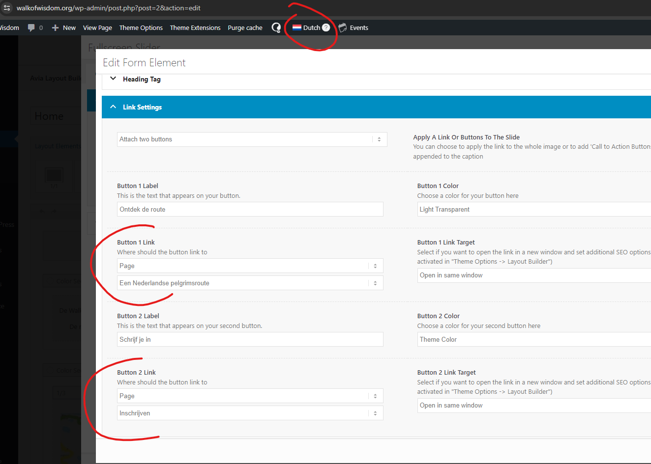

We'd like to update the link targets in the two buttons in the top slider element on hidden link. Whereas the original language contains links to two different pages, the href in the DE translation is empty (href="").
I have followed instructions on https://wpml.org/announcements/2020/02/translating-links-with-advanced-translation-editor/, and could find one of the two links in the advanced translation editor. However, changing these has no effect on the live site. Notably, the second link (hidden link) is missing from the editor (also when searching for http or other strings from the url).
See attached for the link settings in the Enfold fullscreen slider.

2) Can you tell me how are you adding those text buttons on the slider (you can share a video if that makes it easier, you can use loom.com / monosnap.com and share the link with me)?
Thanks,
Marsel
March 18, 2024 at 3:00 pm #15421976
Ivan Beemster
Hi Marsel,
1) I cleaned frontend cache, there is no caching happening on the backend.
2) Sure, see hidden link.

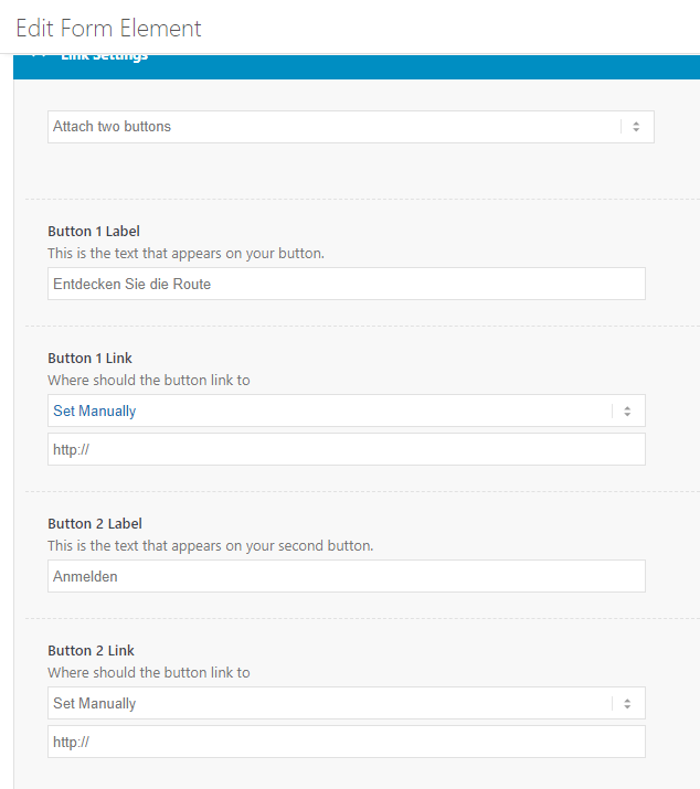

I checked the German version by checking the buttons as shown in the video you shared, they were set to "Set manually" (as you can see in the images attached), different from the English version where the button links are set to "Page".
I added the correct links for both buttons in German (set manually), they should be ok now.

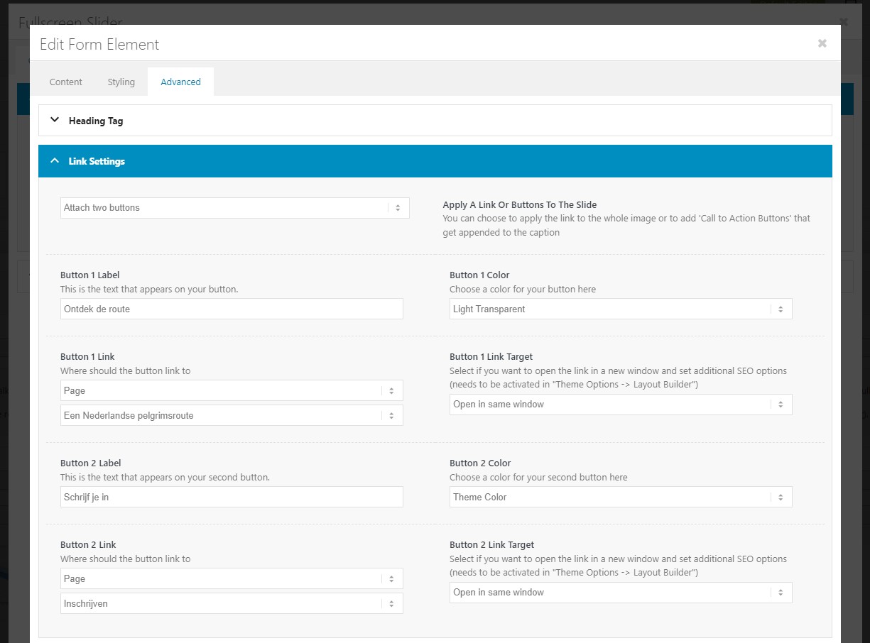

Can you please try setting the pages on the German version for the links as they are already set on the Deutch version (please check the attached image to better understand what I am referring to)?
Let me know if the issue persists.
March 21, 2024 at 4:15 pm #15437412
Ivan Beemster
Hi Marsel,
Yes, if I set the links directly on the German version in the Enfold editor, it also shows correctly on the frontend. However, when I change the Dutch original, the German translation is overwritten en both links refer to self again.
