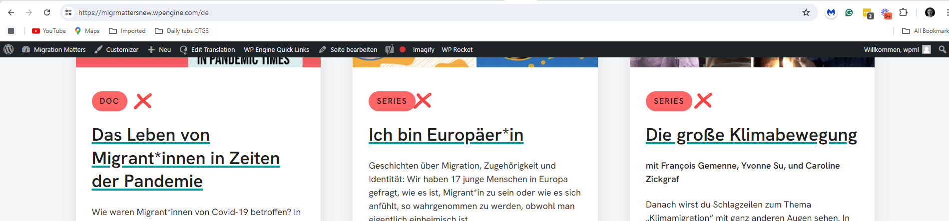

I've also tried setting wpml_cf_preferences to 3, and even 2. If I set it to 2, the value of the radio button shows to be translated (series, course, doc, mooc) and not the label. And that is what is showing up on the site (in English) on the translated page. The strings do appear in String Translation and have been translated but the label doesn't show.
The labels of the radio buttons are not displaying the translated text on the site; only the values are being translated.
How can I get the translated labels to display instead of the values?

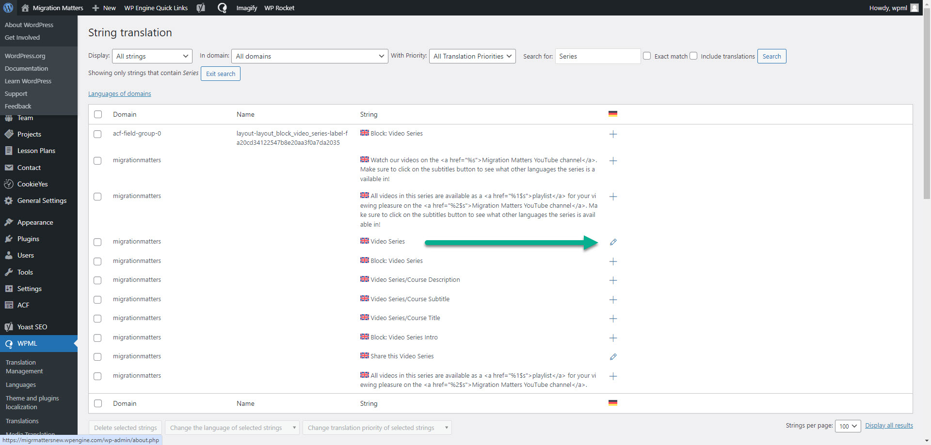

I can see the problem on your site. Please see the attached screenshot problem-on-the-front-end.jpg. However, I'm wondering why only DOC is shown for the left button, and for the two other buttons, only SERIES is shown. This inconsistency does not make sense to me. You said that you translated it in Strings Translation. But there, I only see "Video Series" translated. I don't see "Documentary Series" translated. Please see the attached screenshot video-series-trans.jpg. I wonder where the translation of "Documentary Series" is?

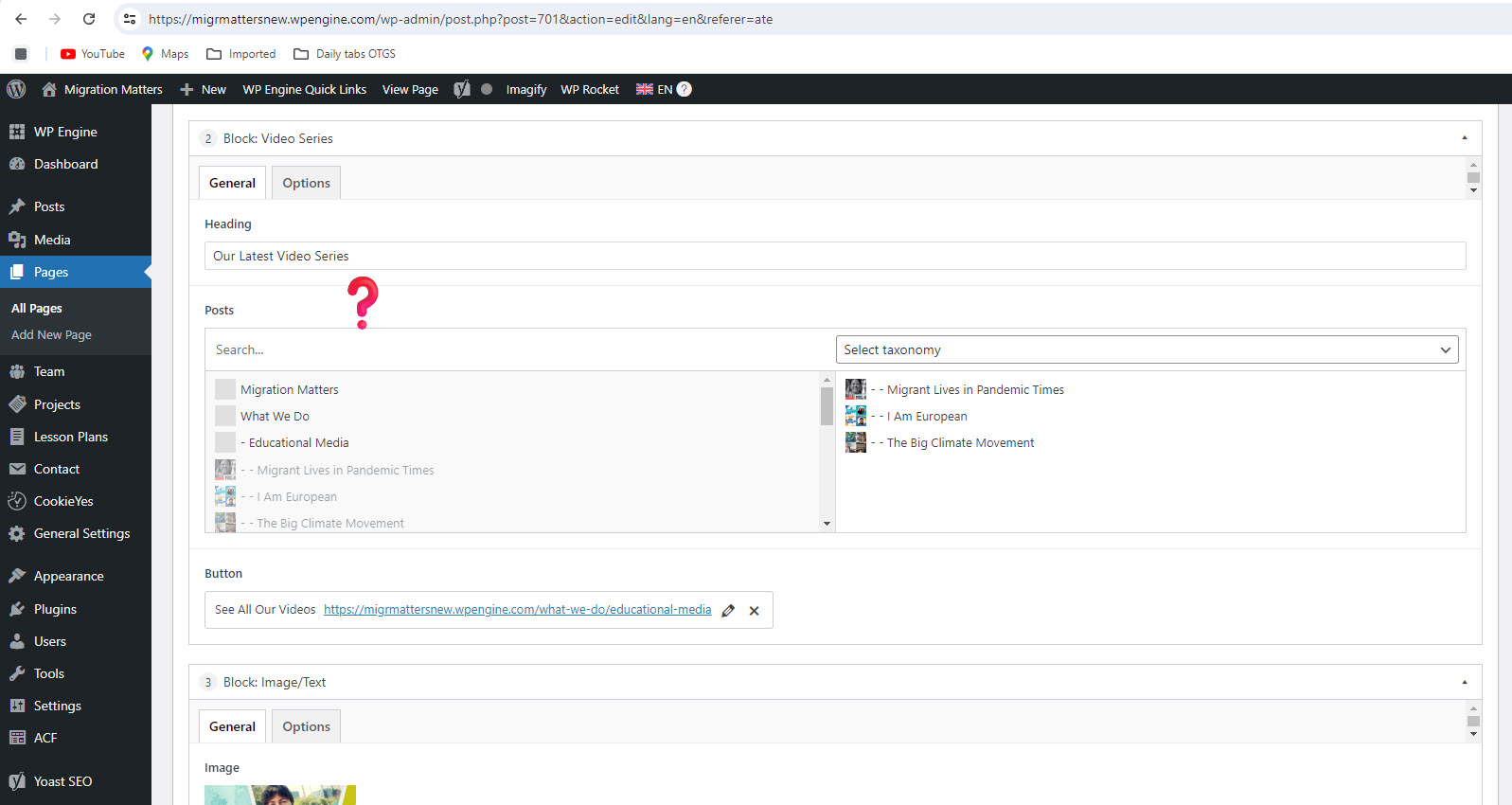

I can see the "Our Latest Video Series" section when I edit the homepage (hidden link). Please see the attached screenshot Our Latest Video Series.jpg. But I don't understand how you present the buttons on the front end. Or in other words, how did you design the layout of the front end, and where is it possible to edit it?

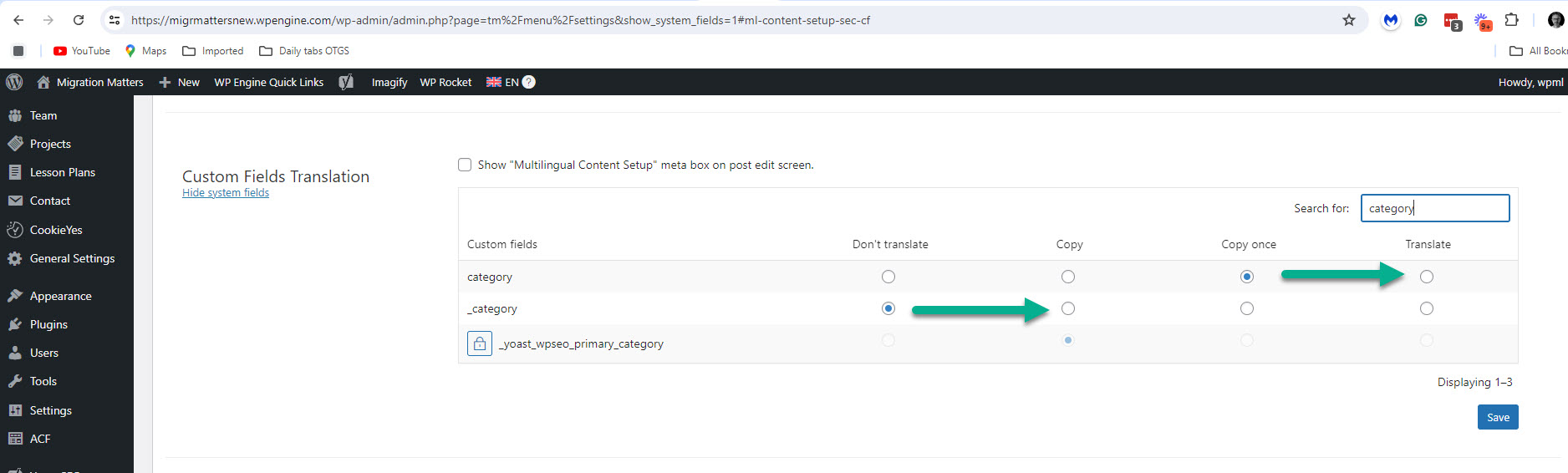

I'm asking because I'm not 100% familiar with creating ACF fields the way you created them. In WPML -> Settings -> Custom Field translation, I changed the translation settings of "category" as shown in the category-field-settings.jpg screenshot. But this does not seem to help.

That is not an inconsistency. This is a category. The first video is in the "Documentary Series" category (slug=doc) and the second two are in the Video Series category (slug=video). The problem is not in the difference, it is that it shows the slug and not the actual name.
Documentary Series was translated on the live site but maybe it wasn't at the point which I recloned this site to staging. I have since rescanned the theme for strings and translated it. Nothing changes.

The relationship field just pulls in pages. The relationship field is called "cards". I then use the post_object to get the page information:
foreach ($cards as $post_id) :
$post_object = get_post($post_id);
setup_postdata($GLOBALS['post'] = &$post_object);
$category = get_field('category');
The $category is this button and just grabbed from the custom field category that is part of the page.
You can find this in the theme under here: /inc/acf/render/blocks/block-video-series.php
