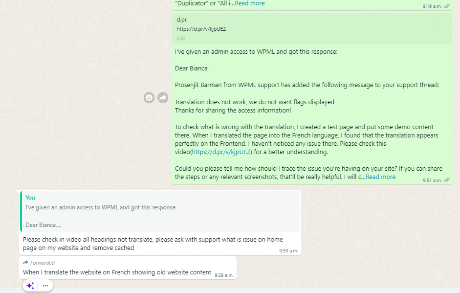

Thank you very much for the video explanation. It also would help if you show us how to change the flags to Canadian and Acadian.
Please also see message from my developer (screenshot).
For us, it is not translating the content and it is showing old website content instead.
Is it that only translation is 'going forward' as those pages were created prior to installation of plugin? The other plugin we tried had no issues translating.
