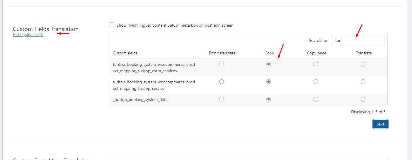

I checked and can see an issue with calendar not showing on 2nd language.
I have gone to WPML > Settings > Custom Fields Translation > Show system fields > Search for turitop and set them to COPY.
Please note this plugin is not officially compatible with WPML so some issues may happen. I advise further checking with the plugin author on WPML compatibility and if they need our help to join our GoGlobal program and we will be glad to help them in making their product WPML compatible.
