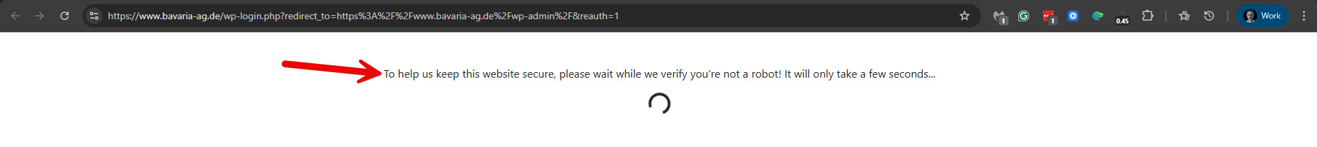

However, before approving this, please check whether there are any security measures on your site. I remember you said there are no such measures, but when I try to log into your site, I see this. Please see the attached screenshot. Is it possible for you to temporarily disable this feature and see if you can register the site?

In addition to what I wrote above about the security measure I mentioned, our second-tier supporter said that this might indeed be because the site is passing through Cloudflare, so it would be a good idea to purge Cloudflare's cache or disable it and recheck.
