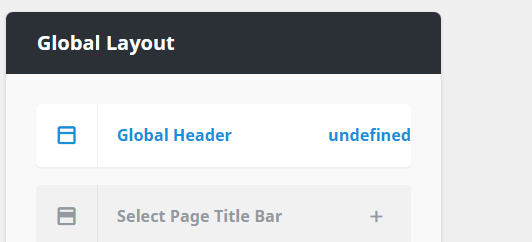

January 14, 2024 at 2:11 am #15181852
khaledo
I've observed that an "undefined" message appears next to any layout I create in the Avada Layout Builder. Initially, I was unsure about the cause. Upon researching on Google, I came across a post where someone reported encountering the same issue. The suggestion was to disable the WPML plugin, and upon following this advice, the issue disappeared. I can confirm that the problem is associated with the WPML plugin.

January 30, 2024 at 2:22 pm #15244300
Prosenjit Barman
WPML Supporter since 03/2023
Hello There,
Thank you for updating the PHP version.
I've thoroughly checked and would like to inform you that the issue is solved now. It was happening due to enabling the Avada Frontend Builder as the default builder. This configuration prevented WPML from recognizing the IDs assigned to each layout section within the Layout and led to the appearance of 'undefined' notices.
I went to "Avada > Options > Builder Options" and changed the "Builder Auto Activation" to OFF, which enabled the WordPress Editor view and solved the issue.
Please let me know if there is anything else you need help with. I will be happy to help.
Prosenjit
February 3, 2024 at 5:15 pm #15262530
khaledo
Thanks for support it did fix and the issue didn't show anymore
