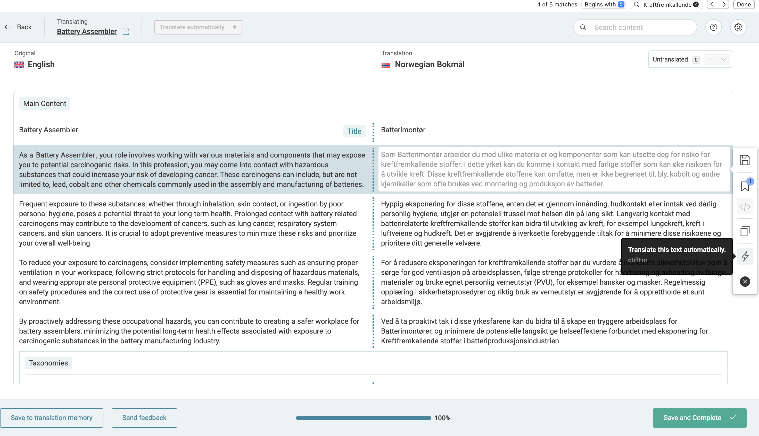

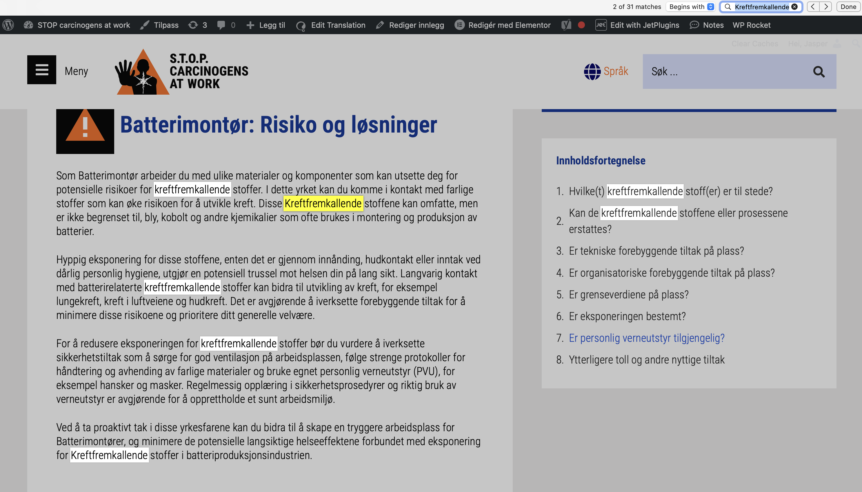

During the checking of our Norwegian language we found that a word we use very often (500+) is often capitalized mid sentence.
I first checked if we used that word in our glossary, and this was the case. In the glossary the word was capitalized. I changed this because I thought this might deliver confusion with the (soon disappearing) 'name' column.
After that I had the system scan for updates. WPML went to work and found a lot of changes, including languages I did not change recently. What it did it a block box for me, so I am hoping nothing broke.
The whole process took about 24 hours to complete. However when I checked the original issue was still there.
I switched to manual and openend every occurrence in the ATE editor. I did not manually change the word but used automatic translation within the ATE editor. When I do this it correctly changes the capitalization of the word.
My question is why it does work correctly when using the ATE automatic translations. But not when I have the glossary scan? Or is this ignored and should I have retranslated the posts?
As mentioned earlier. I fixed this but I am trying to understand. I this is a issue you would like to investigate, I can give you a staging with a earlier backup.
