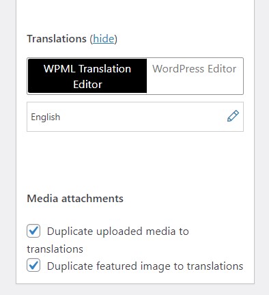

There is only one issue remaining: not all products have the images in the translated products. For example: hidden link Is there a way to get this done in bulk?
November 27, 2023 at 12:31 pm #14929761
Alejandro
WPML Supporter since 02/2018
Yes, there should be.
Go to WPML > Settings > Media Translation and click both buttons "apply" and "start" so it applies this to new and old content alike. that should do it.
If it still doesn't work, try to resend the page to translate and i should apply it.
What you're doing with the process i mentioned is setting the "media attachment" option found on every page (screenshot attached), selected by default which is likely the reason why you are missing images in some places.
Regards.
