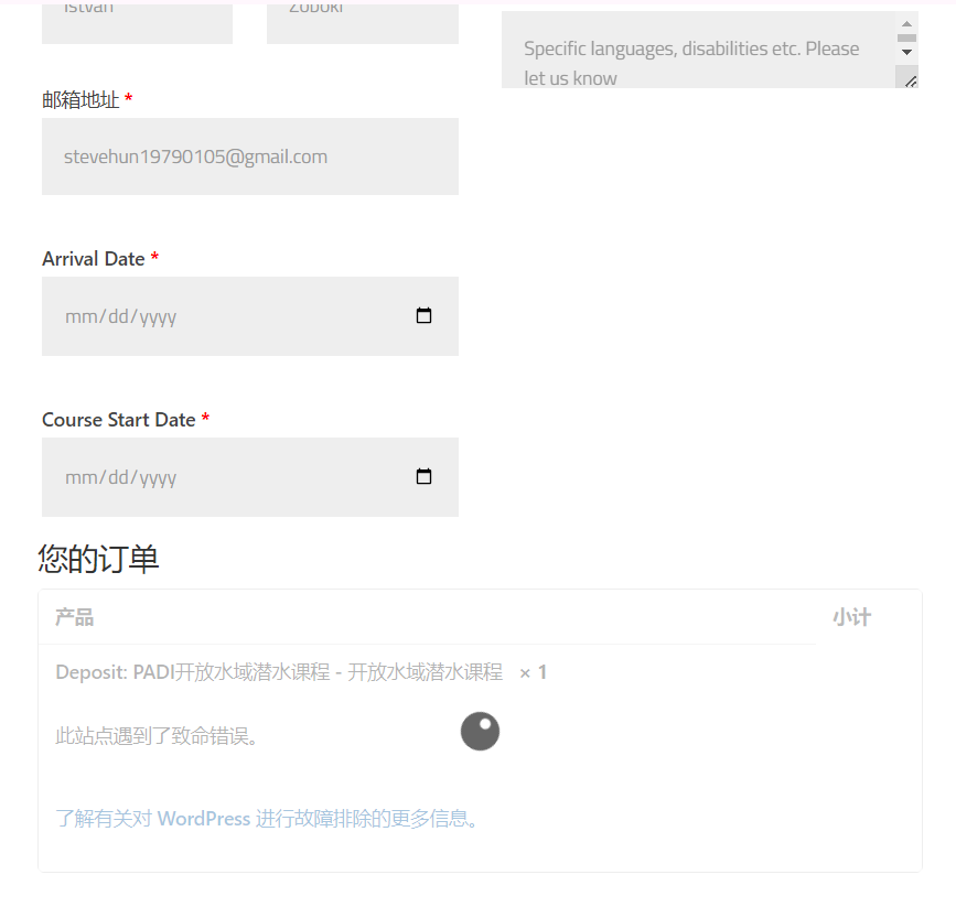

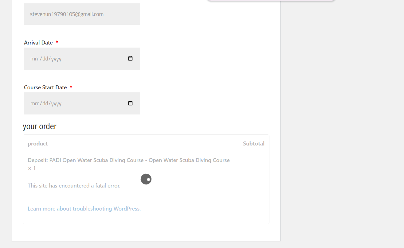

Some of the other issues we have.
1. If you book one product and you are redirected to the check-in page, the page stops working. This only happens with the translated pages.
See pic 1 and 2.

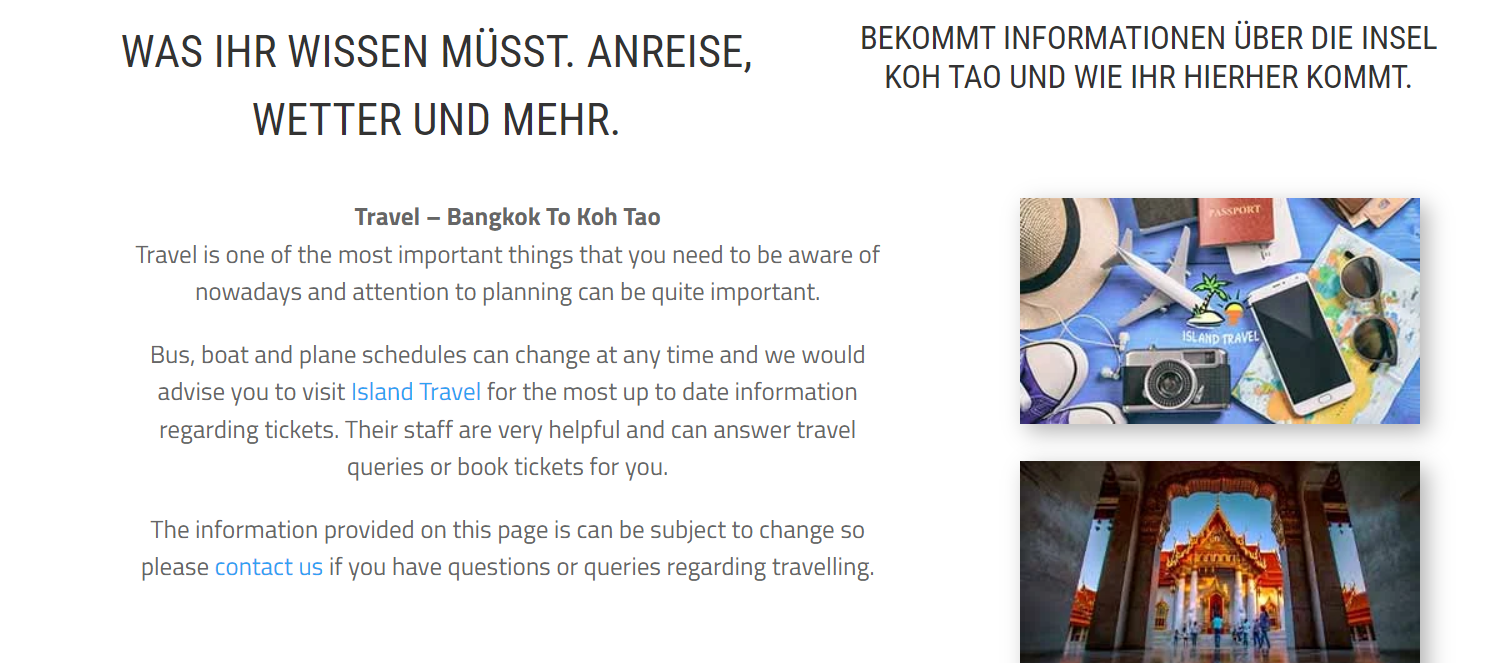

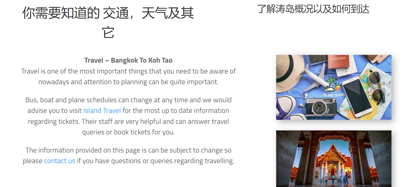

2. Text and links are not updating on some of the pages, as an example see pic 3,4 and 5
Link to the page: hidden link
