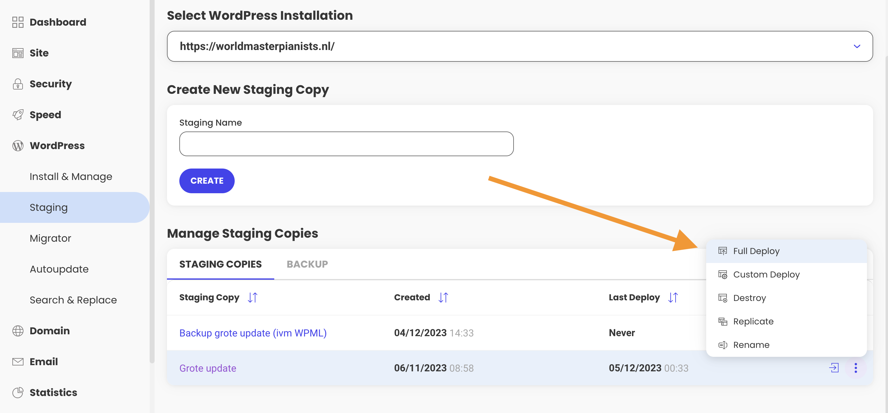

Hi Kor, I just tried to push staging 13 (the copy we've been working on) live, and immediately all of the old issues -the ones we just spent weeks repairing- popped up again... I've had to restore a backup. It is really unworkable this way. I can't have a perfectly working staging copy break upon pushing to the live website..

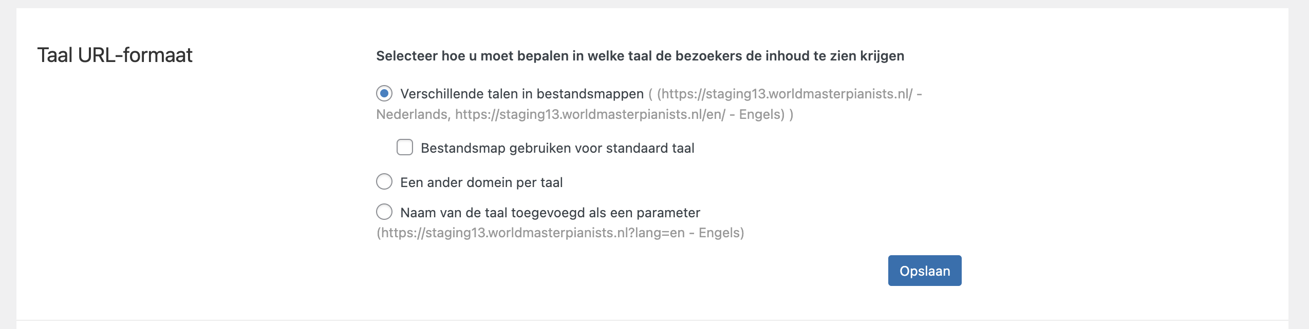

Hi! It's around midnight, so I've done some testing to narrow down the issue while everyone is asleep. It seems that the issue is not related to moving the site ground staging to live after all. It looks perfect right after the migration. Rather, the pages break only after switching from translations on different directories (worlmasterpianists.nl/en) to using different domains. My original language is on worldmasterpianists.nl and the English translation should be on worldmasterpianists.com. Please advise 🙂

Hi Kor, I can't really show you on a live website... I did this VERY quickly in the middle of the night, so hopefully I avoided visitor traffic. On the staging copy I don't have a .com available. I have asked Siteground for assistance, but it is not possible to use different domains since the staging websites come with a specific server configuration that cannot be changed or modified.
The only way I would be willing to do it on the live is if we do it around 1AM Amsterdam time... But it would be better if you downloaded the site and tried to reproduce it on your end.

Certainly. I pushed the website live (full deploy). Website looked perfect with the directory /en for english. Then I went into the WPML settings to set the english translation to the .com. After that old the old issues were back (screenshots from previous message)

Are you saying that you used the "A different domain per language" option as explained here? https://wpml.org/documentation/getting-started-guide/language-setup/language-url-options/

I don't want to set up the name to parameters though. It has to be set to different domains. I did this last night (after migration to live) and things broke (see screenshots)

Here's what I did last night:
1. pushed staging13 to live
2. checked the translated pages, they looked good
3. changed the URL structure from "Different languages in directories" to "Different domain per language"
4. checked the translated pages again. They were broken.
