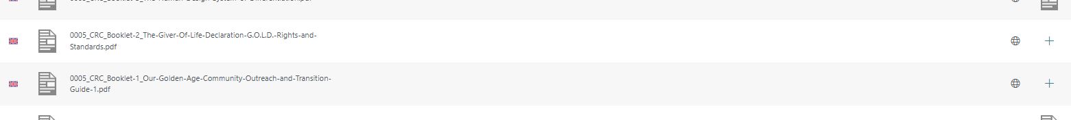

November 4, 2025 at 11:15 pm #17547871
sachaJ
Hi Andreas,
New media are still being blocked, Is there a way to circumvent that OR do I need to wait a few hours for it to load properly?
November 5, 2025 at 12:11 am #17547931
Thank you for reaching out again! It seems this issue is more complex than I first thought.
This appears to be a JavaScript conflict between the SiteGround Speed Optimization plugin and WPML. The error seems to occur on WPML's media translation dialog popup, which will not open if a translation does not exist.
We might only be able to debug this issue if you can provide access to a staging site hosted on SiteGround, together with its optimization plugins.
Would you be able to provide access to such a staging site, or am I able to make changes on the site that I currently can access?
Does this only happen for .webp files?
November 5, 2025 at 12:18 am #17547933
sachaJ
Hi Andreas,
I just checked again before providing you with access and it worked now!
I guess it needed time to register!
Thank you for reaching out so quickly 🙂

Regarding the media translation issue:
There does occur a JavaScript issue, and I suspect it is coming from the SiteGround optimizer plugins. Do not hesitate to ask them if they have an issue, what might be causing the issue.
What I did, is that I added the page of WPML > Media Translation to the cache exclusion list of this Siteground cache. I am not sure if this might be the reason why it is working now, so please reach out if the issue occurs again or if SiteGround can not propose a solution.

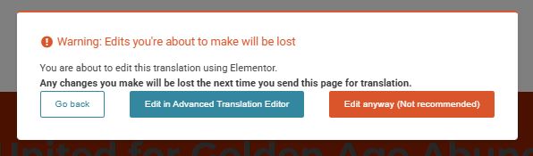

November 5, 2025 at 5:41 pm #17551456
sachaJ
HI Andreas<
In order to have the correct language flipbook, I am NOW considering breaking the languages.
What will happen to my approved translations?
What can the "Advanced Translation Editor" do to help me?
Attached the image of the prompt that I am NOW considering since I am getting NOWHERE with the Flipbook author
November 5, 2025 at 7:10 pm #17551639
The alternative would be to translate using the WordPress Editor, but to do so, you should switch the translation method on the original content.
Guide:
This option can be found on the right sidebar when editing the original content inside the WordPress Editor.
The problem here is, if you edit translations inside the WordPress Editor while having the WPML Translation Editor or Translation Dashboard set as the translation method, then your manual edits taken on the WordPress Editor will be overwritten.
This is why you receive the warning dialog in your screenshot.
Further, I do personally not have an issue in investigating the 3D Flipbook issues and propose fixes that will make the plugin work with the WPML Translation Editor or automatic translation, but this effort will only make sense if the author of the plugin is cooperative and applies the suggested changes to the plugin.
If the author is not cooperative, any work that could be done from our end will be fruitless, as it is the third plugin that will need to implement compatibility code for WPML, and not WPML's code that needs adjustment.
Could you please clarify this with the author before we take any further steps?
