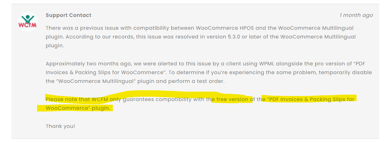

Actually, the invoice, that the customer is receiving is the wrong one.
Attached I am also sending a screenshot, where the WCFM support says that they are compatible only with the free version of the invoice Plugin.

You are facing a compatibility issue between three different plugins (from different authors). WooCommerce Multilingual & Multicurrency (our plugin), PDF Invoices & Packing Slips for WooCommerce by WP Overnight, and WCFM - WooCommerce Frontend Manager by WC Lovers.
WPML is compatible with both plugins, with one exception: the free version of PDF Invoices & Packing Slips for WooCommerce. This means that WPML is compatible only with the premium version, WooCommerce PDF Invoices & Packing Slips Professional. This decision to only be compatible with the Professional version was made by the authors, WP Overnight, and not by us. What makes things confusing, and this is what the support of WCFM told you, is that they are only compatible with the free version of WooCommerce PDF Invoices & Packing Slips. (This might be the cause of the conflict.) To fully understand how to work with WCFM and WPML, you must read the following guides. Our guide:
https://wpml.org/documentation/plugins-compatibility/building-multilingual-multi-vendor-marketplace-sites-using-wcfm-plugins-and-wpml/
And their guide that extends explanations about using the Pro version:
The problem stems from the WCFM plugin. We tried to help the best we could from our side and provided a workaround. It is unclear to us. Did you try our workaround and check if it helps? Have you tried contacting WCFM about this issue? Your screenshot of the support thread with them indicates it is from one month ago. A lot of information about this case has been added since then. Maybe they can also try to help with this.
