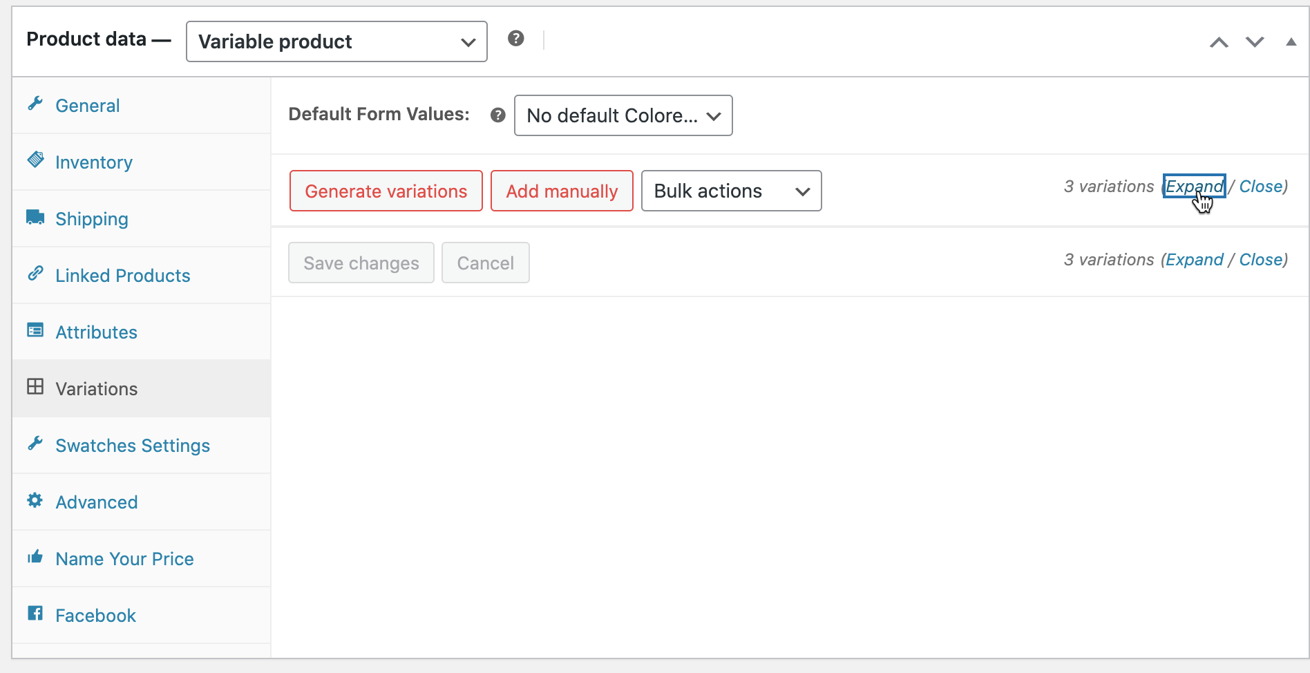

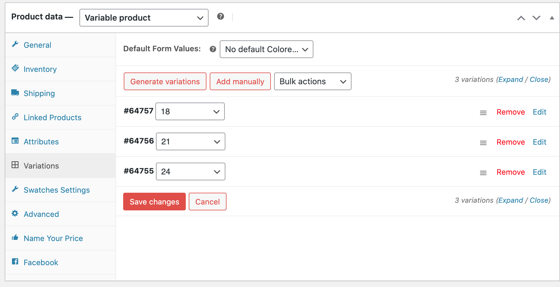

Hi, following the advise to do the updates, all plugins and WordPress have been updated.
This is being tested on staging, if you need access to I will provide it. The product:
it is a variable product, I try adding some variations as you see from the first screenshot, as soon as the save button is clicked they disappear, as from screenshot 2
the product in the front end does not show any variation available, therefore the product looks out of stock, the back end says "3 variations" but clicking on the Expand link does not show them
