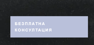

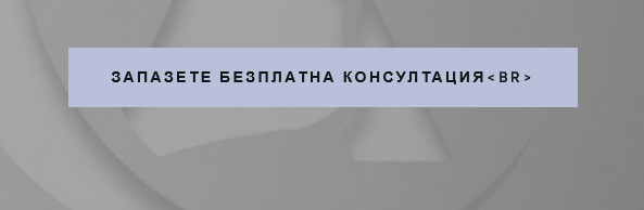

There are some other issues.
1. How do I modify where there is some sort of visual bug? Where from can I modify the button for example if it doesn't load.
In one of the buttons the test is on the left and we want to center it
The second has an additional <br>
I am attaching all the screenshots
I wonder where from can I modify the elements of the translated version so it looks good.

January 21, 2026 at 3:20 am #17748725
Shekhar Bhandari
WPML Supporter since 03/2015
Hello there,
I see bg version is now available, for the <br> tag I edited the translations from here: hidden link by clicking the pencil icon and it fixed the issue.

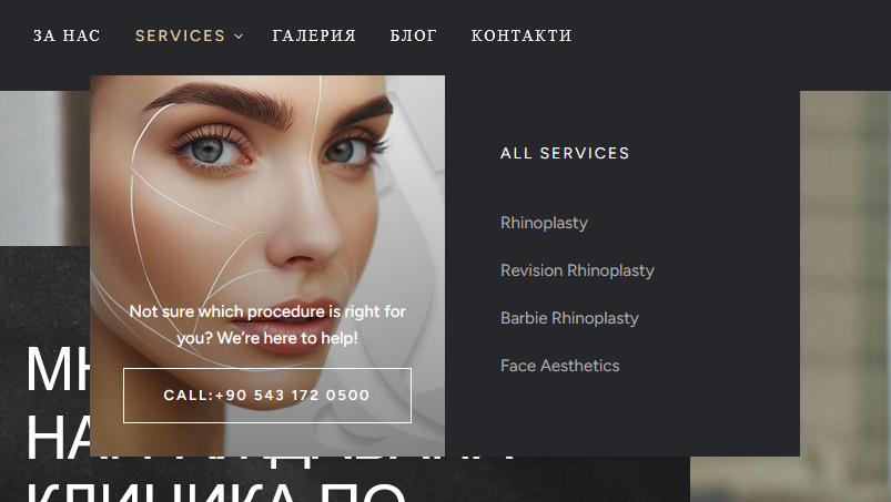

January 21, 2026 at 11:16 am #17750062
borislavV-2
Also this submenu. I can't find it as well.
January 21, 2026 at 1:19 pm #17750401
Shekhar Bhandari
Hello there,
To translate the menu follow the steps as mentioned here: https://wpml.org/documentation/getting-started-guide/translating-menus/
