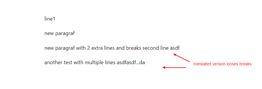

Hi Nigel,
Thanks for your attention.

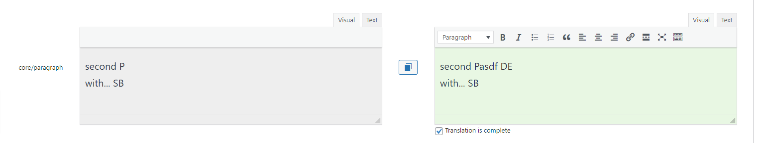

I am using the wpml editor, in picture 1 you can see the 2 languages.
In picture 2 you can see that the breaks are gone.
This is a problem that has been bothering me for several years, I am curious if anyone else has this problem.

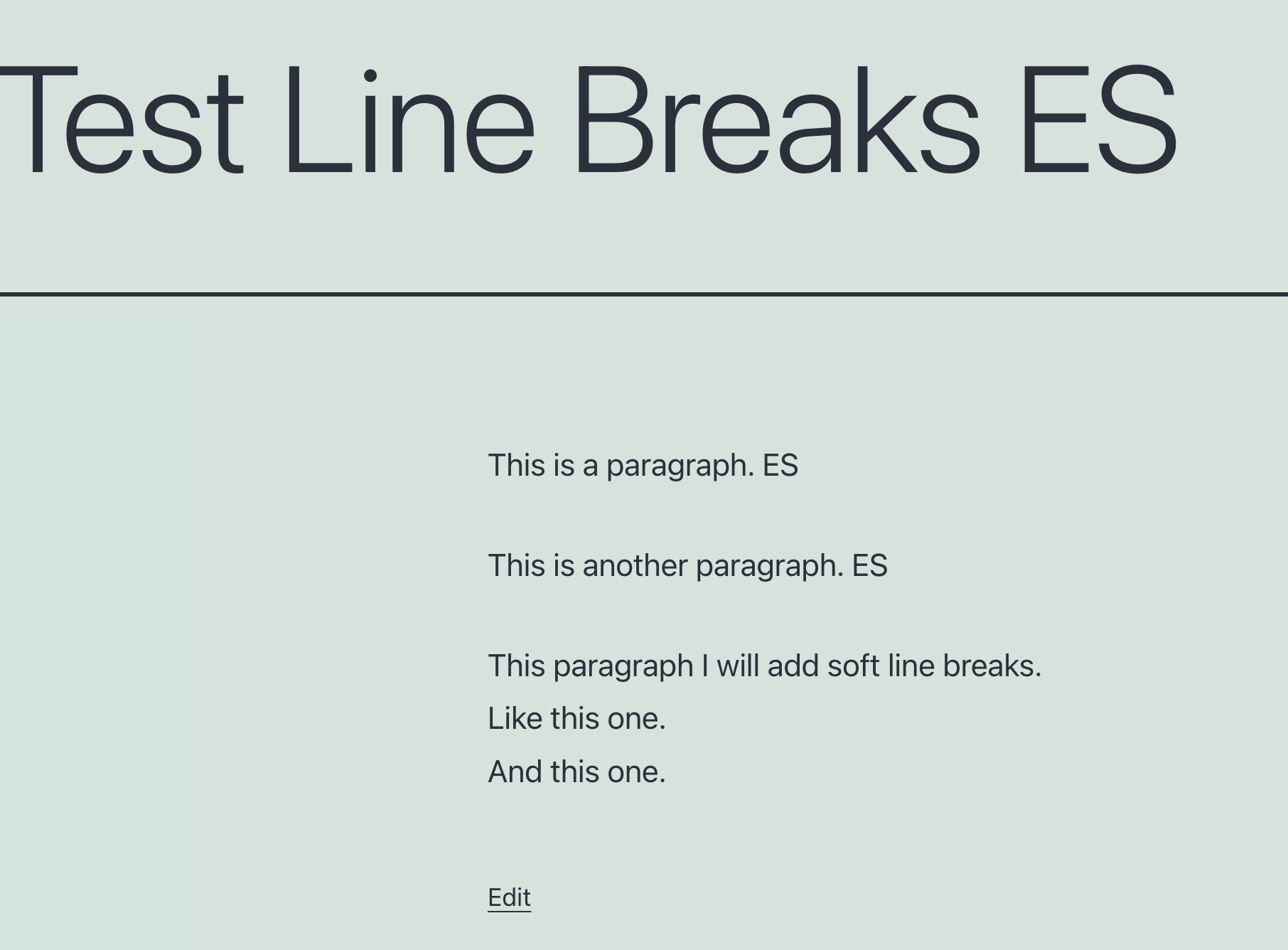

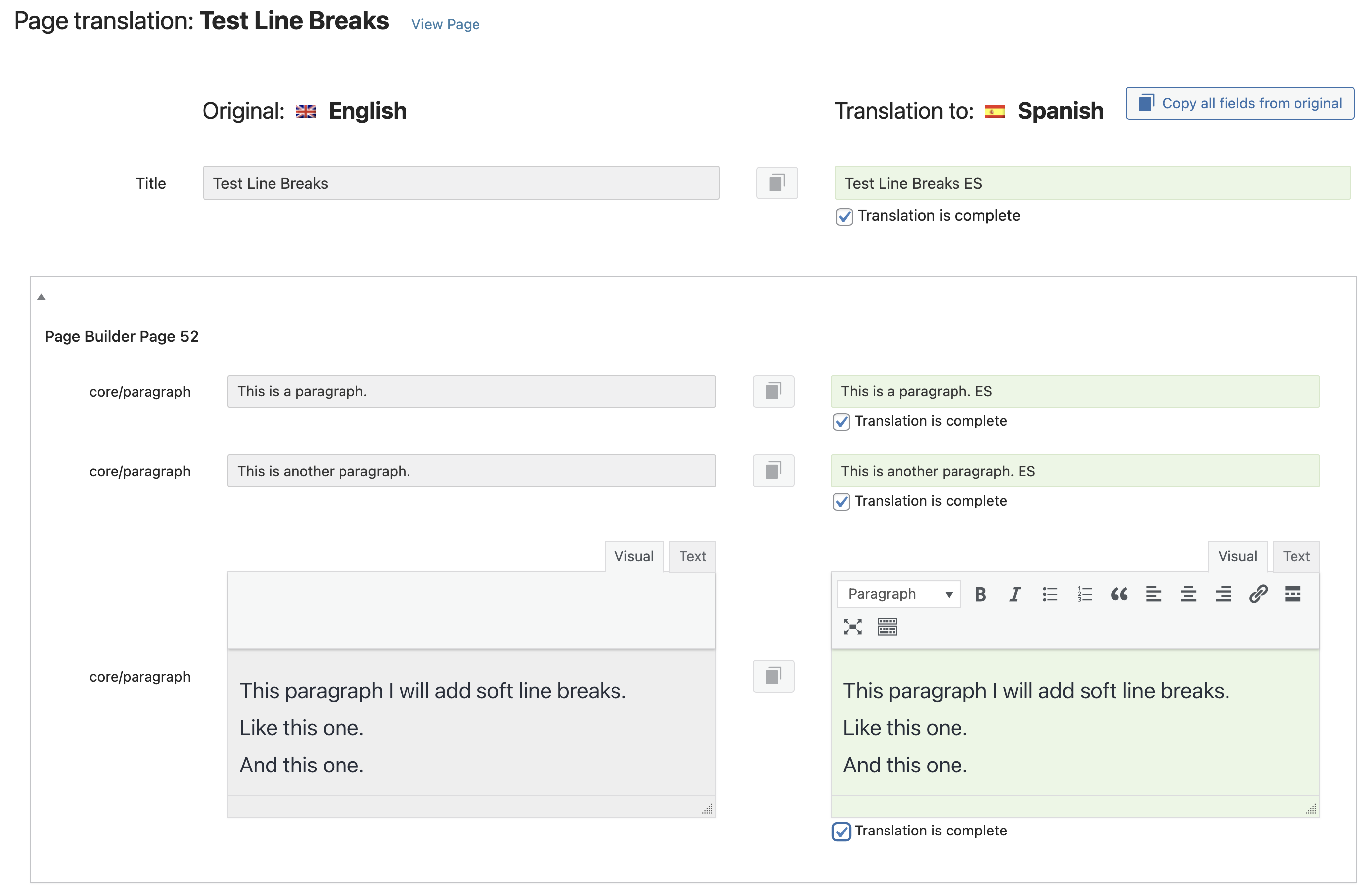

September 19, 2023 at 10:11 am #14418589
Nigel
Timezone: Europe/Madrid (GMT+01:00)
I just checked this on my own site and it works fine, so I created a sandbox site to double-check and to share with you.
You can see in the screenshots how I've copied across the content in the translation editor, and how it correctly displays on the front end.
You can test the same on the sandbox site, logging in with this link: hidden link

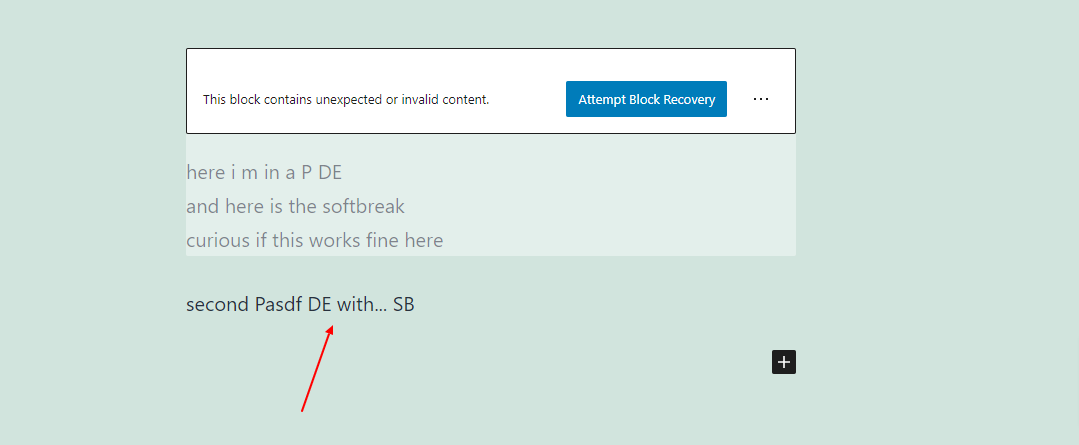

September 19, 2023 at 10:29 am #14418667
bart
thanks for the sandbox.
i have added a post and could reproduce the error.
what i did?
at first add post with title + 1 paragraf.
when translating, it works fine at the first look.
when i added the second paragraf, the troubles started. see attached screenshots
hope you can reproduce and see the problem too.

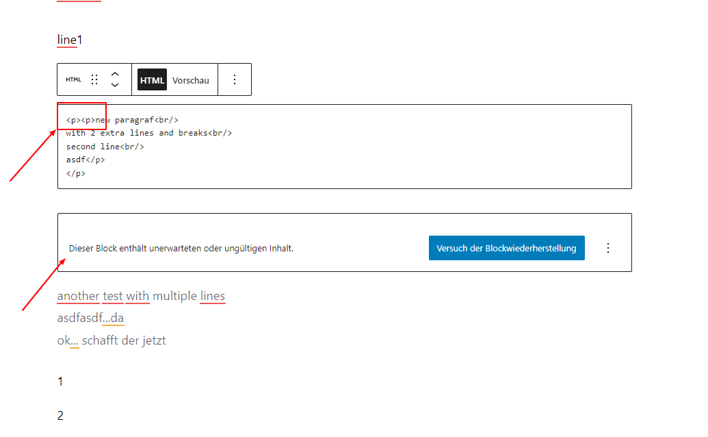

September 20, 2023 at 10:39 am #14429251
bart
I am already very grateful that this problem can be reproduced and a fix is on the way.
There is still 1 problem.
It wraps the content in a p-tag, even though there are already p-tags.
So the element gets a warning:
"This block contains unexpected or invalid content".
I guess this will be fixed in WPML 4.7, right?

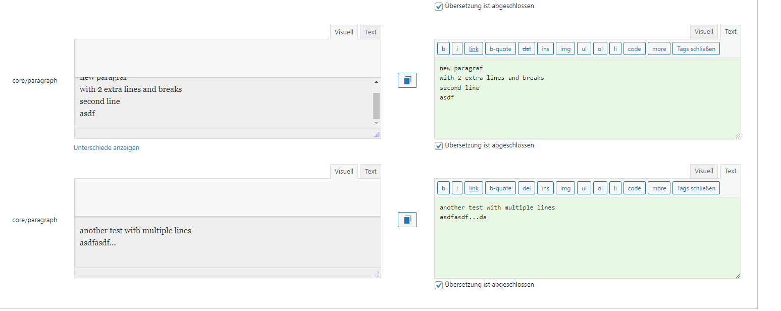

On the sandbox test site my colleague updated the workaround. He removed that which was added previously described above, and added this to the theme's functions.php instead:
add_action('wpml_st_string_translation_before_save', function($translation_data){
	if (! empty( $translation_data ) && isset($_REQUEST["action"]) && $_REQUEST["action"] == "wpml_save_job_ajax" && preg_match('/[\n\r]/', $translation_data["value"])) {
		$translation_data["value"] = wpautop($translation_data["value"]);
	return $translation_data;
What I then noticed while testing it is that it worked well if in the translation editor you are using the Text tab of the text editors, but it produced the double-paragraph problem if you used the Visual tab of the text editors, so I recommend using the Text tab.
