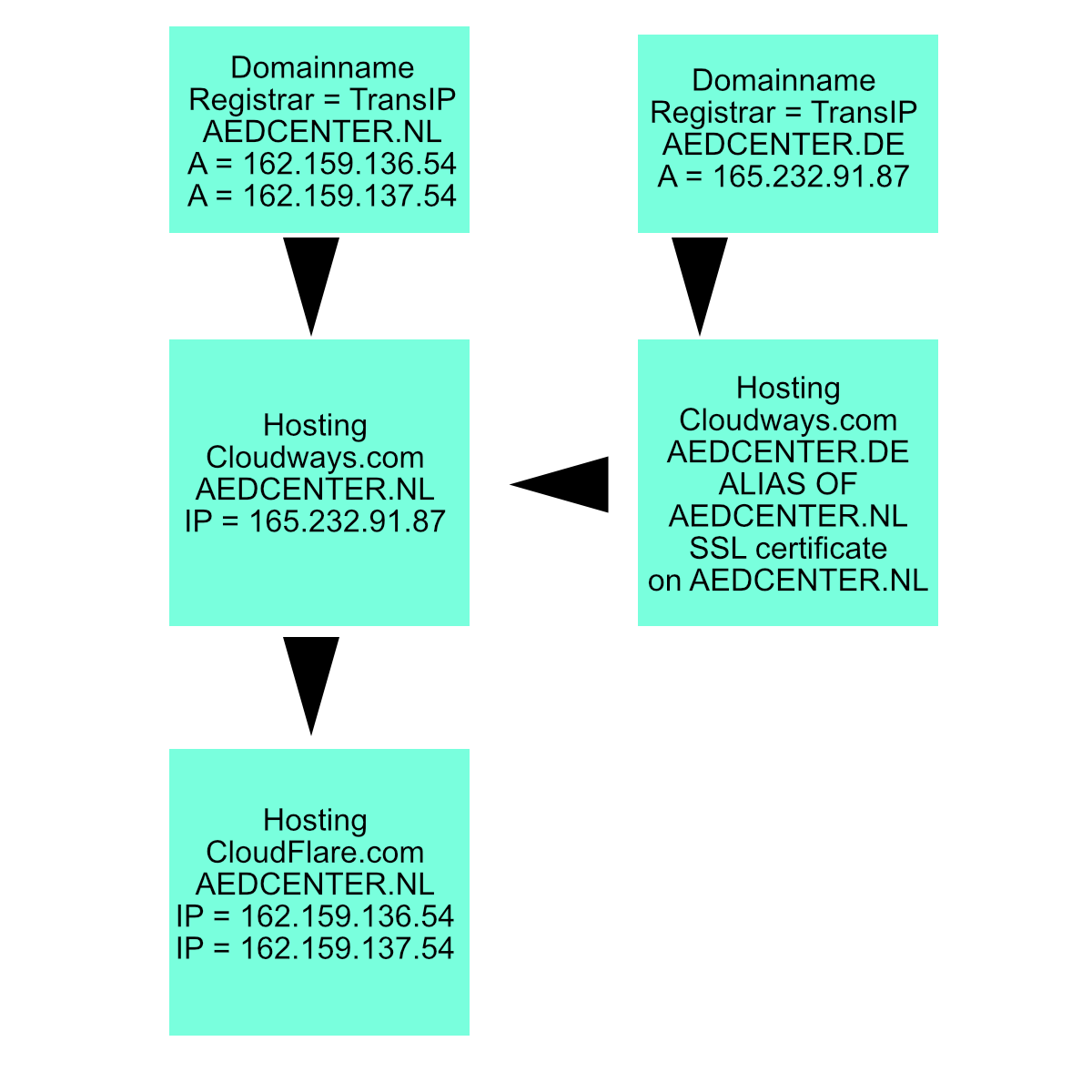

Here are all the details of my configuration: see screenshot
Thanks very much on beforehand,
Marc

I checked it and it looks like both domains are pointing to different IP addresses(this also aligns with the setup in the screenshot that you shared):
hidden link - 162.159.136.54 / 162.159.137.54
hidden link - 165.232.91.87
This won't work with WPML, the domains need to be pointing to the same IP as per our guidelines. And there could be no redirect from de DE domain to the NL one, they need to point to the same thing so that WPML can make the language switch work properly.
