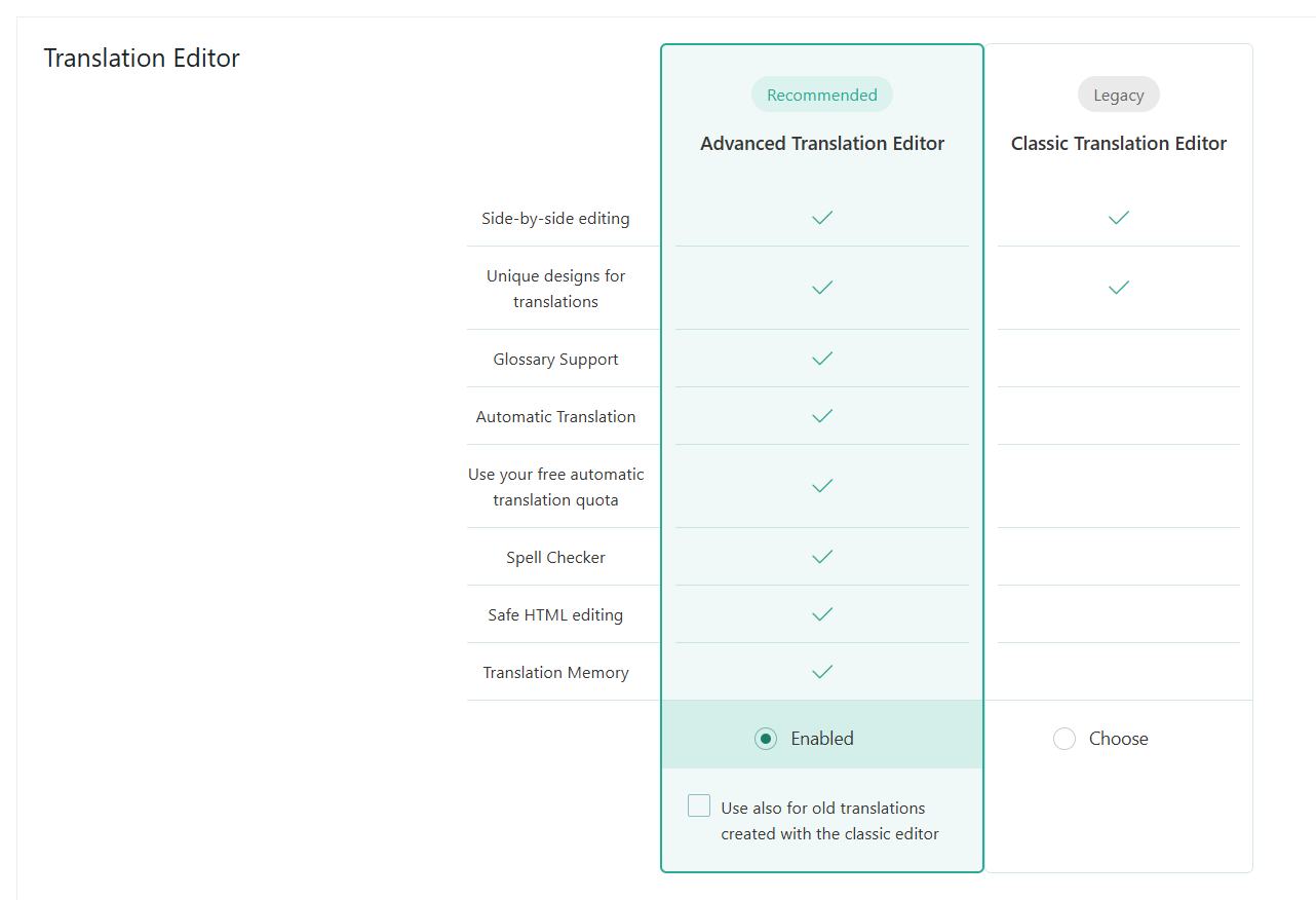

I go to Settings, click to go to Advanced. Then Click back to Classic. When I go to a edit page of a translation products I see this notice (uploaded image).

The translation method is set on each post and can be-
"WPML Translation Editor"
or
"WordPress Editor".
The notification that you mention is expected, on the original content, inside the right sidebar of the WordPress Editor the "WPML Translation Editor" is set as the translation method.
You should not edit translations on the WordPress Editor, while the "WPML Translation Editor" is set as the translation method on the original content.
What you see at WPML > Settings is to choose one of the two WPML Translation Editors:
Advanced Translation Editor:
https://wpml.org/documentation/translating-your-contents/advanced-translation-editor/
or
Classic Translation Editor:
https://wpml.org/documentation/translating-your-contents/using-the-translation-editor/
