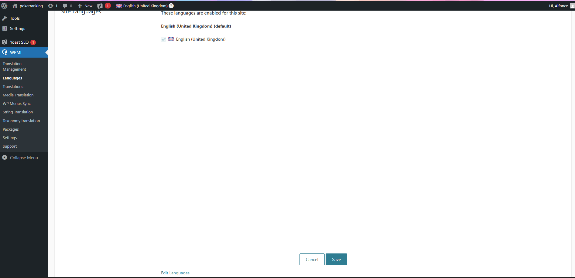

I am trying to add languages to my site using WPML. The site I need help with is hidden link.
WPML is not adding languages to the site, and languages are also not showing up.
Why is WPML not adding languages to my site?
Why are the languages not showing up on my site?

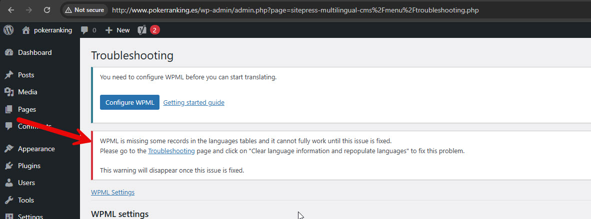

Our second-tier supporter noticed the following message in the backend.
WPML is missing some records in the languages tables and it cannot fully work until this issue is fixed.
Please go to the Troubleshooting page and click on "Clear language information and repopulate languages" to fix this problem.
This warning will disappear once this issue is fixed.
Please see the attached screenshot wpml-is-missing-records.jpg.

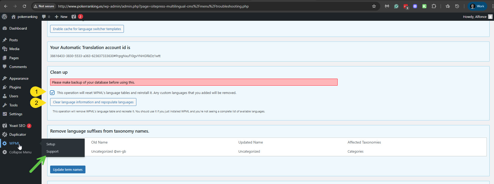

But when he tried the 'Clean up' option in WPML -> Support -> Troubleshooting, it didn't help to solve the problem. As we mentioned with the copy of your site on our local server, we could fix this issue by resetting WPML. Our second-tier supporter suspects that the user has no access to write data to the database.

After this, repeat the action that causes the problem on your site. Go to WPML -> Support -> Troubleshooting, and click the 'Clear language information and repopulate languages' button. Please see the attached screenshot, clean-up.jpg. The errors will be saved to a debug.log log file inside the /wp-content/ directory. Then, please share the errors with us.
