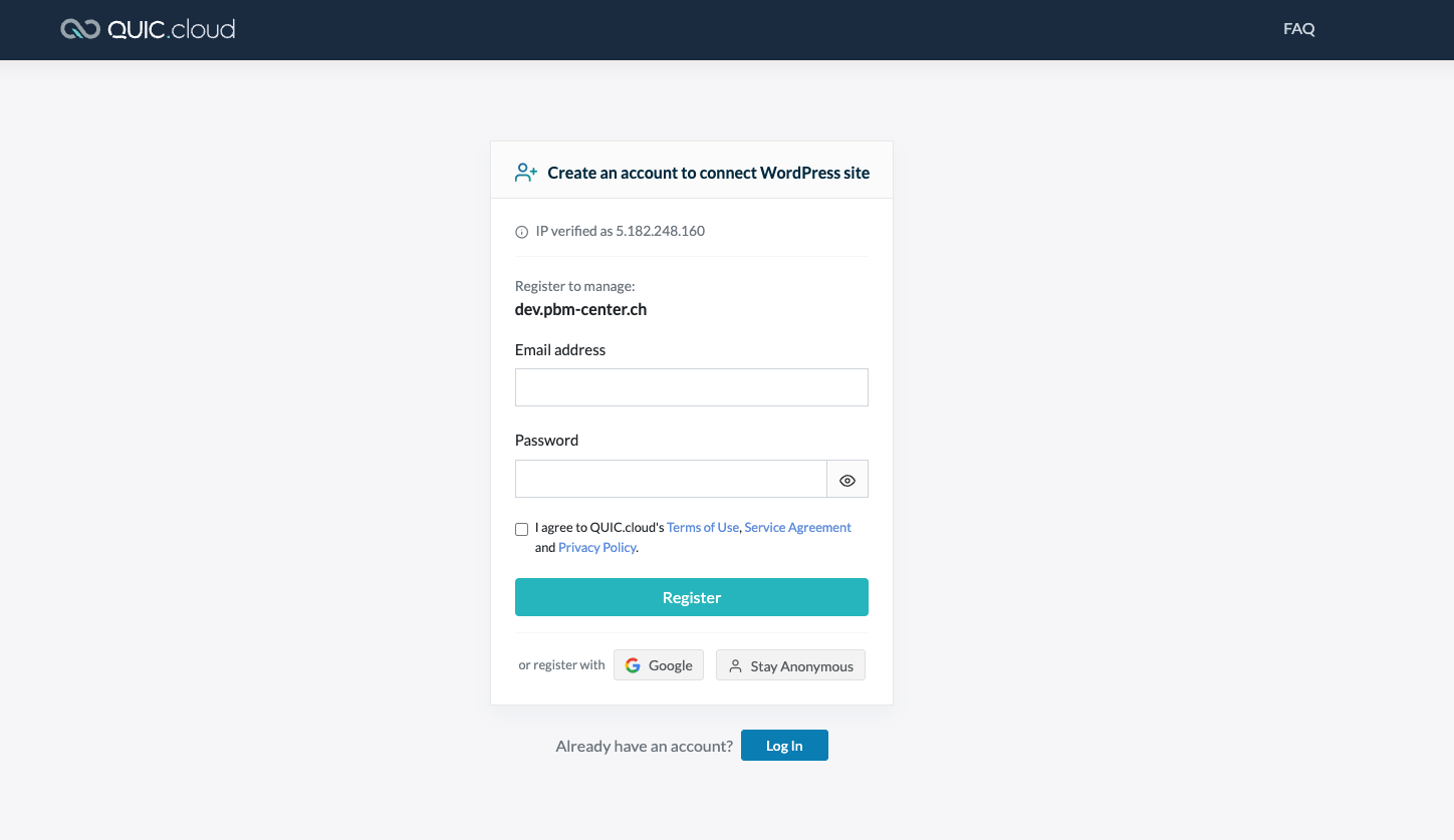

December 3, 2025 at 1:13 pm #17630926
philippeB-68
Hi Carlos,
Thanks for your tests.
Indeed, you need to resave the permalink after having de-activated WPML and you will see that you will reach the QUIC serveur.
It seems that WPML is blocking a redirect that the Litespeed extension is doing to connect.
To activate, QUIC cloud server do a verification on the following URL:
This request is redirected to hidden link by WPML :
< x-redirect-by: WPML
< location: hidden link
The server then respond with a 404 :
152.53.38.14 - - [20/Nov/2025:14:50:43 +0100] "GET /?rest_route=%2Flitespeed%2Fv3%2Fwp_rest_echo HTTP/1.1" 404 149 "hidden link" "QUIC cloud bot/1.0"
The root problem is that WPML is doing a redirect while it should not.
If you start again from the existing state of dev.pbm-center.ch, you can go to the litespeed plugin and click on activate. You will see the screen attached. Go back and activate WPML and you will see the error message if you try to do the same activation.
Thanks,
Philippe
