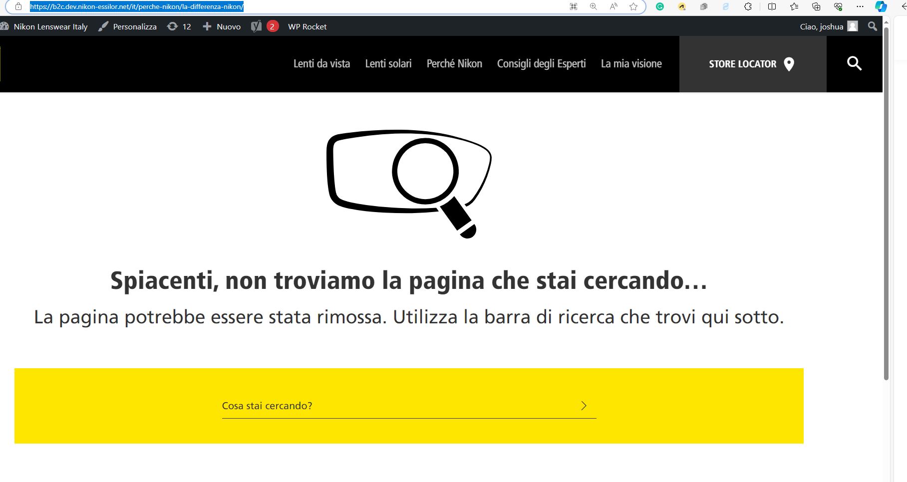

I would like you to investigate the problem we've been encountering with your plugin. Specifically, it's related to the pages not displaying, especially when it comes to the translated versions in Italian.
As an example, you can visit the following link: hidden link It shows that the page cannot be found. However, the post pages are functioning correctly, as shown in this link: hidden link

Hello Christopher, I appreciate your guidance on setting up the link associated with our account. The team has already taken care of that, so let's now revisit the main issue we encountered with three different domains: German, Indonesian, and...
For instance, when visiting this link: hidden link, an error message appears indicating that the page cannot be found. However, the post pages are functioning correctly, as demonstrated in this link: hidden link.

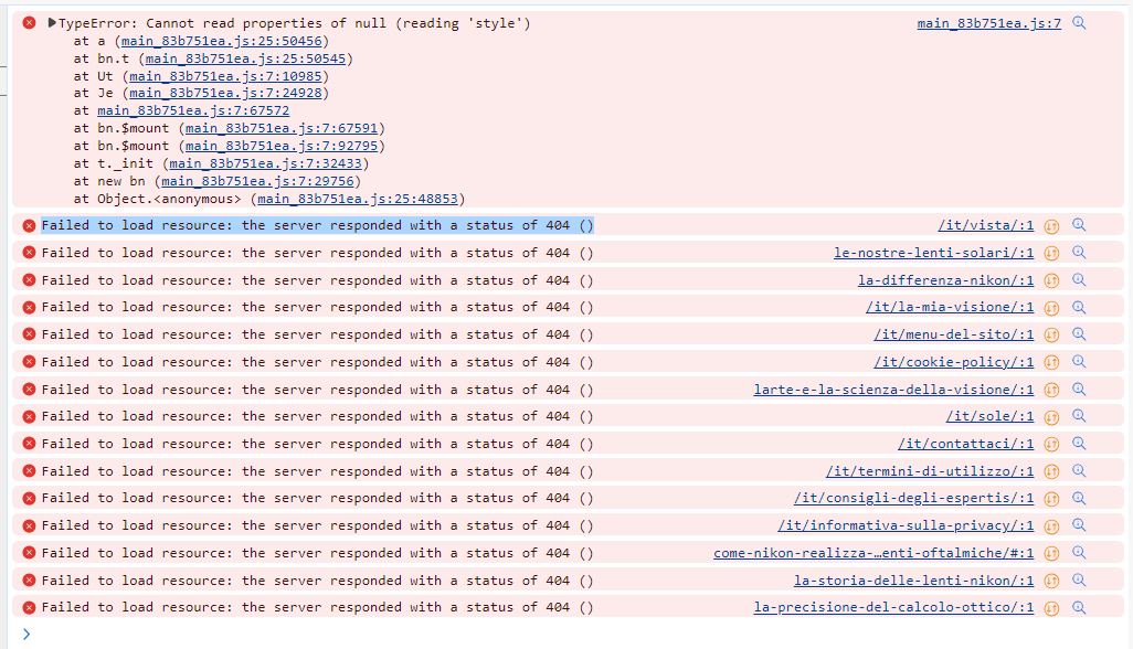

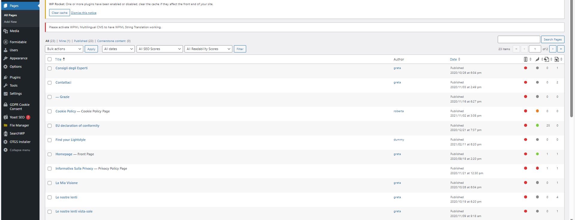

Hello Long Nguyen, Thank you for providing instruction. I would like to discuss with you the in-depth analysis of this matter. Previously, we utilized WPML to translate the slugs, and despite attempting to synchronize all pages, particularly those in Italy, we are still facing an issue. When attempting to access the page, an error is displayed: "Failed to load resource: the server responded with a status of 404." The slugs have been translated into Italian, whereas they were originally in English. We suspect that the problem lies with WPML, but even after deactivating and reactivating it, the issue persists. When switching to Italian pages, the pages cannot be found. This issue arose despite updating WPML, which was previously outdated
I've attached also the screenshot of the wordpress pages where all of the pages in italian translation slug page area are not working
