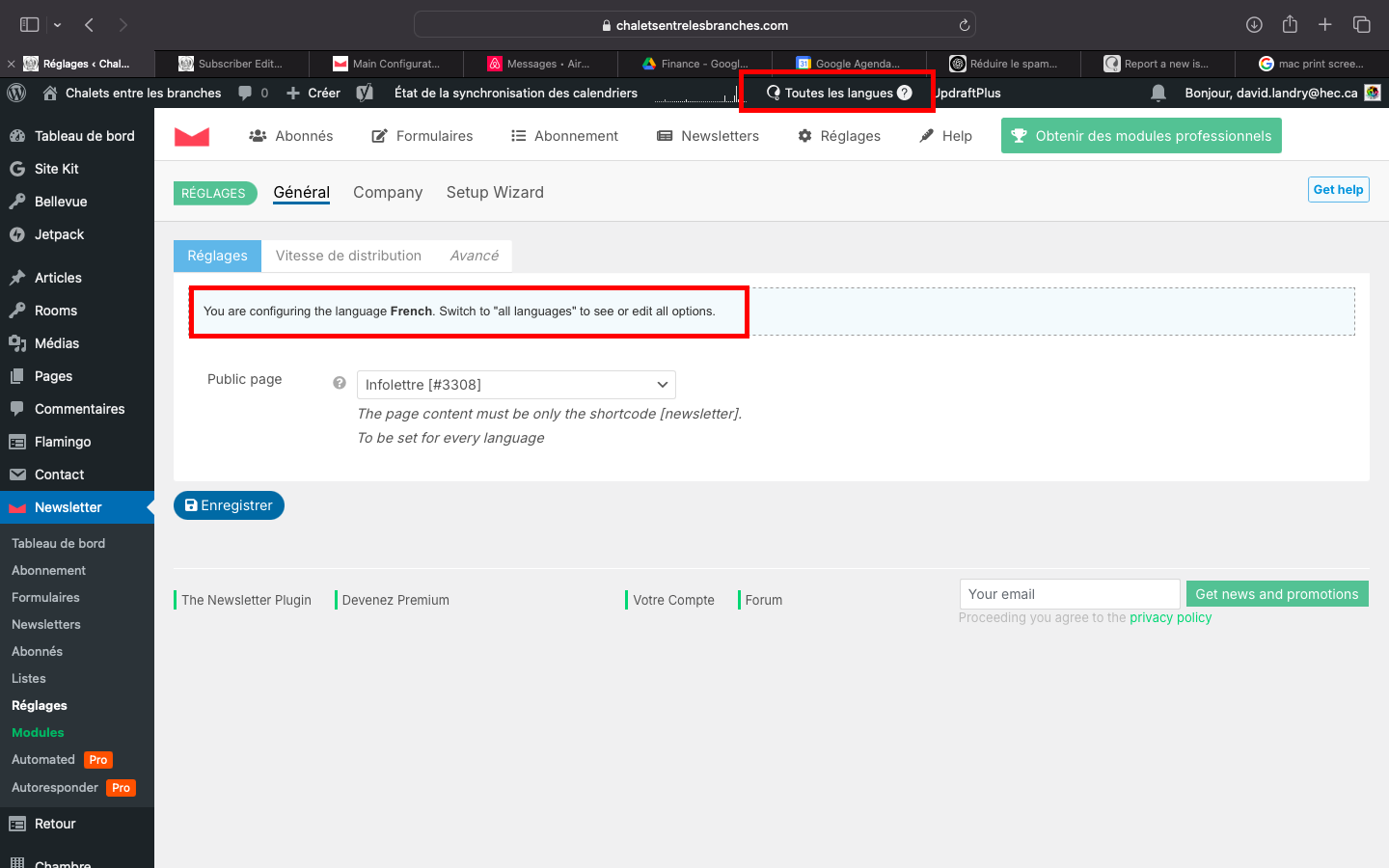

I just installed The newsletter plugins and tried using the admin language switcher. I expected to translate a page and access other translations to translate the newsletter.
When using the admin language switcher, nothing happens. The page changes, but the plugin still indicates I'm in my main language. I'm stuck on the main language even if the URL points to the other language or all languages.
Why does the admin language switcher not change the language as expected?
How can I access other translations to translate the newsletter?

I can see the issue on your screenshot. I will need to closely examine your website. Therefore, I will require temporary access (WP-Admin and FTP) to a test site where the problem has been replicated, if possible. This will enable me to provide better assistance and determine if any configurations need to be modified.

Thanks for your reply. I've enabled the "Set the administration language as the editing language." option in the profile settings here hidden link and now I'm able to switch between languages using the language switcher.
Could you give this a try?
April 30, 2025 at 12:31 am #16981416
davidL-209
Great, it's working now. Thanks !
