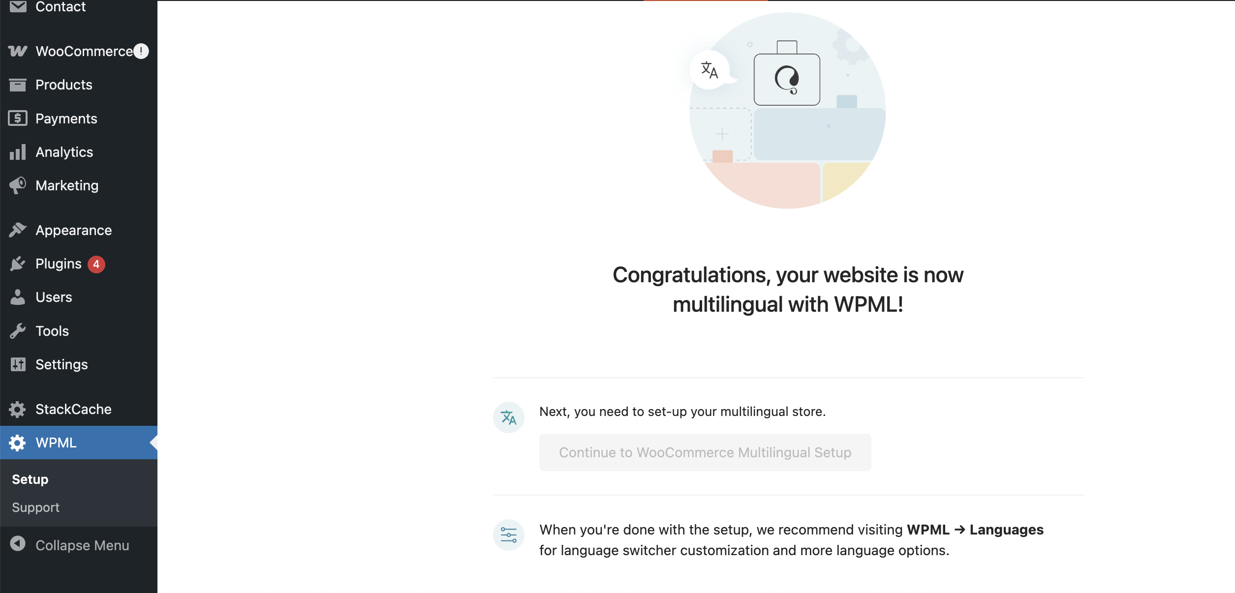

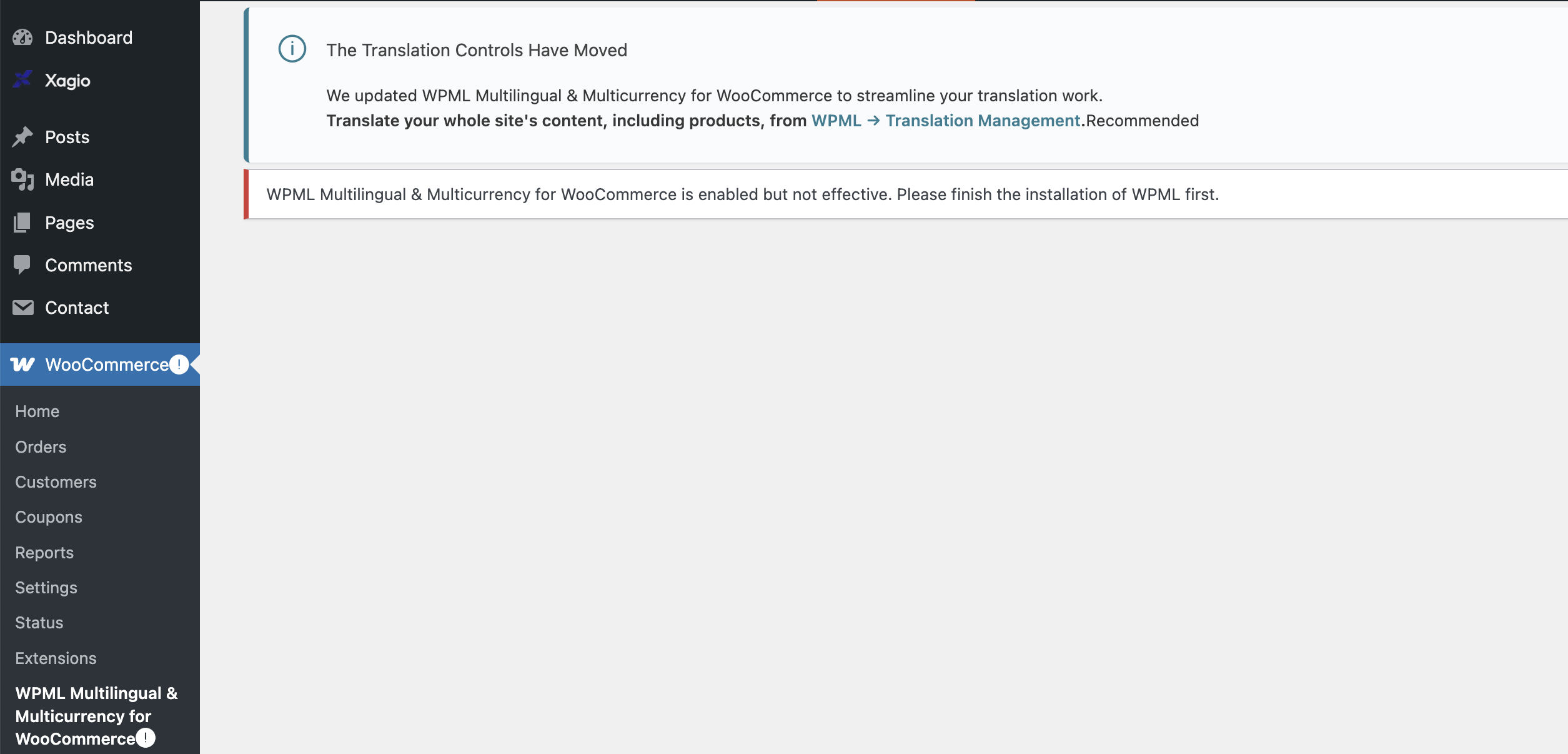

Now, please try to complete the Setup Wizard at WooCommerce > WCML and let us know if further assistance will be required.

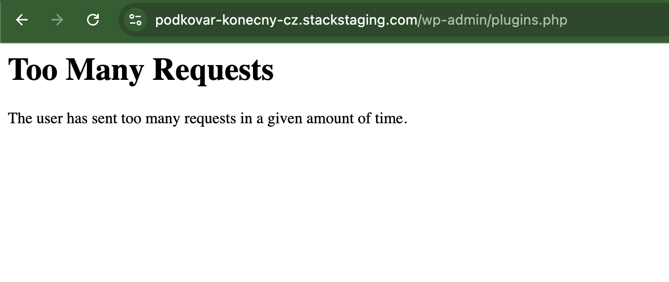

Thank you for the login information. Whenever I go to the WordPress Dashboard, I see the TOO MANY REQUESTS error.
Would you please contact the hosting service provider and ask them why that is?

Unfortunately that made it worse - it still didn't work when I turned woocommerce back on, and kept turning the theme off. As I had to launch today, I ended up rebuilding with a different plugin overnight, so can I please have a refund for this site, or have it removed from my account so I can use it on another site?
