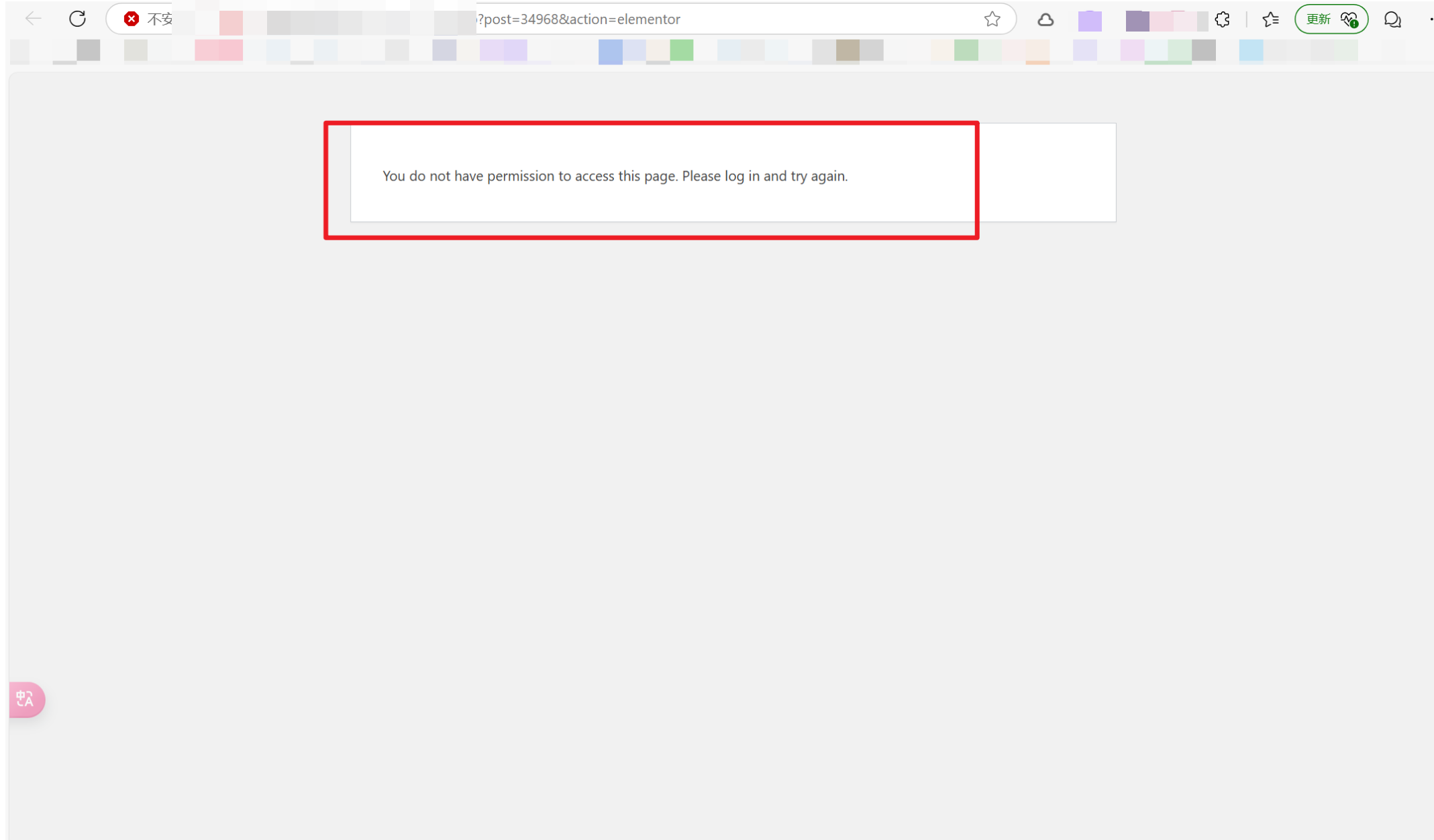

谢谢,我已经设置好了两个域名,并且翻译后的域名可以正常访问了。但是我没有办法在后台使用elementor编辑翻译后的页面😭,请问这是怎么回事呀?
April 22, 2025 at 9:45 am #16954129
Carlos Rojas
WPML Supporter since 03/2017
Could you please try the following steps?
1- Go to WPML-> Languages, and enable the "Auto sign-in and sign-out users" option
2- Go to Settings-> Permalinks, and resave the settings
3- Log out from your site's dashboard
4- Log in again, clear the site's coach,e and check the issue
Kindly let me know if the above steps helped you fix the issue.
April 22, 2025 at 11:37 am #16955005
mtcM
这个方法很管用,现在可以编辑了,非常感谢!
