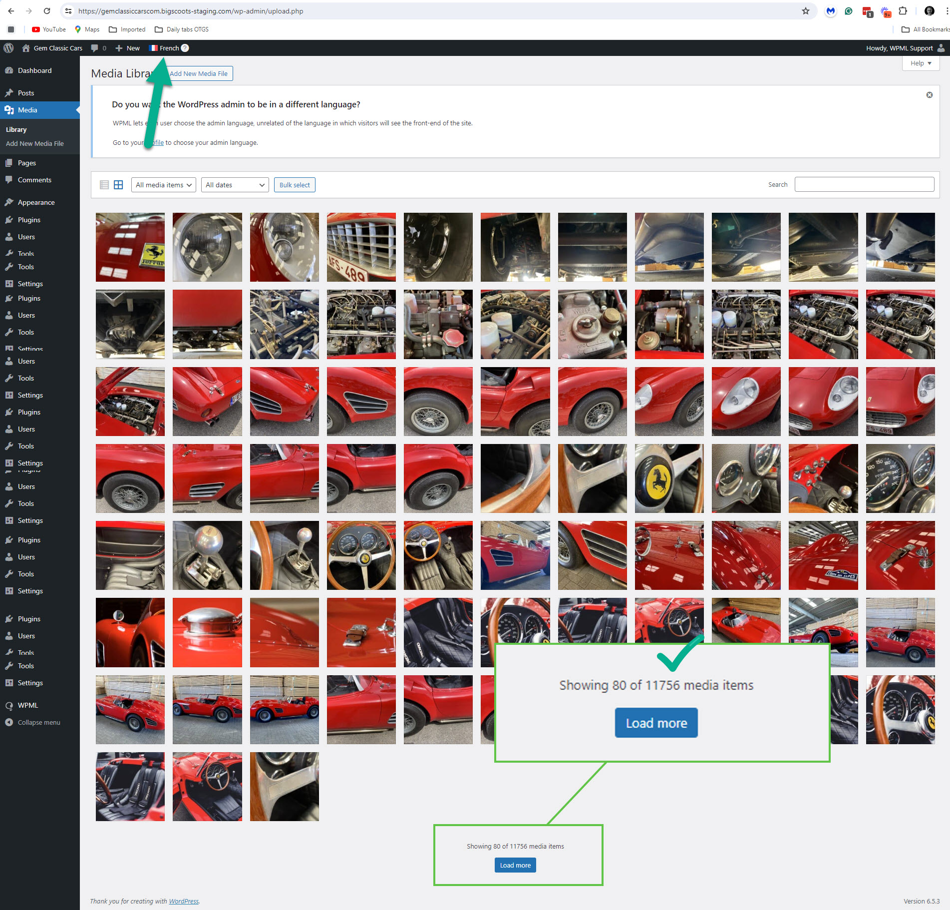

When I go to Media -> Library, I can see 11756 images in English. When I switch to French or any other language, I see the same number - 11756 images. Please see the attached screenshot. It seems the duplication process was completed successfully.
Have you tried to activate the theme and the third-party plugins to check if it solved the issue?
Itamar.
