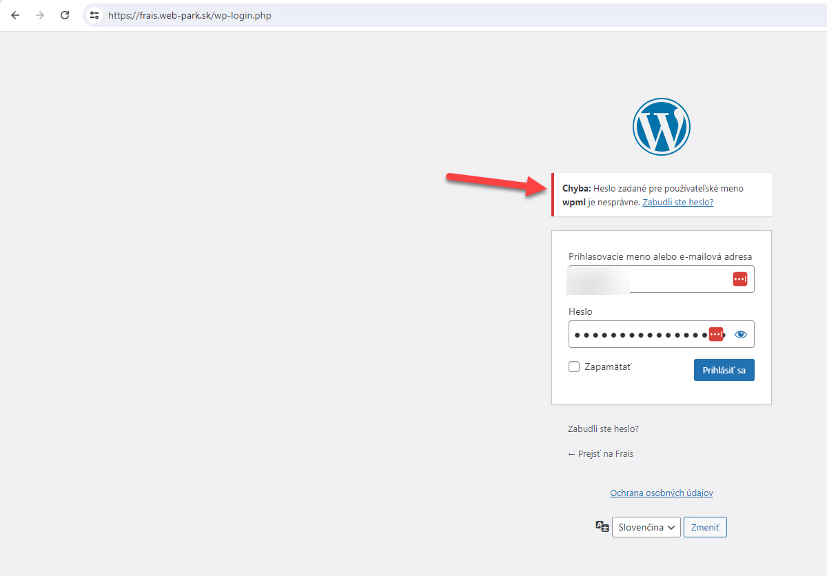

I get the following message when I try to access your site.
Chyba: Heslo zadané pre používateľské meno wpml je nesprávne.
Please see the attached screenshot.
Please fix this and let me know once I can reaccess your site.

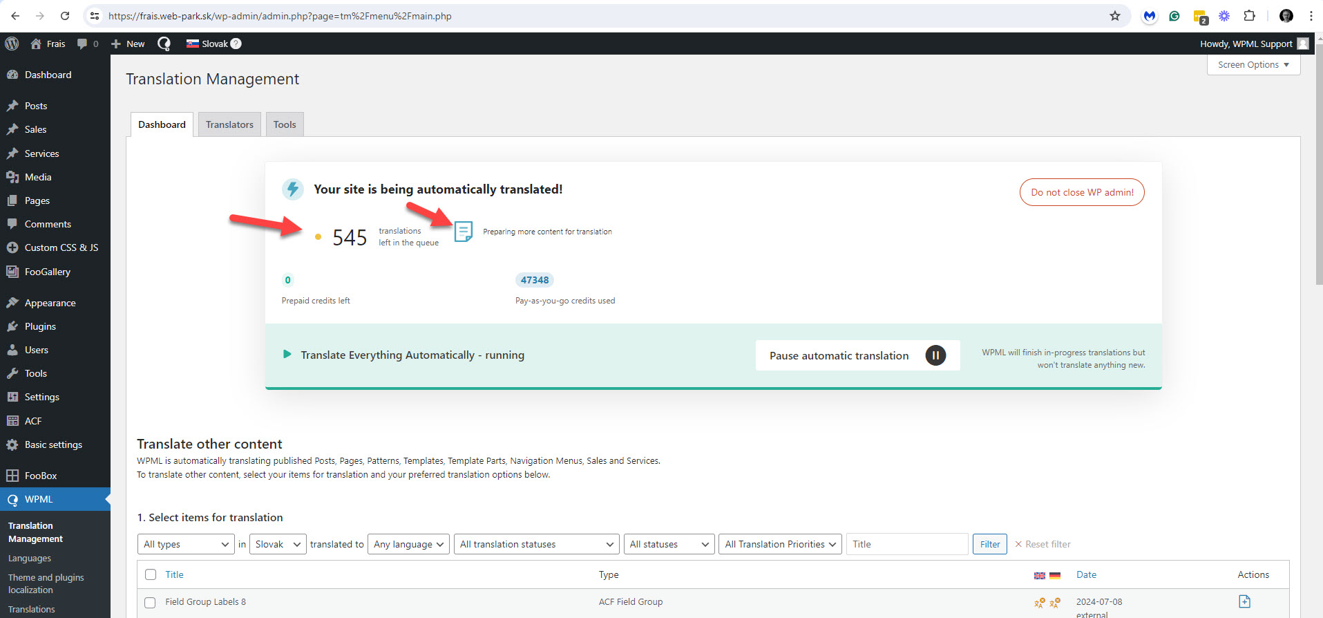

It looks like the automatic translation is stuck again. Please see the attached screenshot.
I'm consulting our second-tier supporters about this case. I'll update you here once I have news from our second-tier supporters.

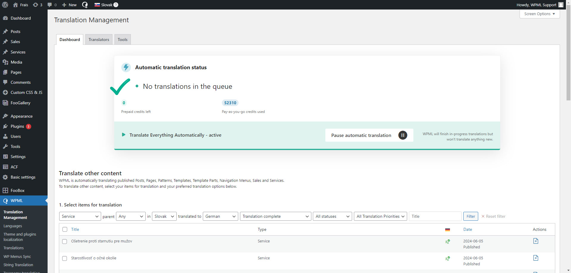

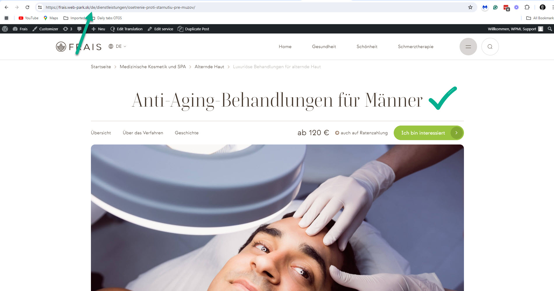

I installed the WP phpMyAdmin plugin, but then I noticed that all the Services posts are translated into German. For example the Ošetrenie proti starnutiu pre mužov service.
I also noticed that in WPML -> Translation Management, nothing is stuck. Please see the attached screenshot.
As far as I can see, the problem is solved now.
