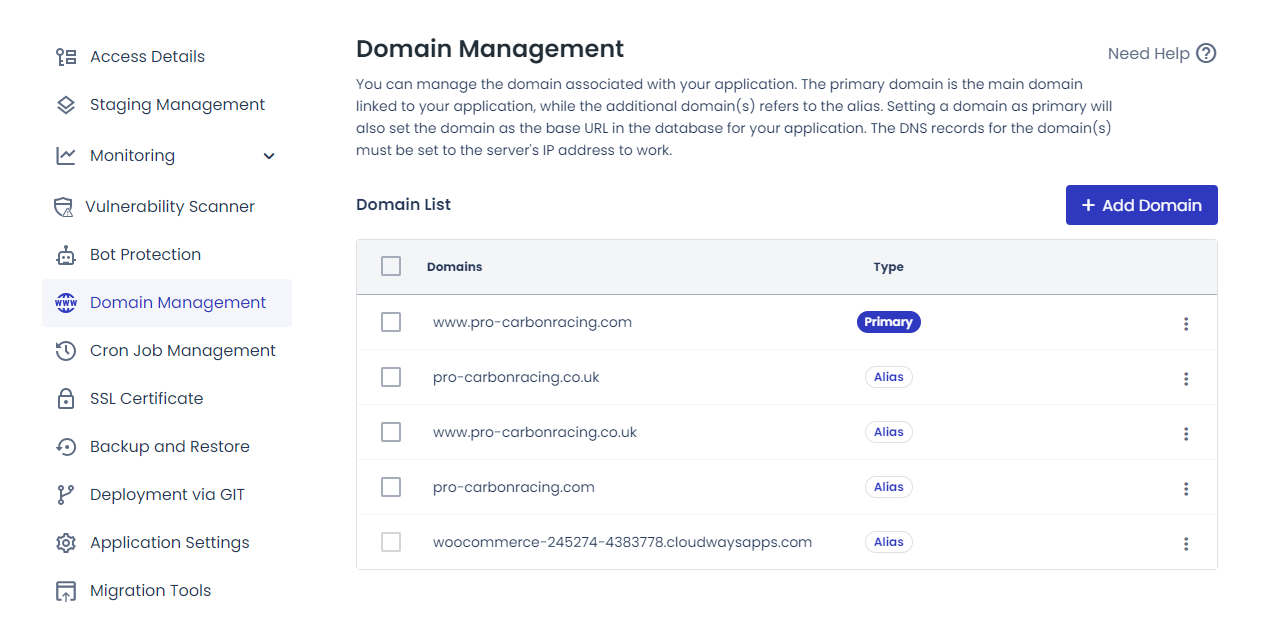

March 13, 2024 at 8:54 am #15402528
zakW
Hi Bigul
1) The steps that I took to change the domain were.
After creating the clone of the website I deleted from the old version the domain records and on the clone version I added the domain records on it. The domain records are as follows:
hidden link - Primary
pro-carbonracing.co.uk - Alias
hidden link - Alias
pro-carbonracing.com - Alias
The old website now without those 4 records has no problem and the clone website (now the new live website) has problems. Before adding the records the problem was not showing.
2) yes we have
Have you been able to replicate the problem in your staging local site?
Ruben

March 13, 2024 at 1:06 pm #15404078
zakW
Hi Bigul,
Sorry if I explained this incorrectly.
The problem only happened when I changed the domain information from the original site to the cloned version. Both websites are in the same private server so no need to change any DNS information just changing the domain name to go from one application to another.
I added a screenshot of the domain records I am talking about
We have the website hosted with Cloudways on 4GB of RAM. We have no details on the processor.
Ruben
