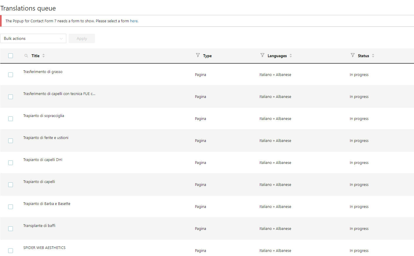

I am trying to automatically translate new pages from the default language (Italian) to Albanian on my site hidden link. I have followed the instructions provided in this documentation: https://wpml.org/faq/translation-status-stuck-or-displaying-the-error-wpml-didnt-manage-to-translate-this-page/
Translations will stay 'in progress' status, even if the translations have been made. This hasn't happened when I translate from Italian to English version. The progress bar is 100%.
Why are my translations from Italian to Albanian stuck in 'in progress' status?
How can I resolve the issue of translations being stuck even when the progress bar is at 100%?

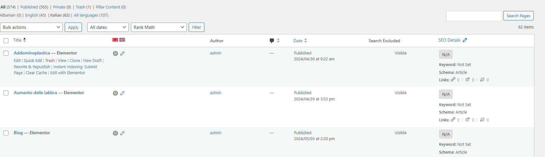

I can see that the backup also contained the issue with duplicated pages, more than a thousand pages were in the trash.
- I emptied the trash but there were more than a thousand pages still under "published" but they weren't assigned to any language.
- I ran a troubleshooting option to set language information and now they're all under Italian.
- I'm not sure the issue is linked to WPML because those pages weren't assigned to any language (exactly how it is when WPML is not installed).
I'll try to get rid of those duplicates and see if sending the pages back to translation resolves the issue or if it actually generates more duplicates. I'll get back to you in a moment.
July 2, 2024 at 5:30 pm #15877389
Nicolas V.
Languages: English (English ) French (Français )
Hello again,
- I cleaned up and deleted all duplicated pages.
- I re-ran the troubleshooting option to make sure that all pages had a language set
- Then opened the Albanian translation for one of the page and completed it
Result: your pages got duplicated again, you have now 275 pages in Italian.

Hello, yes i can see those pages created automatically when we try to fix something in WPML, those pages dont have content only blank pages with title.

I was able to find the culprit by testing the site in minimal setup.
- Disable any additional plugin that is not related to WPML and its add-ons and switch to a default theme like 2020.
- I reactivated your theme (that was not the issue)
- Then I started reactivating the plugins in small groups of 4. This way I was able to identify the plugin that is causing the issue: "WPB Popup for Contact Form 7"
Here is a video in two part where I explain the testing process:
1: hidden link
2: hidden link
This plugin is not listed as compatible: https://wpml.org/plugin/?wpv_view_count=120064&wpv-plugin-functionality=0&wpv_post_search=WPB+Popup+for+Contact+Form+7&wpv-wpcf-recommendation-flag=&wpv_filter_submit=Search
I would invite you to contact the author of this plugin and report that issue: https://wordpress.org/plugins/wpb-popup-for-contact-form-7/
If they need help they can reach us by joining our Go Global program here: https://wpml.org/documentation/support/go-global-program/
I'm not sure that our second tier team will be able to provide a solution here. But I will still escalate your ticket and let you know as soon as I have their feedback.
For the time being I would recommend you to disable this plugin and look for an alternative.
